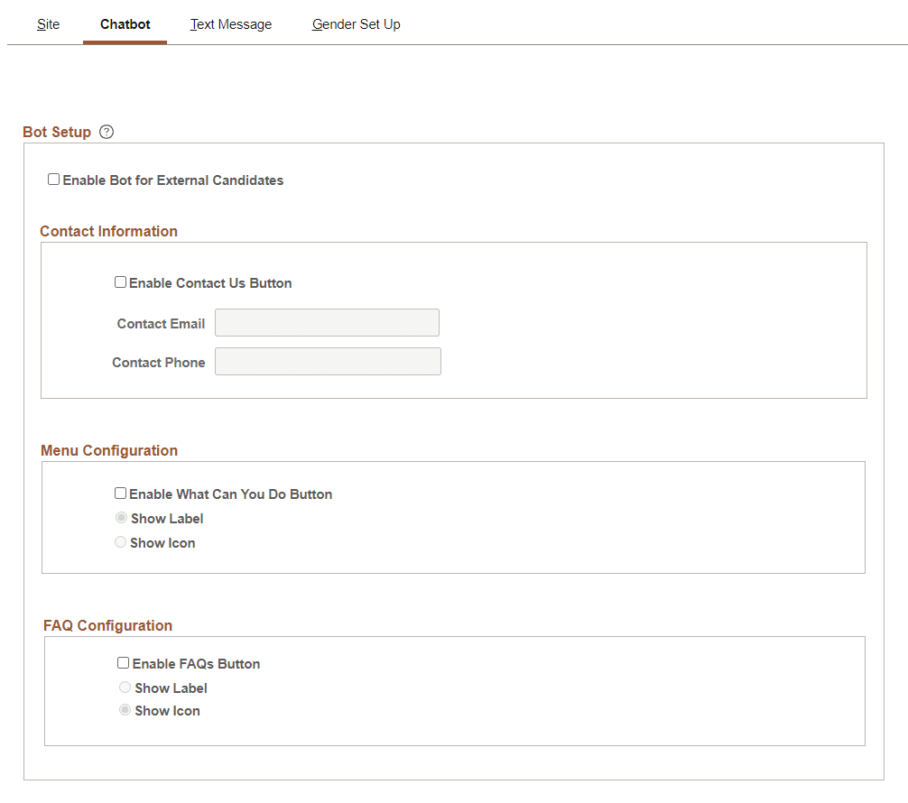

Chatbot Page
HRS_SITE_BOT_SETUP
Configure and enable Recruiting Solutions Assistant chatbot.

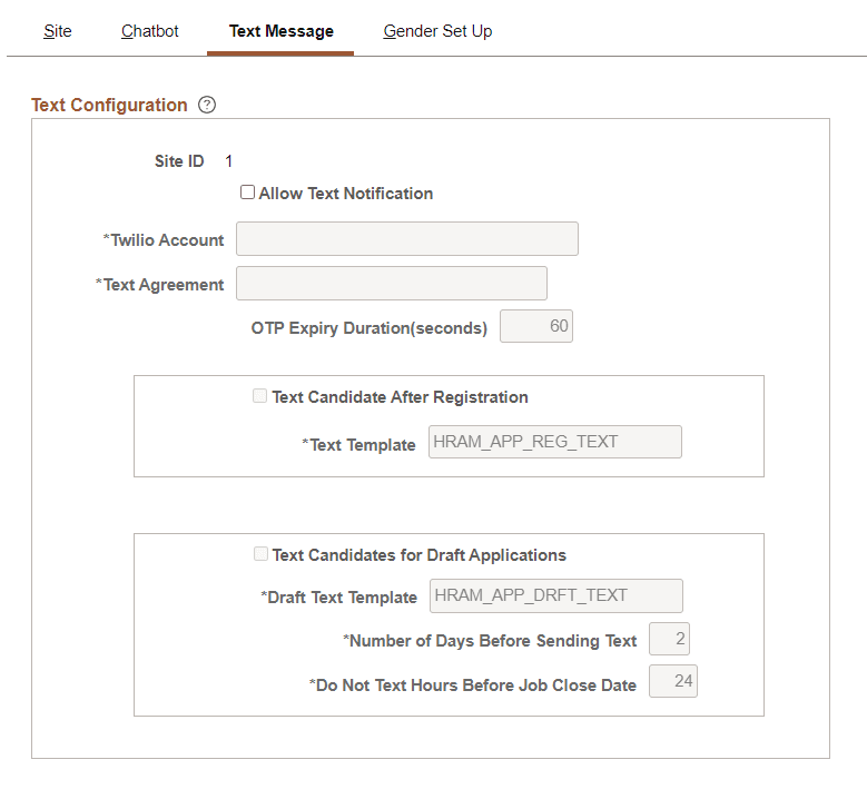

Text Message Page
HRS_SITE_TEXT
Configure and enable text messages.

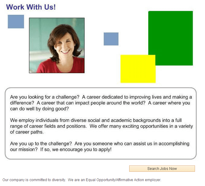

Edit Welcome Page
HRS_WELCOME_ED
Create content for the Classic Candidate Gateway welcome page.

Recruiting Digital Assistant
The Recruiting Digital Assistant is available as a floating button on External Candidate Gateway Explore Jobs pages. Click the button to open the chat window. Applicants may begin interacting with the chatbot via a simple greeting, or start directly with a question in a conversational way.
From PUM Image 53, the existing Careers page has been renamed to Explore Jobs. If you are looking for the Careers page, please navigate to the Explore Jobs Page instead.
You need to configure the Chatbot Page at site setup to enable Recruiting Digital Assistant.
For more information, see Understanding Recruiting Digital Assistant.

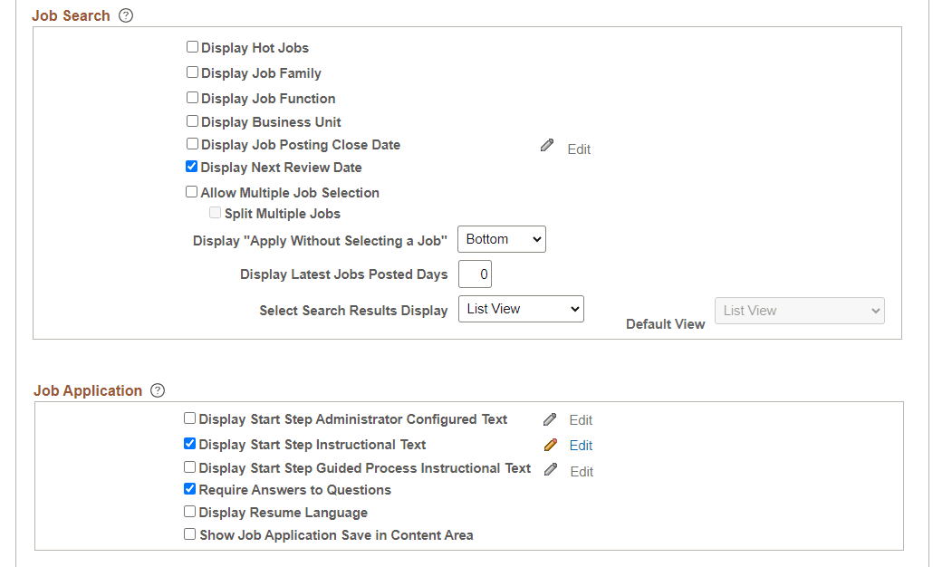

Site Setup Page
Use the Site page (HRS_SITE_ID) to set up site definitions.
Navigation:
Set Up HCM, and then Product Related, and then Recruiting, and then Candidate Gateway, and then Site Set Up

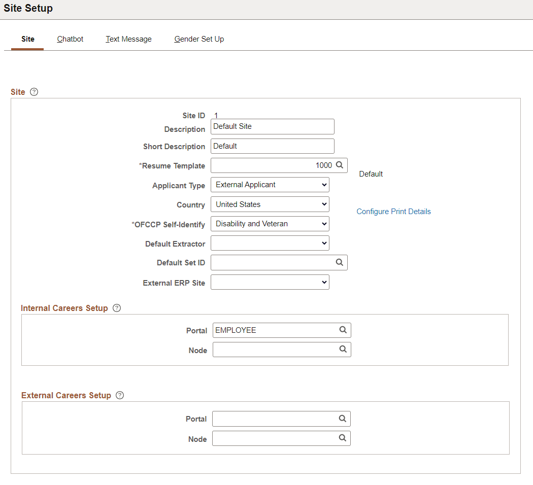

This image is the first of four examples illustrating the Site Setup page.
Site Page (1 of 4) of Site Set Up
This image is the second of four examples illustrating the Site Set Up page.
Site Page (2 of 4) of Site Set Up
This image is the third of four examples illustrating the Site Set Up page.
Site Page (3 of 4) of Site Set Up

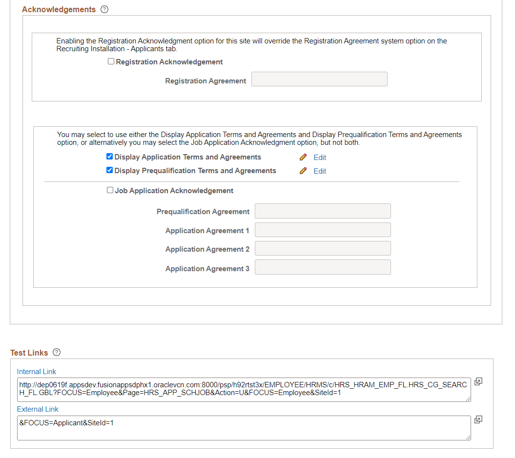

This image is the fourth of four examples illustrating the Site Set Up page.
Site Page (4 of 4) of Site Set Up
Site
Field or Control Description
Site ID
Displays the unique identifier for the site definition. This is used as a parameter on the URL to direct users to the correct site.
Resume Template
Select the default resume template for the site. If an applicant applies without a job opening, or if an applicant applies for a job opening that is not associated with a resume template, the system uses the default resume template to control the application process.
Applicant Type
This field is informational only. Select Employee, External Applicant, or Non-Employee to indicate which type of applicant uses this site.
This setting does not control the applicant type that is assigned to applicants who submit applications on this site; that value is determined by the navigation used by the applicant. For example, if an applicant accesses the site using an external link, the applicant is created as an external applicant.
Country
Select the default country for the site. The selected country controls the following:
  • The default name format for applicants.
  • The default country for applicant addresses.
The default country is also supplied to your resume extractor if the resume extractor requires country information for formatting names and addresses.

Default Extractor
Select a default resume extractor. The system uses the resume extractor that you specify here to extract information from applicant's resumes. If you do not select a value, applicants can attach resumes but the system cannot extract information from the resumes.
Default SetID
Select the setID that controls the values for the Location field in the Preferences section of an application without a job opening. (Applications with a job opening use the business unit of the job opening to determine the appropriate setID.)
External ERP Site (external employee referral program site)
Use this field to match internal and external sites so that Email to Friend and Refer a Friend notifications that are triggered in the current site have the correct links for both internal and external applicants. These notifications include two links because the system cannot know whether the recipient is internal or external.
To build the external link for a notification that is triggered by an internal applicant:
  • If an External ERP Site is specified, and its configuration includes an external portal and node, the system uses that portal and node and site ID.
  • If an External ERP Site is specified, but its configuration does not include a portal and node, then the system uses the current site’s external portal and node along with the External ERP Site’s site ID.
  • If the External ERP Site field is blank, the current site’s external portal and node and site ID are used.
To build the internal link for a notification that is triggered by an external applicant, the system checks whether the current site is the External ERP Site for any other sites:
  • If the current site is not the External ERP Site for any other sites, the system uses the current site’s internal portal, node, and site ID to build the internal link.
  • If the current site is the External ERP Site for one other site, then the system uses the other site’s internal portal and node and site ID to build the internal link.
  • If the current site is the External ERP Site for multiple other site, then the system uses any one of the other sites for the portal and node and site ID in the internal link, giving preference to a site where the job posting in question has been posted.
    Note: Except for this preference, the system does not validate that the emailed or referred job is posted to a particular internal or external site. For example, if an employee emails a job to a non-employee, but the job is not posted to any external sites, the link that is supposed to go to the posting on the external site will not work.
Notice that this field is not used to build the external link in notifications triggered by external applicants, nor is it used for the internal link in notifications triggered by internal applicants. Instead:
  • When an external applicant uses Email to Friend, the external link is built using the current portal, node, and site.
  • When an internal applicant uses Email to Friend or Refer a Friend, the internal link is built using the current portal, node, and site.
Internal and External Explore Jobs Setup
Use these fields to ensure that links within applicant notifications are correctly constructed for access to internal and external sites.
Notifications sent by the Email to Friend and Refer a Friend processes use the External ERP Site field to determine which site’s link configuration settings are used to build internal and external links.
Internal Careers Setup
The system uses the portal and node that you specify here to build links to this site for internal applicants. If you do not specify a portal and node, then the user’s current portal and node are used.
External Careers Setup
The system uses the portal and node that you specify here to build links to this site for external applicants. If you do not specify a portal and node, then the user’s current portal and node are used.

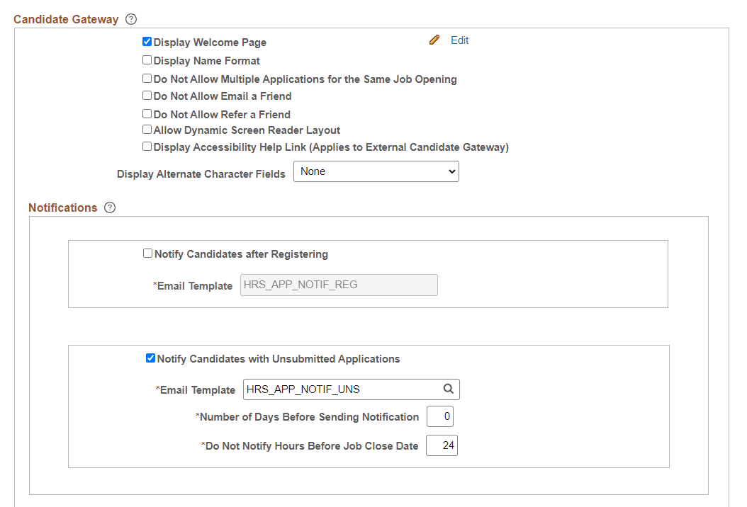

Display Welcome Page
Select this check box to have Classic Candidate Gateway display a welcome page when external users navigate to the site. The welcome page includes an area for your own custom content along with a button that applicants click to continue to the Job Search page.
Click the Edit icon or link to access the Edit Welcome Page, where you can configure the content of the welcome page.
Note: Fluid Candidate Gateway does not display the welcome page, regardless of how the site is configured.
Display Name Format
Select this check box if you want the Name Format field to appear on the pages where applicants register and where they maintain account information (external applicants) or view contact information (internal applicants).
Displaying the Name Format field enables external applicants to choose a name format other than the default format for the site.
Do Not Allow Multiple Applications for the Same Job Opening
Select this check box to prevent applicants from creating more than one application for a job opening.
If this option is active, applicants who attempt to start an additional application for a job opening see a message that an application already exists. The message tells the applicant to go to the My Activities page to review the existing application (or to restart it if the existing application is still unsubmitted). If this check box is not selected, applicants still see a warning that an application already exists, but they are allowed to continue with the new application.
If an applicant already has multiple applications for the same job opening at the time you activate this option, the applicant will be able to continue with a draft application as long as there are no submitted applications for the same job opening.
Even if this check box is selected, applicants can reapply for jobs in these situations:
  • The original application was withdrawn.
  • The original application failed prescreening or online screening (that is, the application disposition is either 112 Failed Prescreening or 115 Reject Online Screening).
  • The original application was created when a recruiter linked the applicant to a job with a questionnaire. In this situation, the original application does not include questionnaire answers, and the applicant is specifically invited to submit a new application so that questionnaire answers can be provided.
Note that this setting also applies to referrals if the person who was referred has already submitted an application. More commonly, however, the person who was referred has not submitted an application and is therefore able to update and submit the draft application that was created by the referral process.
Do Not Allow Email a Friend
Select this check box to hide the Email this Job option in Fluid Candidate Gateway.
Note: This setting does not apply to Classic Candidate Gateway.
Do Not Allow Refer a Friend
Select this check box to hide the Refer Friend option in Fluid Candidate Gateway.
Allow Dynamic Screen Reader Layout
Use this check box to control whether the external applicant should have the option to select the dynamic screen reader layout for the Explore Jobs pages.
Once this checkbox is selected, the external applicants can:
  • Enable or disable the screen reader mode using Candidate Gateway menu.
  • Set Screen Reader Mode preference for subsequent logins while registering or updating the account.
Display Accessibility Help Link (Applies to External Candidate Gateway)
Use this check box to control the display of Accessibility Help link in Explore Jobs home page and job search page for external applicants. For more information, see Using the Explore Jobs Page and the Actions List.
If the Allow Dynamic Screen Reader Layout check box is also enabled, then the Accessibility Help modal window displays additional instruction to set screen reader mode as preference.
Display Alternate Character Fields
Use this field to choose whether Candidate Gateway displays alternate character names and addresses for China, Japan, and Hong Kong. Select from these options:
  • Address: Display alternate character fields only for the applicant’s address.
  • Name: Display alternate character fields only for the applicant’s name.
  • Name & Address: Display alternate character fields for the applicant’s name and address.
  • None: Do not display any alternate character fields.
  • Organization: Apply user-based settings for alternate character fields. User settings come from the primary permission list for the applicant’s user ID. (For an external applicant, the user ID is the guest user ID that provides access to the system.) The alternate character setting for the permission list is on the Application Fundamentals: Org Defaults by Permission Lst - Defaults Page.
If you leave this field blank, the system selects None when you save the page.
Note: Candidate Gateway supports alternate character names and addresses for China, Japan, and Hong Kong.
The following Classic Candidate Gateway pages can display alternate character fields:
The following Fluid Candidate Gateway pages can display alternate character fields:
Notifications
Use the following settings to configure the email notifications to registered candidates.
Notify Candidates after Registering
Select this check box to send an email notification to candidates when they register at the site.
Email Template
Choose the email template to send the notification mail to candidates when they register. The default template is HRS_APP_NOTIF_REG.
You can edit the template text at PeopleTools > Workflow > Notifications > Generic Templates.

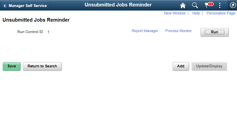

Notify Candidates with Unsubmitted Applications
Select this check box to notify candidates who have job applications in draft mode and have not submitted.
Email Template
Choose the email template to send notifications to candidates who have job applications in draft status. The default template is HRS_APP_NOTIF_UNS
Number of Days before Sending Notification
Choose the number of days to send a reminder email after an unsubmitted job application is created. The default value is 2 days.
Do not Notify Hours Before Job Close Date
Choose the hours before the job closing date from which the notifications to unsubmitted jobs should stop. The default value is 24 hours.
The email reminders to the candidates with unsubmitted jobs are scheduled using the Unsubmitted Jobs Reminder.
Job Search
Use the following settings to configure the appearance and behavior of the page where applicants see the results of a job search
Display Hot Jobs
Select this check box if you want the Search Results list to display a hot job icon next to postings for hot jobs.
Display Job Family
Select this check box if you want job family information to appear for each job posting.
If your system is configured to segment jobs by job family, the job family is specified on the job opening pages. Otherwise, the job family for a job opening is derived from the job code.
Display Job Function
Select this check box if you want job function information to appear for each job posting.
The Job Function for a job opening is derived from the job code.
Display Business Unit
Select this check box if you want business unit information to appear for each job posting.
Display Job Posting Close Date
Select this check box if you want the job posting close date to appear for each posting.
The close date is the last day that the job is posted. This is the day before the remove date that is specified on the PeopleSoft Talent Acquisition Manager: Posting Information Page in the job opening. For example, if the remove date is June 11, 2017, then the close date is June 10, 2017.
When a job posting does not have a remove date, the text catalog entry HRAM_FL_CLSDT_TXT provides text that appears in the Close Date field. The delivered text is Open Until Filled. To change this value, click the Edit icon or the Edit link next to this check box to access the text catalog entry on the Maintain Text Catalog page.
If you select this check box, consider also activating a search filter based on close date. For instructions on setting up this search filter, see PeopleSoft Talent Acquisition Manager: Configuring Recruiting Search Facets.
Note: This setting applies only to Fluid Candidate Gateway.
Display Next Review Date
Select to display the Next Review Date (if available) for the job postings in Search Jobs and My Favorite Jobs pages of Fluid Candidate Gateway.
Allow Multiple Job Selection
Select this check box to allow applicants to apply for multiple jobs from the job search results and from the My Favorite Jobs page.
When this check box is selected, buttons for applying for jobs appear with job search results and on the My Favorite Jobs page. Applicants can select multiple jobs using the check boxes that appear next to each job on the list, and then they can initiate a single online application that includes all selected jobs.
If you do not allow multiple job selection, applicants must initiate job applications and referrals from the Job Description page, which means that applications are always limited to a single job opening.
Allowing multiple job selection also enables internal applicants to initiate a referral for selected jobs on the job search page. (The My Favorite Jobs page always allows internal applicants to initiate referrals for selected jobs, regardless of the site configuration.)
Note: Fluid Candidate Gateway does not allow multiple job selection on small form factor devices. On these devices, the small screen becomes would be too crowded and unusable with additional page elements for multiple job selection.
Split Multiple Jobs
Select this check box if you want the My Applications page to separate and show the submitted multiple job application as individual applications. Applicants can view the status of each application and if required, can withdraw the application for each job separately. This field is enabled only if you select the ‘Allow Multiple Job Selection’ check box.
Note: This setting is not applicable for the display of application in Recruiting Digital Assistant. In the Chatbot, all multiple applications (drafted as well as submitted) are split by default and shown separately.
Display “Apply Without Selecting a Job”
Choose whether and where to display the link that allows applicants to apply without selecting a job.
Top, Bottom, and Both refer to the location of the link relative to the job search results list. You can show the link above the list, below the list, or in both places.
If you select Off, then the link does not appear at all, and applicants must select a job before applying to your organization.
Display Latest Jobs Posted Days
Enter a value from 1 to 99 if you want the Fluid Candidate Gateway Explore Jobs page to show the View Jobs Posted in Last <number> Days search option. For example, if you enter 30, the Explore Jobs page will include the option to View Jobs Posted in Last 30 Days.
The default value is zero. When the value is zero, the Explore Jobs page does not display the View Jobs Posted in Last <number> Days search option.
Note: This setting does not apply to Classic Candidate Gateway, which does not have a Explore Jobs page.
Select Search Results Display
Select how you want your search results to be displayed. The options available are Grid View, List View and Both.
These changes do not impact the small form factor. In mobile devices, Job Search results will continue to be displayed in List view.
Default View
If the search result display is chosen as Both then you can choose which view to be the default view. If the search result display is selected as either Grid view or List view, then the Default View option is disabled.

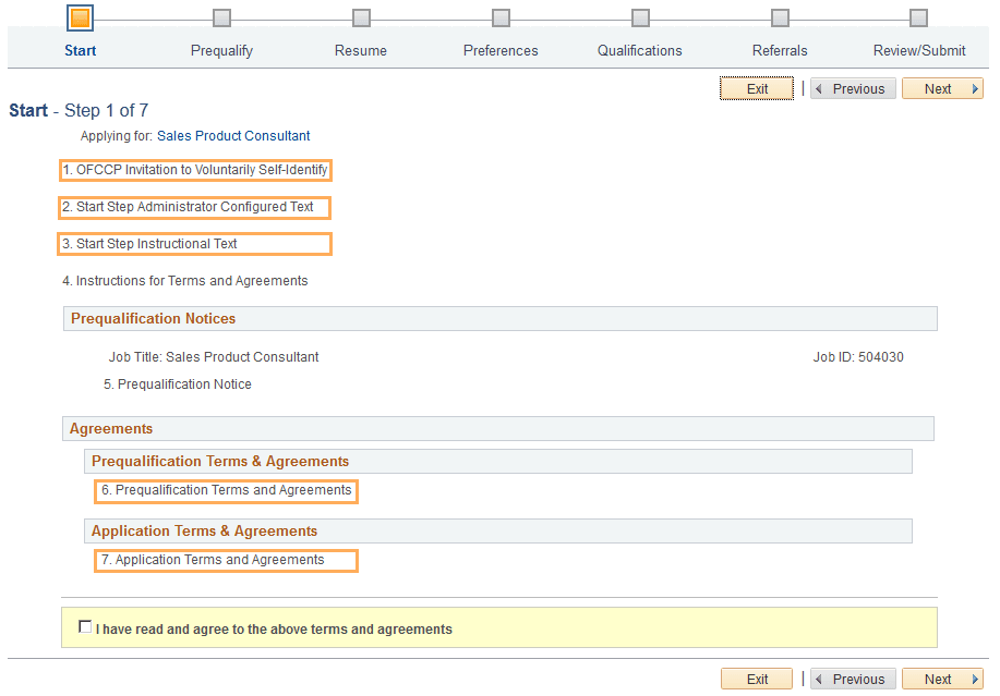

Job Application: Start Step Configuration
In Candidate Gateway, the job application process begins with a Start step that displays relevant information, instructions, and agreements. All text comes from the HCM Text Catalog, so you can easily change the text or define different text for different sites.
Certain text elements on the Start Step page are controlled by site-level settings.
In Fluid Candidate Gateway, terms and agreements text is referred to as Terms and Conditions, and it appears on a modal page that applicants access from the Start page. This is described in the topic Using Fluid Candidate Gateway to Apply for Jobs. For purposes of this discussion, however, all text elements are considered part of the Start page.
This example shows the text elements on the Start step in Classic Candidate Gateway. In this example, the five site-controlled text elements are highlighted.
Site-controlled text elements on the job application Start step
The first site-controlled element invites internal applicants to use Human Resources self-service pages to provide disability and veteran information. Only internal applicants see this text, which appears when the OFCCPed Self-Identify field (described earlier in this topic) is set to any value other than Not Applicable. To change the text, modify the related text catalog entry (HRAM_CE_DIS_INSTR4).
Use the following check boxes to choose whether the remaining four site-controlled text elements appear on the Start step:
Display Start Step Administrator Configured Text
Select this check box to include administrator-configured text in the Start step, immediately following any OFCCP Self-Identify text.
Use this text for any purpose: to introduce your organization, make announcements, and so forth.
Click the adjacent Edit icon or link to view or edit the related text catalog entry on the Maintain Text Catalog page. The system prompts you to choose one of these entries:
  • HRAM_CE_ADMIN_TXT for Classic Candidate Gateway
  • HRAM_FL_ADMIN_TXT for Fluid Candidate Gateway
Display Start Step Instructional Text
Select this check box to include instructional text in the Start step, immediately following any administrator-configured text.
This text is intended for general instructions related to the application process. Do not use it for instructions related to terms and agreements. If any terms and agreements appear on the Start step, separate agreement-specific instructional text appears after your Start Step Instructional Text.
  • HRAM_CE_INSTR_TXT for Classic Candidate Gateway
  • HRAM_FL_INSTR_TXT for Fluid Candidate Gateway
Display Start Step Guided Process Instructional Text
Select this check box to include instructional text on the usage of Apply for Job guided process in the Start step.
  • HRAM_FL_GP_INST for the guided process instructions.
  • HRAM_FL_GP_INST_LB for the label of guided process instructions.
If you have not implemented Fluid Candidate Gateway, then clicking the Edit button for any of the start page text elements immediately open the Text Catalog entry for the classic text.
In addition to the five site-controlled text elements, the Start step also displays additional elements based on context. You cannot prevent these notices from appearing:
  • If prescreening is active, the explanatory text specified in the screening definition is shown.
    This text comes from a text catalog entry that is specified in the job opening.
  • If application terms and agreements or prequalification terms and agreements are shown, instructions for terms and agreements are also shown.
    This text comes from text catalog entry HRAM_CE_DINSTR_TXT.
The system does not display the Start step unless at least one text section is visible. Applications with prescreening always display the Start step because prescreening always requires explanatory text.
Job Application: Additional Settings
Require Answers to Questions
Select this check box to require applicants to answer all questions in job applications. When this option is active, the system will prevent applicants from continuing to the next step if there are any unanswered questions on the current step. This settings applies to prescreening questions as well as to any non-prescreening questionnaire.
Display Resume Language
Select this check box to display the Language field on the Resume step of the job application. The Language field is informational only. Leaving this check box deselected so that the Language field is hidden does not affect resume processing.
Show Job Application Save in Content Area
Select this check box to show the ‘Save as Draft’ button in Application content area. This will make the ‘Save as Draft’ button the first actionable item on the page.
Acknowledgements
The Fluid Candidate Gateway enables you to configure acknowledgements for registered users or while applying for a job.
To create an Acknowledgement Configuration, see Enterprise Components: Setting Up the Acknowledgement Framework.
Registration Acknowledgement
Select this check box to include an acknowledgement text for users registering on Candidate Gateway. Registered users who login to Candidate Gateway for the first time after this check box was enabled also get the acknowledgement . When the acknowledgment is updated, all users get the acknowledgement the next time they login.
Note: Using Registration Acknowledgement overrides the Registration Agreement at PeopleSoft Talent Acquisition Manager: Recruiting Installation – Applicants Page.
Choose the acknowledgement that needs to be displayed to the users. For more information on configuring acknowledgements see Enterprise Components: Setting Up the Acknowledgement Framework.
Display Application Terms and Agreements
Select this check box to include application terms and agreements in the Start step. Use this text for general terms related to the submission of any job application. If you include this text, applicants must accept the terms before they can continue past the Start step.
  • HRAM_CE_APPL_INSTR for Classic Candidate Gateway
  • HRAM_FL_APPL_INSTR for Fluid Candidate Gateway
Display Prequalification Terms and Agreements
Select this check box to include prequalification (prescreening) terms and agreements in the Start step. The prequalification terms and agreements appear only when an application includes prescreening. If you include this text, applicants must accept the terms before they can continue past the Start step.
  • HRAM_CE_PREQ_INSTR for Classic Candidate Gateway
  • HRAM_FL_PREQ_INSTR for Fluid Candidate Gateway
Job Application Acknowledgement
Select this check box to enable acknowledgements for users whenever they apply for a job. Enabling this will automatically disable the options for Display Application Terms and Agreements and Display Prequalification Terms and Agreements.
Prequalification Terms and Conditions
Choose the acknowledgement configuration for the prequalification (prescreening) terms and agreements in the Start step.
Application Terms and Conditions
Choose the application terms and conditions acknowledgement to be displayed to users in the Start step. You can add up to three different terms and conditions.
Test Links
The system generates site URLs based on the site ID and the portal and node. There are separate URLs for internal applicant mode and external applicant mode.
Use the Internal Link and External Link test links to preview the site with your current settings. Conditional navigation does not apply when you use these links.
You can also copy and paste the URLs into browser windows. If you do this, conditional navigation opens either a Classic or Fluid page depending on the user’s security configuration. If you set up a public access user ID for external applicants, you can use the external applicant URL to test public access.
Chatbot Page
Use the Chatbot Page (HRS_SITE_BOT_SETUP) to configure and enable Recruiting Digital Assistant.
Navigation:
Set Up HCM, and then Product Related, and then Recruiting, and then Candidate Gateway, and then Site Set Up, and then Chatbot
This example illustrates the Chatbot page.
Chatbot Page of Site Set Up (Explore Jobs)
Enable Bot for External Candidates
Select the check box to enable Recruiting Solutions Assistant chatbot for external candidates. Once enabled, Recruiting Solutions Assistant chatbot will be available as a floating icon (chat widget) on External Candidate Gateway and on the Job Search and application pages.
Note: Applicable only to candidates with HRS External Chatbot User role.
Contact Information
Enable Contact Us Button
Select the check box to display the ‘Contact Us’ button in Recruiting Solutions Assistant.
Once enabled, a contact us icon will appear at the bottom of the chat window.
Note: Contact email or phone is optional. When the check-box is enabled, at least one value (email or phone number) should be provided. When a user press the ‘Contact Us’ icon, this information will be displayed.
Contact Email
Enter the email address to be displayed in the Recruiting Solutions Assistant chatbot.
Contact Phone
Enter the phone number to be displayed in the Recruiting Solutions Assistant chatbot.
Menu Configuration
Enable What Can You Do Button
Select the checkbox to display ‘ What Can You Do’ button in Recruiting Solutions Assistant.
Once enabled, a menu icon will appear at the bottom of the chat window. This menu will display all possible options a returning user has.
Note: This button doesn’t appear for anonymous user.
Show Label
Select this option if you would like to display the menu as label.
Show Icon
Select this option if you would like the menu to be displayed as an icon.
FAQ Configuration
Enable FAQs Button
Select the checkbox to display ‘FAQs’ button in Recruiting Solutions Assistant.
Once enabled, FAQ button with text or icon will appear at the bottom of the chat window.
Note: For FAQ's to work, at least one answer intent must be added in the PeopleSoft Recruiting Solutions Assistant skill in Oracle Digital Assistant.
Show Label
Select this option if you want to show the label, ‘FAQs’ on the button.
Show Icon
Select this option if you want to display the icon as the button.
Text Message Page
Use the Text Message page (HRS_SITE_TEXT) to configure and enable text messages in Fluid Candidate Gateway.
Text Messaging setup can be completed only after Twilio account configuration. For more information, see Twilio Setup Page.
Navigation:
Set Up HCM, and then Product Related, and then Recruiting, and then Candidate Gateway, and then Site Set Up, and then Text Message
This image illustrates the Text Message page.
Text Message Page of Site Set Up (Explore Jobs)
Site ID
Allow Text Notification
Select this check box to enable text messaging option in Fluid Candidate Gateway for external applicants.
Note: You can edit the other fields in the page only if ‘Allow Text Notification’ check box is selected.
Twilio Account
Select the twilio code to link the Twilio Account.
Text Agreement
Specify the acknowledgment that requires applicant’s consent to receive text message. You can select from the available options. Text Agreement is configured in Acknowledgment framework.
For more information, see Enterprise Components: Understanding the Acknowledgement Framework.
Note: Each organization should consult with its legal team to determine the language for Terms and Conditions.
OTP Expiry Duration (seconds)
Enter the number of seconds after which the OTP (One Time Password) expires. The default value is ‘60’ seconds.
Text Candidate After Registration
Select the check box to send a text notification to the candidate when they register at the site.
Note: Selecting this option will not affect the email notification configuration. The applicant continues to receive email notifications based on the site setup.
Text Template
Choose the required template for the text message. The system generates the text message based on the template that you select here.
Note: This field is enabled only if you select ‘Text Candidate After Registration’ check box.
Text Candidates for Draft Applications
Select the check box to send text notifications to the candidates who have job applications in draft mode and have not submitted.
Draft Text Template
Select the required template for the text message. The system generates the text message based on the template that you select here.
Note: This field is enabled only if you select ‘ Text Candidate After for Draft Applications’ check box.
Number of Days Before Sending Text
Choose the number of days to send a reminder text after an un-submitted job application is created. The default value is ‘2’ days.
Do Not Text Hours Before Job Close Date
Choose the number of hours before the job closing date from which the text notifications to un-submitted jobs should stop. The default value is ‘24’ hours.

Edit Welcome Page
Use the Edit Welcome Page page (HRS_WELCOME_ED) to create content for the Classic Candidate Gateway welcome page.
Navigation:
On the Site Setup page, click the Edit button next to the Display Welcome Page check box.
This example illustrates the Edit Welcome Page page.
Welcome page
This page contains a single rich text field where you create and format your welcome page content. Your welcome page can include images, text, and links.
Use the OK or Cancel button to return to the Site Setup page.
Use the Unsubmitted Jobs Reminder page (HRS_RUN_APP_NOTIFY) to schedule the notification to the candidates who have not yet submitted their job applications.
Navigation:
Recruiting > Administration > Unsubmitted Jobs Reminder.
This example illustrates the fields and controls on the Unsubmitted Jobs Reminder page.
Run
Click Run to run the Unsubmitted Jobs Reminder process.
Process Monitor
Click the Process Monitor link to see the status of the process that was run.
The unsubmitted jobs reminder process also triggers the text notification for draft applications if the applicant has opted to receive text messages and the text message setting for the draft application is turned on at the site setup.
