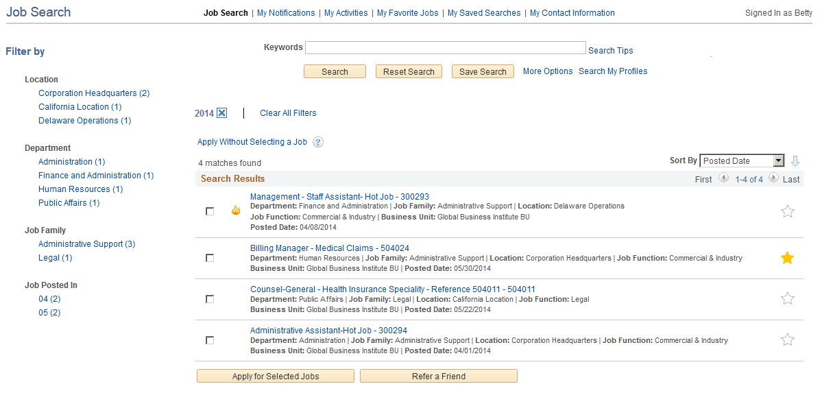

Job Search Page
Applicants use the Job Search page (HRS_APP_SCHJOB) to search for job postings and add or remove the job from your favorites.
Navigation:
The Job Search page appears when applicants first access the site.
External applicant may see the Welcome page first., in which case they click the Search Jobs Now button to continue to the Job Search page.
Click the Job Search link in the navigation bar that appears on pages throughout Candidate Gateway if the applicant is signed in.
See Accessing Candidate Gateway.
- Display the “Apply Without Selecting a Job” link above the job list.
- Allow multiple job selection: notice the check box column in the job list and the button below the job list.
- Include Job Family, Job Function, and Business Unit information for each job in the job list.

Active Filters
| Field or Control | Description |
Above the Search Results list, the page displays your currently active filters. Click the Remove Filter icon next to an active filter to remove the filter. |
Clear All Filters |
Click to remove all field-based filters. Clicking this link does not clear the keyword search filtering. |
Filter By

Search Results — General
<x> matches found |
Text above the Search Results title bar indicates how many postings match the search criteria. The number of postings that are included in the Search Results list is limited based on the search engine’s maximum and by the Max Jobs Returned from Search field on the PeopleSoft Talent Acquisition Manager: Recruiting Installation – Jobs Page. If the number of matches found exceeds the maximum for the Search Results list, the text takes the form XXX matches found. Only the first XXX results can be displayed. |
Sort By |
When an applicant selects a Sort By value, the system sorts the search results first by the selected field and then by job title. Sort options include Posted Date, Department, Job ID, Job Title, and Location. Additional sort options are available if the site is configured to show the corresponding fields in the search results. The additional sort options are Business Unit, Hot Jobs, Job Family, and Job Function. When an applicant first accesses the Job Search page, search results are sorted by posted date (most recent first), then job title. If the site is configured to show the hot job indicator, hot jobs appear at the top of the search results. If the result set is truncated because the number of jobs that meet the filter criteria is greater than the search engine’s maximum number of search results, sorting reorders the current set of jobs and does not bring missing jobs into the result set. |
Applicants use the icon next to the Sort By field to toggle between an ascending sort and a descending sort. An upward-pointing arrow indicates that jobs are currently sorted in ascending order; clicking the icon changes to a descending sort. Conversely, a downward-pointing arrow indicates that jobs are currently sorted in descending order, and clicking the icon changes to an ascending sort. All sort options except for Posting Date and Hot Jobs are initially shown in ascending order (A to Z). Sorting by posting date shows jobs in descending order (most recent first), and sorting by hot jobs shows jobs in descending order (hot jobs first). |
Search Results — Job Details
The Search Results lists the job postings that meet the current search criteria (including any filters).
<check box> |
If the Site Setup Page is configured to allow applicants to select and act on multiple jobs, check boxes appear next to each job listed. Applicants can select the check box for one or more jobs and then use the buttons below the job list to apply for multiple jobs or (for internal applicants) to refer a friend for multiple jobs. |
If the site is configured to show hot jobs, the hot job icon appears next to each hot job. If there are no hot jobs in the search results, this column is hidden. |
Job Title and Job ID |
Each posting in the search results has a title consisting of the job title followed by a hyphen and then the job opening ID. Clicking this concatenated title displays the Job Description Page, where the applicant can review the complete job posting information and then apply for the job, email the job to a friend, or refer a friend. If a job posting has changed but has not yet been re-indexed, an applicant who clicks the job title to view job details will see a message that the information is temporarily unavailable. |
Department |
Displays the department for the job opening. |
Job Family |
Job family information is shown only if the site is configured to show this data. If the system is not configured to segment job openings by job family, the job opening does not have job family data. In this situation, the system uses the job family (if any) that is associated with the primary job code. |
Location |
If a job has one recruiting location, that location name appears here. If the job has multiple recruiting locations, the text Multiple appears. To see a full list of locations, the applicant can click the job title to access the Job Description page. |
Job Function |
Job function information is shown only if the site is configured to show this data. |
Business Unit |
Business Unit information is shown only if the site is configured to show this data. |
Posted Date |
Displays the date that the job was posted to the current site. |
Applicants use the Favorite Job icon to add or remove a job from a personal list of favorites. A solid gold star for a job posting indicates that the posting is currently a favorite. Clicking the star removes the job from the favorites list. A gray outline of a star indicates that the job is not currently a favorite, and clicking the star marks the job as a favorite. Applicants can easily access their list of favorite jobs by going to the My Favorite Jobs Page. |

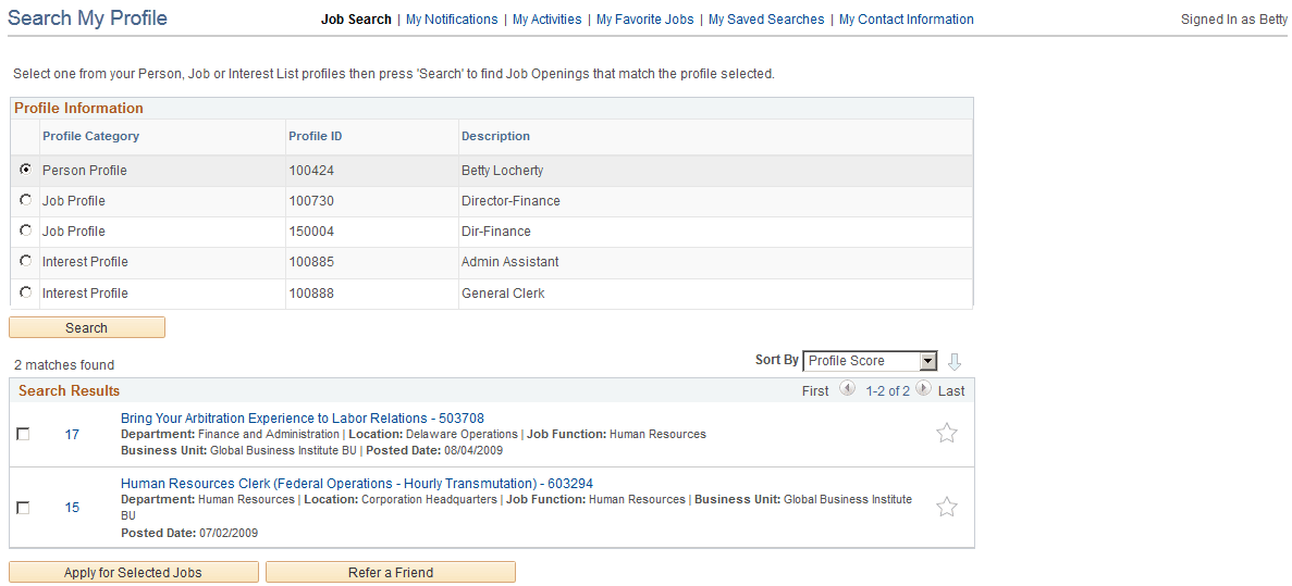

Search My Profile Page
Internal applicants use the Search My Profile page (HRS_APP_SCHMYPRF) to search for job openings that match the applicant’s own person, job, or interest profile.
Navigation:
Click the Search Your Profiles link on the Explore Jobs Home page.
This example illustrates the Search My Profiles page.
Search Criteria
Profile Information |
This grid lists the person, job, and interest profiles that are associated with the internal applicant who is using the page. The applicant selects a single profile to use for the search. |
Search |
The applicant clicks this button to search for job openings with profiles that have similar content to the selected profile. |
Search Results
This grid is identical to the search results grid for the main Job Search except that the profile search includes a Score column. The score indicates how closely the job opening matches the applicant’s profile. The system initially sorts the results by score so that the closest match is first in the list.
Sort |
The Search My Profile page includes the same sorting options as the main Job Search page, with an additional option to sort by Score. |
Score |
Click to access the Match Result page, which shows a detailed comparison of how well the job opening matches the profile that was used for searching. |

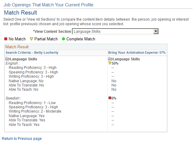

Match Result Page
Use the Match Result page (HRS_COMPARE_RES) to view detailed information about how well a job opening matches the profile that was used for searching.
Navigation:
Click the score for a job opening in the Search Results grid on the Search My Profiles page.
This example illustrates the Match Result page.
The first column (or, in accessible mode, the first grid) displays the content sections and content items in the profile that was used for searching.
The second column (or, in accessible mode, the second grid) shows the corresponding data in the job opening whose score you clicked to access this page. The column displays an overall score for how closely the job opening matches the source profile, and it also displays also scores for each content item in the source profile. For information on how scores are calculated, see PeopleSoft Human Resources Manage Profiles: Understanding Search and Compare Profile Scores Using the Classic Pages. Note that the Profile Match search disregards settings marking any particular content item as required and sets the importance of every content item to Average.
View Content Section |
Select View All Sections to list all the sections in the profiles, or select a section to view the information for one content section. The default is View All Sections. |

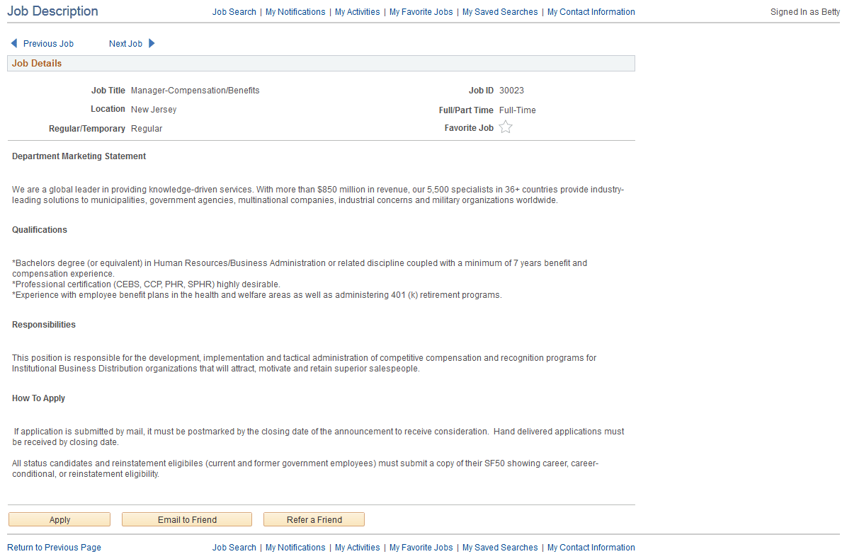

Applicants use the Job Description page (HRS_APP_JBPST or HRS_CE_JOB_DTL) to:
View complete posting information for a job.
Start an application for a single job, add a job to the saved jobs list, or email the job to a friend.
Refer a friend for the job (internal applicants only)
Navigation:
Click a job title on the Job Search page.
This opens the version of the page with object ID HRS_APP_JBPST.
Click a job title on the My Favorite Jobs page.
This opens the version of the page with object ID HRS_CE_JOB_DTL.
This example illustrates the Job Description page.
Previous in List and Next in List |
When you access this page from a list with multiple job openings, click these links to navigate between job openings without returning to the list. |
Job Details |
This area of the page includes read-only summary information about the job opening. If a job has multiple recruiting locations, the location field lists all of them. |
<Posting Description> |
The posting description appears below the job details section. The posting description comes from the PeopleSoft Talent Acquisition Manager: Posting Information Page. When a recruiter creates a posting description, sections within the description can be marked as visible to internal applicants, external applicants, or both. In Candidate Gateway, the appropriate sections are concatenated based on whether the applicant is internal or external. |
Apply |
Applicants click this button to begin a job application for the specified job. See Applying for Jobs. |
Email to Friend |
Applicants click this button to access the Send Email Page, where they supply a friend’s email address and send the job information to the friend. |
Refer a Friend |
This button is visible only to internal applicants. Internal applicants click this button to initiate the process of referring a friend for a job opening. The Refer Friend - Resume Page appears. |
