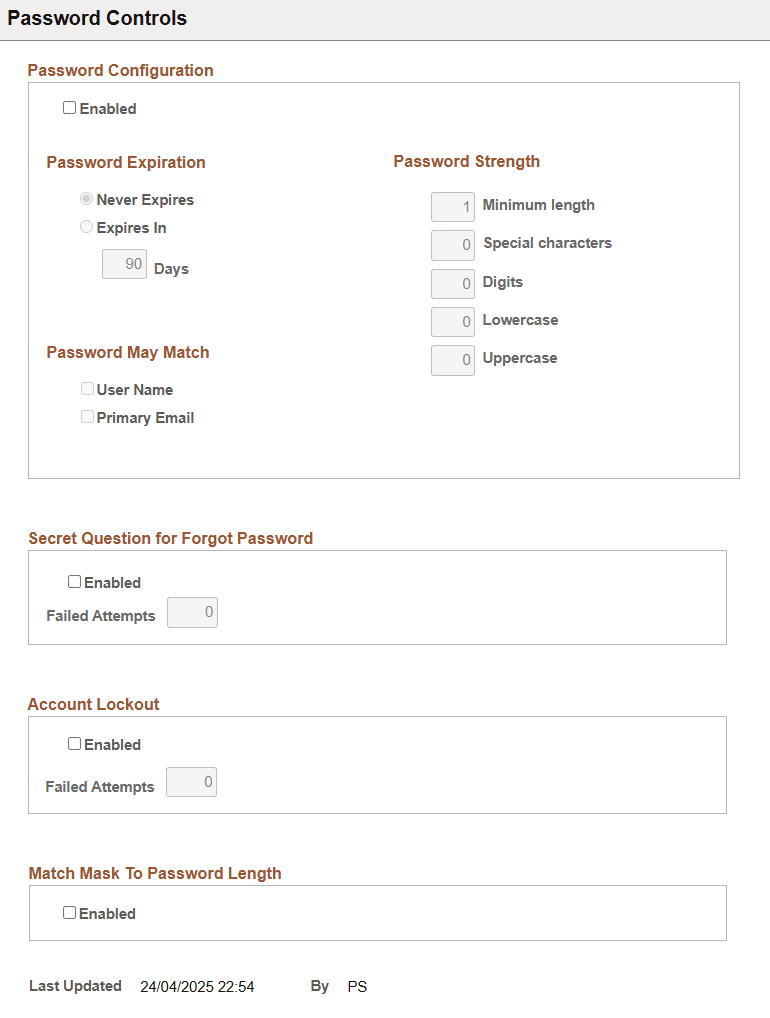

Password Controls Page
Use the Password Controls page (HRS_PSWD_CFG) to define password requirements for applicants.
Navigation:
Set Up HCM, and then Product Related, and then Recruiting, and then Candidate Gateway, and then Password Controls
This example illustrates the Password Controls page.
Password Configuration
Field or Control Description
Enabled
Select this check box to activate the password controls in the Password Configuration section of this page. When you deselect the check box, the current password configuration settings are cleared and the fields become read-only.
This check box does not control the Secret Question for Forgot Password settings or the Account Lockout settings.
Password Expiration
Never Expires
Select this option if you do not want to set a limit on how long users can use a password before it must be reset.
Expires In <number of> Days
Select the Expires In option to set a limit on how long a password can be used, then define the expiration period by entering the number of Days that the password remains valid.
Password May Match
User Name
Select this check box to allow passwords that are identical to the user name (the logon ID). Passwords must still meet all password strength requirements.
Primary Email
Select this check box to allow passwords that are identical to the user’s primary email. Passwords must still meet all password strength requirements.
Because password validation occurs only when a password is resent, users will not be forced to change a password due to a change in the primary email address.
Password Strength
Minimum Length
Enter the overall minimum number of characters for passwords. This number must be large enough to accommodate any additional requirements for minimum numbers of special characters, digits, lowercase letters, and uppercase letters.
Special Characters
Enter the minimum number of special characters for passwords. The following characters are considered special characters:
! @ # $ % ^ & * ( ) - _ = + \ |[ ] {} ; : / ? . > <
Digits
Enter the minimum number of digits (numbers) for passwords.
Lowercase
Enter the minimum number of lowercase letters for passwords.
Uppercase
Enter the minimum number of uppercase letters for passwords.
Enabled
Select this check box to require applicants to answer a secret question when requesting help with a forgotten password. The applicant must answer the question correctly before the system will send a temporary password.
When you select this check box, the system verifies that the PeopleSoft Talent Acquisition Manager: Recruiting Installation – Applicants Page is configured to require email addresses from applicants. If applicant email addresses are not required, an error message appears, and you cannot save the password settings until you deselect this check box.
Failed Attempts
If you enable a secret question for forgotten passwords, enter the number of incorrect answers that will cause an applicant’s Candidate Gateway account to be locked. This number must be greater than zero.
Account Lockout
Enabled
Select to activate the account lockout feature, which locks applicants out of their Candidate Gateway accounts after a specified number of failed logon attempts.
Failed Attempts
If you enable account lockout, enter the number of failed logon attempts that will cause an applicant’s Candidate Gateway account to be locked. This number must be greater than zero.
Match Mask To Password Length
Enabled
Select to enable masking of password to the same number of characters as the password's actual length. By default, this option is disabled.
Note: The masking of password to match the password length is only available with PeopleTools 8.57 or later.
