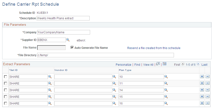

Define Carrier Rpt Schedule Page
Use the Define Carrier Rpt Schedule page (BN_M_SCHEDULE) to define carrier reporting schedule information that the system needs to send the correct information to the supplier.
Navigation:
Set Up HCM, and then Common Definitions, and then Supplier Administration, and then Carrier Report, and then Define Carrier Rpt Schedule, and then Define Carrier Rpt Schedule
This example illustrates the fields and controls on the Define Carrier Rpt Schedule page.
Field or Control Description
Schedule ID
Displays the unique identification code that is assigned to this schedule. It can be up to six characters long.
Company
Enter the name of your company. This information is included in the header section of the files that are sent to the supplier.
Supplier ID
Select the supplier ID from the list of valid options.
File Name
The name of the file sent to the supplier. You can create your own name or have the system generate a name for you.
When creating your own name, make sure that it is a name that helps you easily identify the contents. If you run the Carrier Interface Schedule process more than once using the same name and directory, a sequence number is placed in front of the file name. For example, if you send a file with the name eBenX twice, the first and second file names will be eBenX.txt and 2eBenX.txt, respectively.
To have the system generate a name, leave File Name blank and select Auto Generate File Name.
Select to create a file name for yourself. When you select this check box, the File Name field becomes unavailable for entry. The system creates the name using the following format: <Schedule ID name>_YYYY-MM-DD-HH.MM.SS.txt.
Resend a file created from this schedule
This link appears only if a file was created by this schedule. Click it to display the Resend File page.
File Directory
Enter the name of the directory located on the application server where the extract file is to be stored.
Extract Parameters
This group box enables you to select only the information that you want to extract from the BN_SNAP files for this supplier. You can enter more than one row of parameters.
Set ID
If you want enrollment information for a specific setID, select a setID from the list of available options. You must enter at least one setID.
Vendor ID
If you want enrollment information for a specific benefit provider, select a vendor ID from the list of available options. If you want information for all benefit providers, leave this field blank.
Plan Type
If you want enrollment information for a specific benefit plan type, select a plan type from the list of available options. If you want information for all plan types, leave this field blank.
