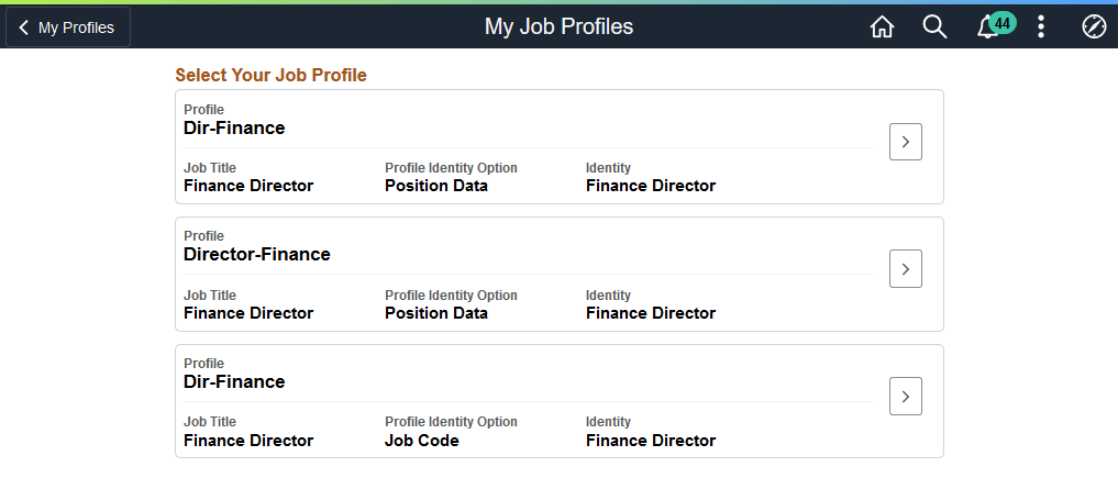

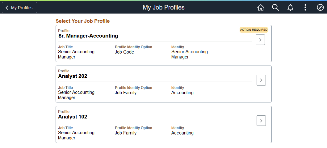

My Job Profiles - Select Your Job Profile Page (for Employees)
Use the My Job Profiles - Select Your Job Profile page (JPM_EMP_RELPROF_FL) to select to view one of your job profiles.
This page is available when your job is associated with more than one profile.
Navigation:
  • Click the My Job Profiles Tile (for Employees) on the My Profiles Dashboard (or any other home page with the tile).
  • Self Service, and then Learning and Development, and then View My Job Profiles
  • Select the Related Actions icon button next to your name and select Development, and then View My Job Profiles
This example illustrates the My Job Profiles - Select Your Job Profile page. In this example, this person’s position is associated with two profiles and the job code is associated with a profile.
My Job Profiles page
This example illustrates the My Job Profiles - Select Your Job Profile page when an acknowledgement action is required.
My Job Profiles page displaying action required notification to acknowledge a job profile
This page displays those non-person profiles associated with your job.
When a job profile is participating in the acknowledgement process and you need to review and acknowledge that you understand the requirements of the profile, the row will display an ACTION REQUIRED badge above the Select Profile chevron > button. After you acknowledge the profile, the badge will no longer appear.
See also PeopleSoft Human Resources Manage Profiles: Understanding Job Profile Acknowledgements.
Select a row to access the My Job Profiles page [see My Job Profiles Page (for Employees), View Job Profiles Page (for Employees), and Maintain Job Profiles Page (for Managers)] and view the details about the profile.

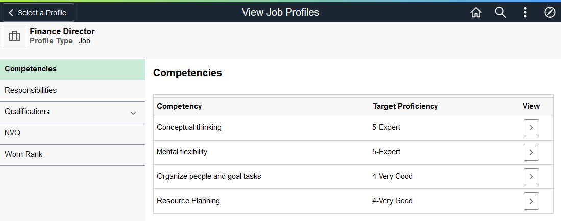

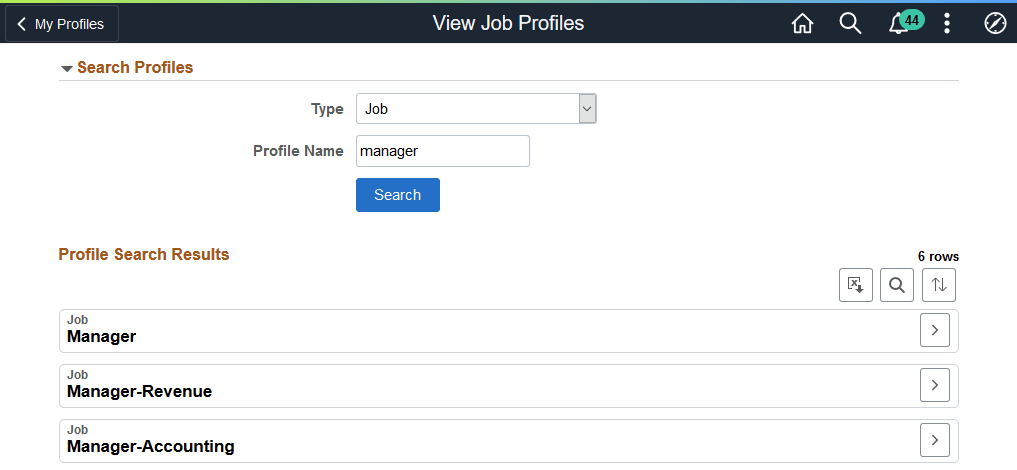

View Job Profiles (for Employees) or Maintain Job Profiles (for Managers) - Search Profiles Page
Use the View Job Profiles or Maintain Job Profiles -- Search Profiles page (JPM_COMPRF_SRCH_FL) to select a job profile you want to review.
The page title will vary according to how you access the page:
Navigation:
As an employee:
As a manager:
This example illustrates the fields and controls on the View Job Profiles - Search Profiles page. The Maintain Job Profiles - Search Profiles page works the same, with the exception being in the name of the banner title.
View Job Profiles - Search Profiles Page
Field or Control Description
Type
Select the profile type from which you want to search. Valid values are defined on the PeopleSoft Human Resources Manage Profiles: Profile Types - Attributes Page and display according to the manager or employee security.
Profile Name
Enter the full or partial name of non-person profiles that you want to have returned in your search.
Search button button
Click this button to have the system retrieve profiles that meet your criteria and display them in the Profile Search Results section of the page.
Select Profile arrow button (Select Profile) arrow button
Select this button to access the View Job Profiles or Maintain Job Profiles page for this profile [see My Job Profiles Page (for Employees), View Job Profiles Page (for Employees), and Maintain Job Profiles Page (for Managers)].

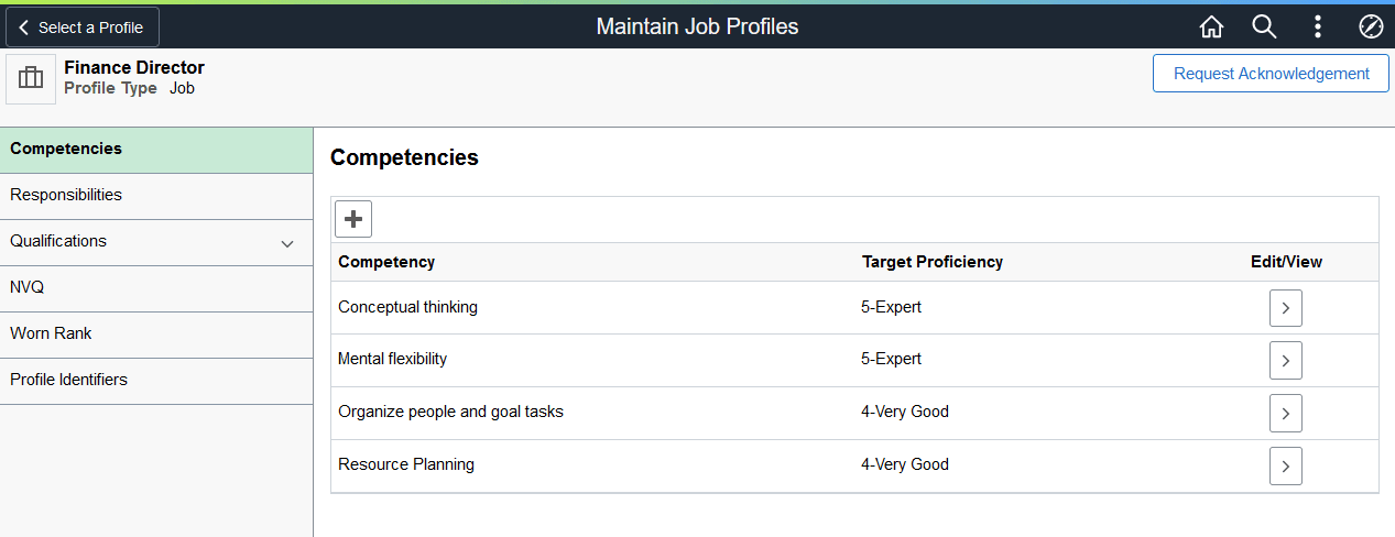

Use the specific Job Profiles pages (JPM_NPERS_PROFL_FL) to view non-person profiles, or create and update non-person profiles when granted permission. Employees can also use My Job Profiles to acknowledge their job profiles, when required. Managers can use Maintain Job Profiles to submit an acknowledgement request for participating profiles.
The page title in the banner will vary according to how you access the page:
Navigation:
(Tablet) This example illustrates the fields and controls on the employee's View Job Profiles page using a medium or large form factor device.

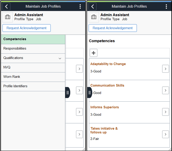

(Smartphone) This example illustrates the manager's Maintain Job Profiles page for the smartphone. This example shows the page when the content type panel is expanded to show the list of included content types on the left, and then the Competencies page with the navigation panel collapsed.
(Smartphone) Maintain Job Profiles Page
The job profile pages work the same as the person profile pages, using content tabs, content section pages, and a list of content item that are associated with the profile for the various content section pages.
For information on how to use the profile pages, see the Talent Profile Page (for Employees) or Team Talent Profile Page (for Managers) topic.

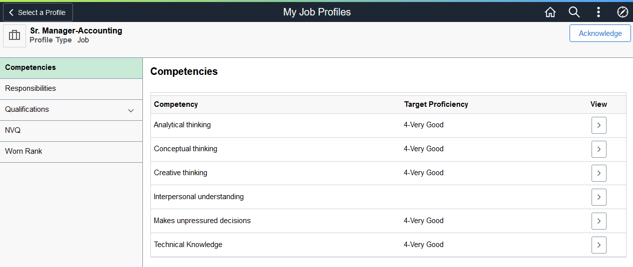

Working with Acknowledgements
When a profile is configured to participate in the job profile acknowledgement process, additional buttons may appear at the top of the page for the employee or manager.
  • (Employee) The Acknowledge button appears at the top of the My Job Profiles page for employees when an employee is associated with a profile that is participating in acknowledgements and the system has run the acknowledgement requests process.
    This example illustrates the My Job Profiles page for the employee showing the Acknowledge button.
    Acknowledge button
    Select this button to indicate that you have reviewed the profile attributes and acknowledge that you understand the requirements of your job. This will then display the Acknowledge Profile Page (for Employees), for you to confirm your acknowledgement.

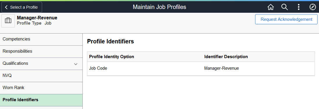

Profile Identifiers Page Tab
Managers can select the Profile Identifiers page tab to view profile identities associated with the profile.
This page tab is available for a manager when accessing the Maintain Job Profiles page.
Profile Identifiers allow you to select one or more objects to which the profile type can be linked. For example, administrators can set up a profile type that is linked to job code. Identifiers include job codes, job functions, job families, people, and salary grades. Identifiers for a profile type are defined on the PeopleSoft Human Resources Manage Profiles: Profile Types - Identities Page, which is the component that defines the structure of a non-person profile. This is also where the administrator configures profile types and identities (identifiers) for participation in acknowledgements.
This example illustrates the Maintain Job Profiles - Profile Identifiers page.
Maintain Job Profiles - Profile Identifiers tab and page
