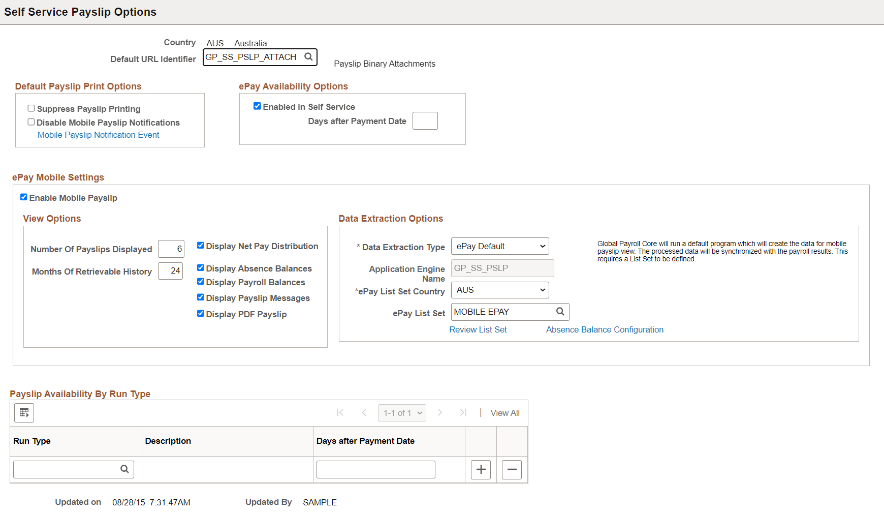

Self Service Payslip Options Page
Use the Self Service Payslip Options page (GP_SS_PSLP_OPTIONS) to enable online payslip printing using the View Payslip self-service transaction, and to enable mobile access to payslips.
Navigation:
Set Up HCM, and then Product Related, and then ePay, and then Self Service Payslip Options, and then Self Service Payslip Options
This example illustrates the fields and controls on the Self Service Payslip Options page.
Field or Control Description
Default Payslip URL Identifier
Enter the URL identifier that contains the FTP URL where the PDF files for this country are stored.
The default URL identifier is GP_SS_PSLP_FTP. If you created your own URL identifier, you must make sure to enter that URL identifier here.
Default Payslip Print Options
Suppress Payslip Printing
Select this check box if you do not want payslips to be printed.
Note: If your country extension does not support the ability to suppress the printing of payslips, you should leave this check box deselected.
This check box serves as the default selection for your organization. It does not override existing individual payee settings.
Disable Mobile Payslip Alert
Select the checkbox to disable payslip notifications. This field is displayed only when Notification Composer feature is disabled in the system.
Disable Mobile Payslip Notifications
Select the checkbox to disable payslip notifications, if Notification Composer is enabled. Employees will not receive notifications if Notification Composer is enabled and this checkbox is selected.
Note: This field is displayed only when Notification Composer feature is enabled in the system.
Mobile Payslip Notification Event
Click this link to access the Notification Composer cross reference page where it will list the notification event ids that are mapped for employee based notifications.
Note: This link is displayed only when Notification Composer feature is enabled in the system.
Oracle PeopleSoft delivers Notification Composer Framework to manage the setup and administration of all notifications in one central location.
Once you have adopted the Notification Composer feature, you must use it to create new notifications and manage your existing notifications.
Notifications delivered with HCM Image 47 or later must use Notification Composer.
For more information about Notification Composer Framework, see Enterprise Components: Understanding Notification Composer.
ePay Availability Options
Enabled in Self Service
Select this check box if you want payees to control whether they receive a printed copy of their payslip, overriding the default selection that you enter on this page. If selected, the Paper Payslip Instructions group box displays on the View Payslips page.
Note: If your country extension does not support the ability to suppress the printing of payslips on an individual payee basis, you should leave this check box deselected.
Days after Payment Date
Specify when the payslip is available for viewing using View Payslip. The date determined using this information is the earliest date that the payslip is available; once this date has passed, the payslip is always available. You can enter:
  • Zero to indicate that the payslips are available on the payment date.
  • A number greater than zero to indicate the number of days after the payment date that payslips are available.
  • A negative number to indicate the number of days before the payment date that payslips are available.
ePay Mobile Settings
Enable Mobile Payslip
Select to enable payees to access detailed information for their payslips using the PeopleSoft Fluid User Interface. When you select this check box, clicking a payslip on the Payslips Page accesses the Payment Summary Page.
Note: You can access the Payment Summary page and other mobile payslip pages only with small form factor devices, such as a smartphones. Clicking a payslip on the Payslips page using any other form factor device simply opens the payslip in PDF format.
When you select this check box, the fields in the View Options and Data Extraction Options group boxes become available.
View Options
Number of Payslips Displayed
Specify how many payslips you want displayed on the Payslips Page.
Months of Retrievable History
Specify the time period for which payees can access mobile payslip information.
Display Net Pay Distribution
Select to enable payees to access the Payment Distribution Page from the Payment Summary Page.
Display Absence Balances
Select to enable payees to access the Balances Page from the Payment Summary Page.
Display Payroll Balances
Select to enable payees to access the Payroll Balances Page from the Payment Summary Page.
Display Payslip Messages
Select to display Payslip Messages link on the Mobile Payslip. For details, see Payment Summary Page
Display PDF Payslip
Select to display the View PDF Payslip link on the Payment Summary Page.
Data Extraction Type
Define the method the system uses to extract the data displayed for mobile payslips. Values are:
  • Call Using ePay Default: If you select this value, Global Payroll calls the specified application engine as a part of ePay processing. The system does not run the default Global Payroll delivered program. This option allows you to define your own processing logic.
  • Custom: If you select this value, Global Payroll refers to the staging tables for mobile pay to extract data for mobile payslips. Select this option when you are using a country specific payslip process to populate the staging tables.
    Note: The Custom value is intended for customers who are already using ePay. If you are not using ePay and you select this value, you must manually populate the GP_SS_PSLP_GDE record to extract mobile payslip data.
  • ePay Default: If you select this value, Global Payroll runs a default program that creates mobile payslip data. The system synchronizes the processed data with the payroll results. This requires you to define values for the ePay List Set Country and ePay List Set fields. When you select this value, the system automatically populates the Application Engine Name field with the Global Payroll Core application for ePay.
Enter the application engine that you want the system to use to extract payslip data. This field is available to edit only if you select the Call Using ePay Default: value in the Data Extraction Type field.
Define the country for which you are selecting a list set.
ePay List Set
Define the list set that you are using to extract payslip data.
Review List Set
Click to access the PeopleSoft Global Payroll: Define List Set Page where you can review and update the list set you selected in the ePay List Set field.
Absence Balance Configuration
Click to access the PeopleSoft Absence Management: Balances Page where you can review and update the absence balance elements that the system displays for mobile payslips.
Payslip Availability By Run Type
Run Type and Days after Payment Date
If you want a run type to have a different payslip availability date than the default that is specified in the ePay Availability Options group box, enter the run type and then specify the number of days before or after the payment date that you want payslips to be available.
