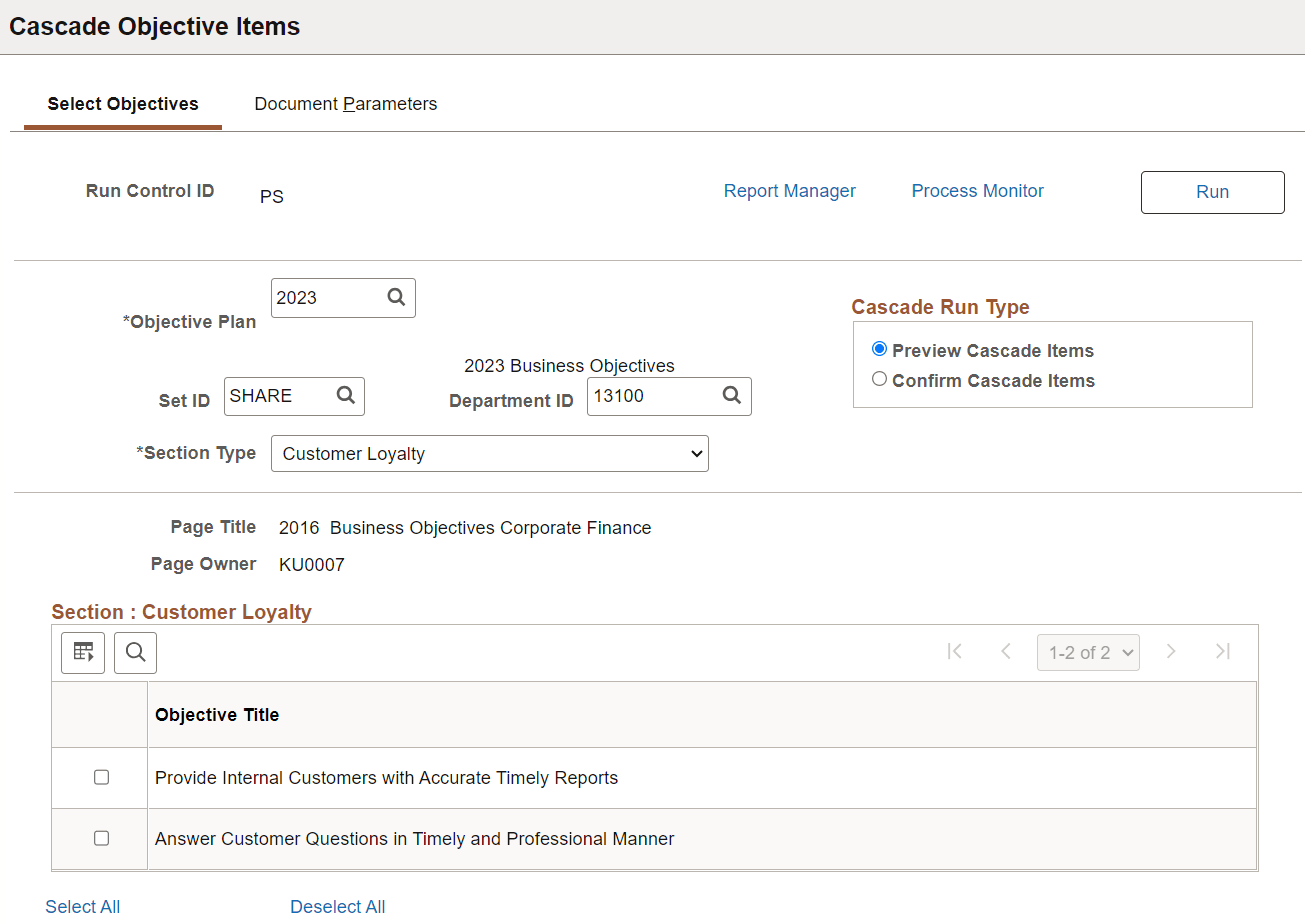

Select Objectives Page
Use the Select Objectives page (EPO_SEL_OBJ) to select the objective items that you want to cascade to individual performance documents from the Business Objective pages.
Navigation:
Workforce Development, and then Performance Management, and then Business Objectives, and then Cascade Objective Items, and then Select Objectives
This example illustrates the fields and controls on the Select Objectives page.
Field or Control Description
Objective Plan
Select the objective plan that contains the object items that you want to cascade down to employee documents. The system refreshes the page and then displays the Set ID and Department ID fields if the plan is based on the department hierarchy.
If the objective plan is associated with a position ID, the system displays this field instead of Set ID and Department ID.
Set ID
The system automatically enters the set ID associated with the objective plan. You can, however select a different set ID if needed.
Department ID
Enter the department ID associated with the objective plan.
Position ID
Enter the position ID associated with the objective plan. If the objective plan is associated with a position ID, the system displays this field instead of Set ID and Department ID.
Cascade Run Type
Select Preview Cascade Items (default value) if you want to preview the results of the process in the Cascade Item report (EP_CASCADE.pdf) that is available in the Report Manager. This option generates the report that lists if and to which documents the selected items would be cascaded successfully. It does not actually cascade the items to the documents you select on the Document Parameters page.
Select Confirm Cascade Items if you want to run and cascade the items to the documents. This option also generates the Cascade Item report.
Section Type
Select the section type associated with the objective plan that you want to cascade down to your organization.
Page Title and Page Owner
The system displays the page title and page owner when you select a value for the Position ID field or the Department ID field.
Section <Name>
When you select a value for the Section Type field, the system displays a list of objectives associated with the objective plan and section. Select the objectives that you want to cascade down to the documents that you select on the Document Parameters page.

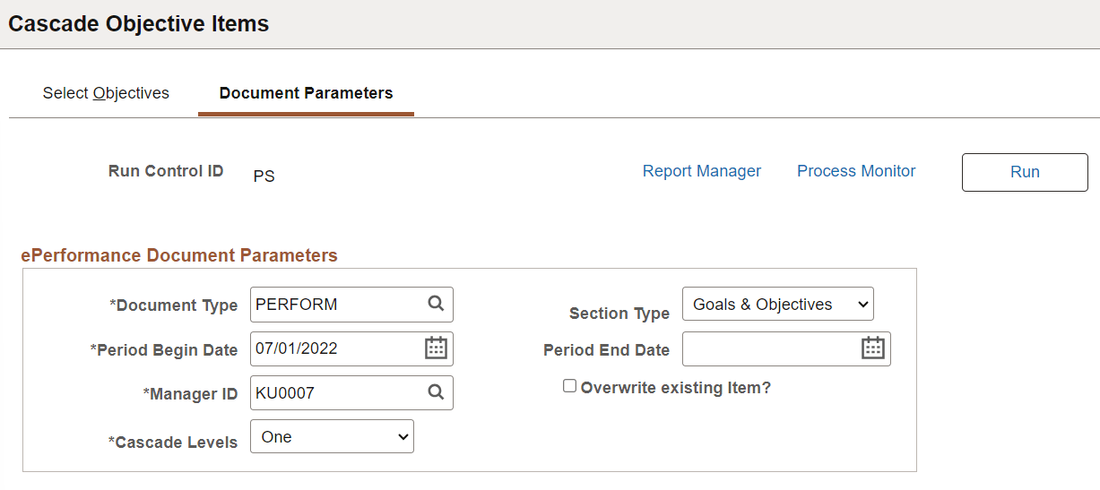

Document Parameters Page
Use the Document Parameters page (EPO_DOC_PARM) to select the ePerformance document parameters to which you want to cascade business objective items.
Navigation:
Workforce Development, and then Performance Management, and then Business Objectives, and then Cascade Objective Items, and then Document Parameters
This example illustrates the fields and controls on the Document Parameters page.
Document Type
Select the document type associated with the objective plan that you selected on the Select Objectives page.
Section Type
Select a section type to which you want to cascade objective items. The drop-down list box displays all section that have same content type as the section of the Objective page.
Period Begin Date and Period End Date
The system automatically enters period begin and end dates from the period dates on the objective plan. You can, however, overwrite these dates if they don't match the dates of the document. The dates entered here are used to select documents that fall within the range.
Manager ID
This field determines the manager that the system should start at to establish the population of employee documents. The system follows the direct report method used in ePerformance to determine the manager's direct reports.
Overwrite existing item?
Select this check box if you want to overwrite items that already exist on the documents to which you are cascading items.
Cascade Levels
Select either One or All to indicate the number of levels to which you want to cascade items down to the selected documents.
Selecting All will cascade items to the documents of all direct and indirect reports of the manager. Selecting One will only cascade items to documents of the manager's direct reports.
