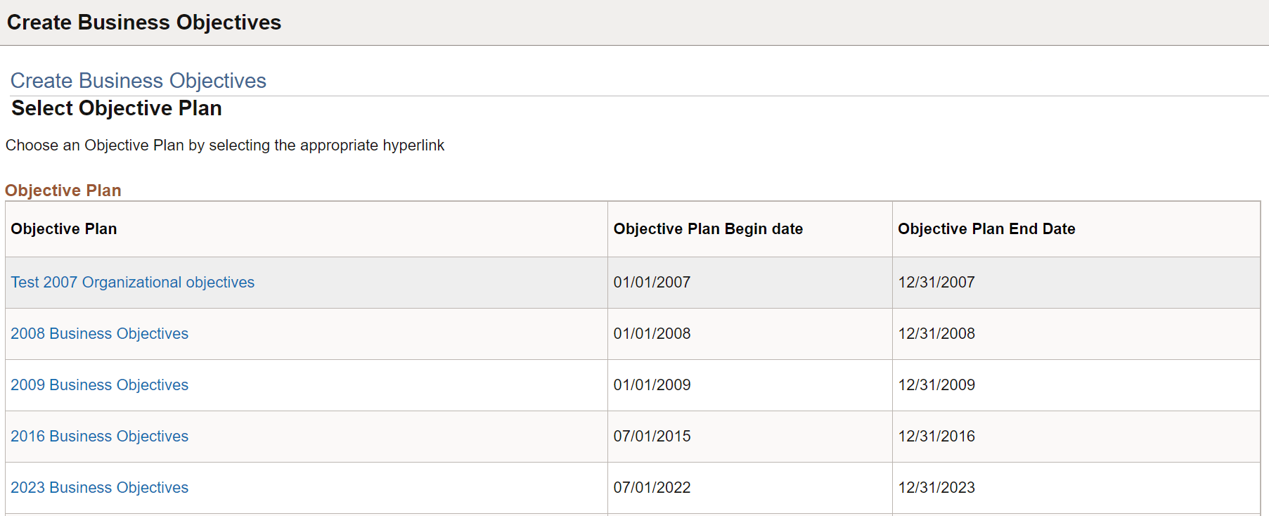

Create Business Objectives - Select Objective Plan Page
Use the Create Business Objectives - Select Objective Plan page (EPO_PLAN_SELECT) to create business objectives for objective plans.
Navigation:
Workforce Development, and then Performance Management, and then Business Objectives, and then Create Business Objectives, and then Create Business Objectives - Select Objective Plan
This example illustrates the fields and controls on the Create Business Objectives - Select Objective Plan page.
Click the link associated with the objective plan for which you want to create objective pages.

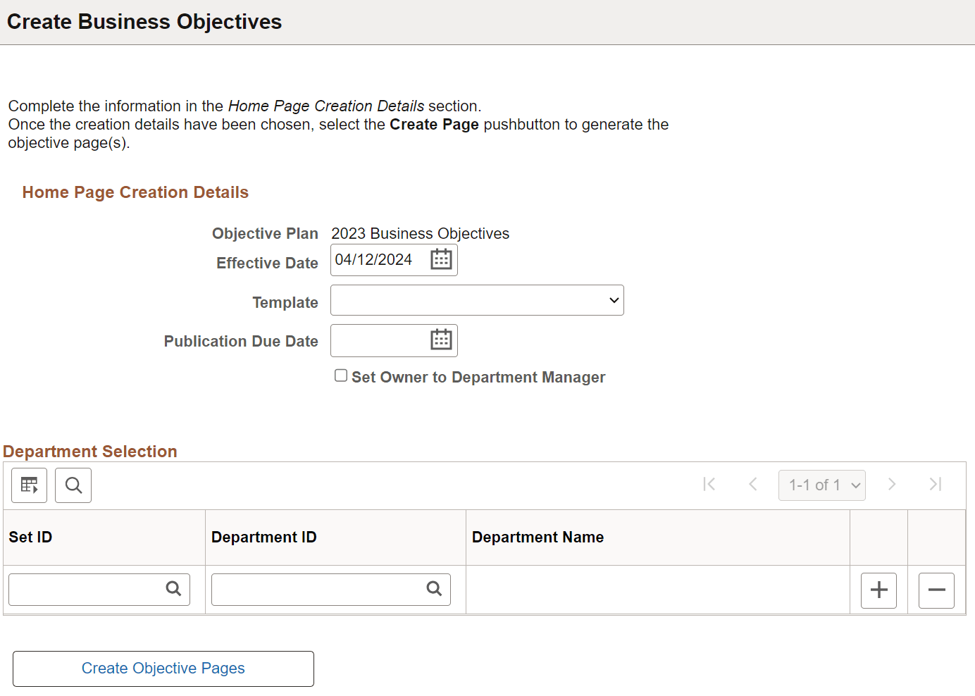

Create Business Objectives Page
Use the Create Business Objectives page (EPO_CREATE_PAGE) to enter the criteria to be used to create the business objective pages.
Navigation:
Click the link associated with the objective plan for which you want to create business objective pages on the Create Business Objectives - Select Objective Plan page.
This example illustrates the fields and controls on the Create Business Objectives page.
Home Page Creation Details
Field or Control Description
Template
Select the template that you want to use to create objective pages. The system only displays templates that are effective as of the Objective Plan date.
Publication Due Date
Enter the date that pages owners should complete their page by and submit it for publication.
Set Owner to Department Manager or Set Owner to Position Manager
This field changes based on the hierarchy method associated to the objective plan you selected. Select this check box to assign the page owner to either department manager or position manager.
Department Selection
If you selected Department as the hierarchy method on the Objective Plan page, the system displays these fields in the grid:
Set ID
Enter or select the set ID of the department that for which the page will be created.
Department
Enter or select a department ID. The system displays only active departments in effect as of the effective date of the objective plan.
Create Objective Pages
Click to create the objective pages for the departments that you selected in the Department Selection grid. The system displays the Create Objective Pages - Confirmation page. This page lets you know which pages have been created and which pages have not been created.
Position Selection
If you selected Position as the hierarchy method on the Objective Plan page, the system displays these fields in the grid:
Position Number
Enter or select a position number. The system displays only active positions in effect as of the effective date of the objective plan.
Position Name
Once you select a position, the system displays the position name.
Click to create the objective pages for the positions that you selected in the Position Selection grid. The system displays the Create Objective Pages - Confirmation page. This page lets you know which pages have been created and which pages have not been created.

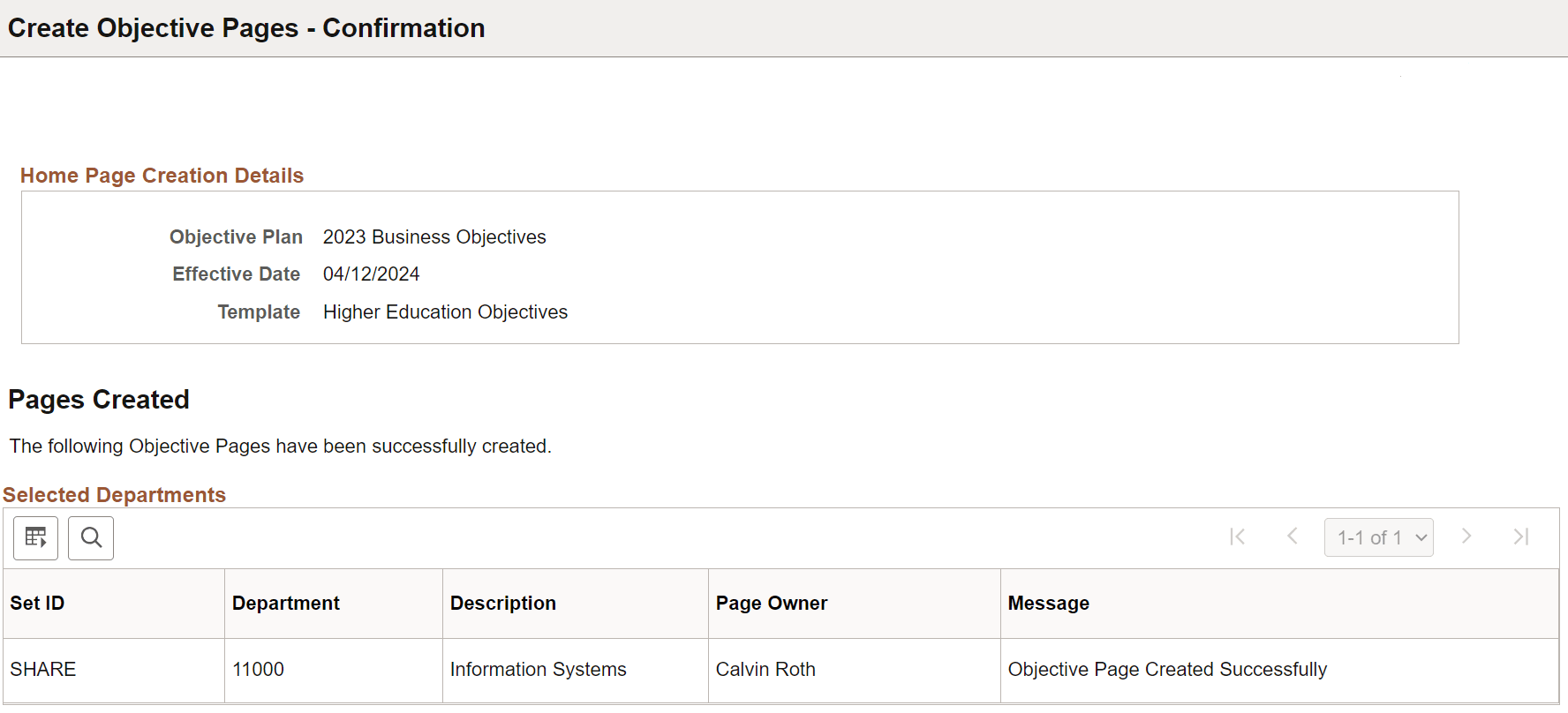

Create Objective Pages - Confirmation Page
Use the Create Objective Pages - Confirmation page (EPO_CREATE_RSLTS) to view the results of the create process to verify that your objective pages were created successfully.
Navigation:
Click the Create Objective Pagesbutton on the Create Business Objectives page.
This example illustrates the fields and controls on the Create Objective Pages - Confirmation page.
After clicking on the Create Objective Pages button, this page will show which objective pages were successfully created and which ones failed with a message describing the problem. The same page is used for Department and Position hierarchies.
If you select Department the system displays the Selected Departments group box, which includes these fields: Set ID, Department, Description, Page Owner, and Message. Under a separate heading, this page will also display any pages that were not created.
