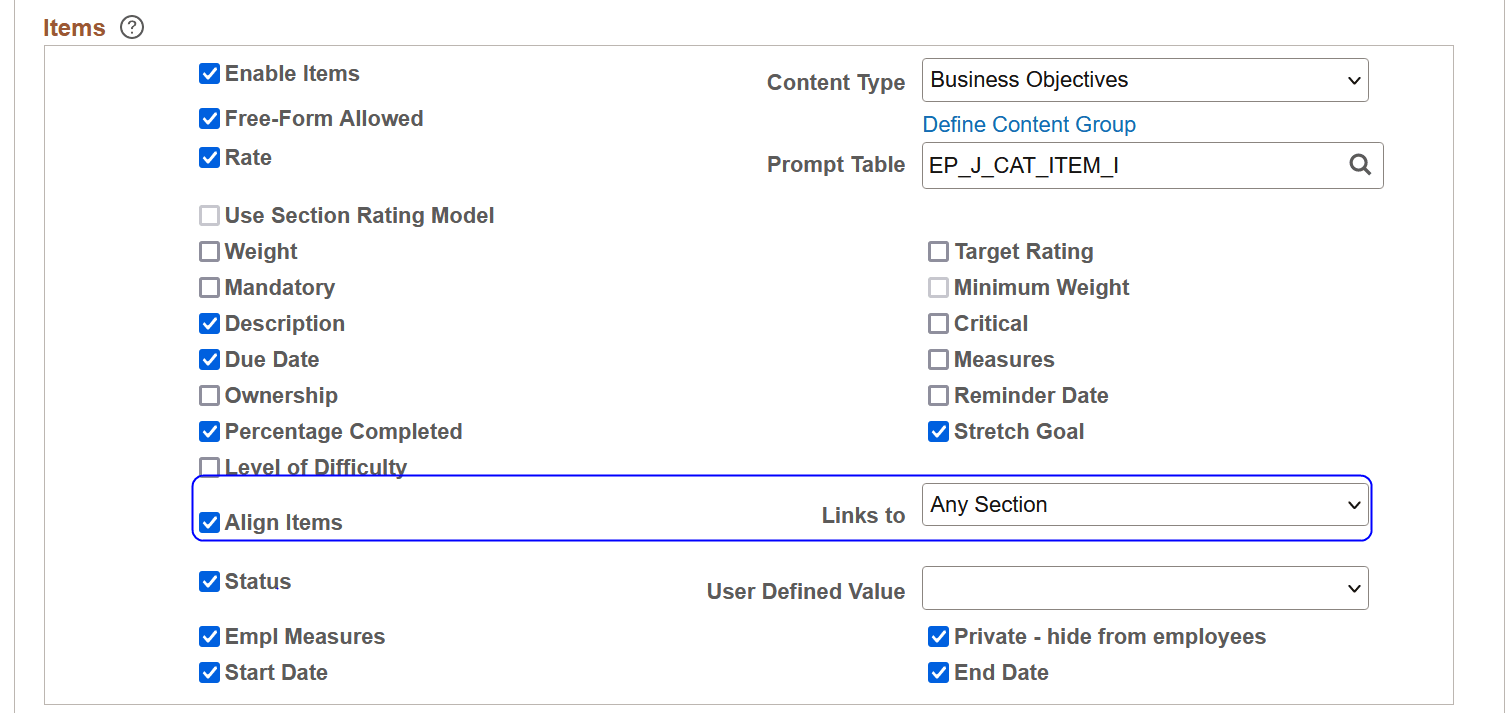

  3. If the section special processing is Business Objectives on the Section Definition Page, then the Align Items and Links To fields are available and are used to connect an item in a performance document section to an appropriate business objective document item for the business objective plan.

  2. When section special processing = Business Objectives and the Links To field is set to Any Section, the system will display the items from all sections in the associated business objective document that have the same content type as the ePerformance document section from which you are aligning items.

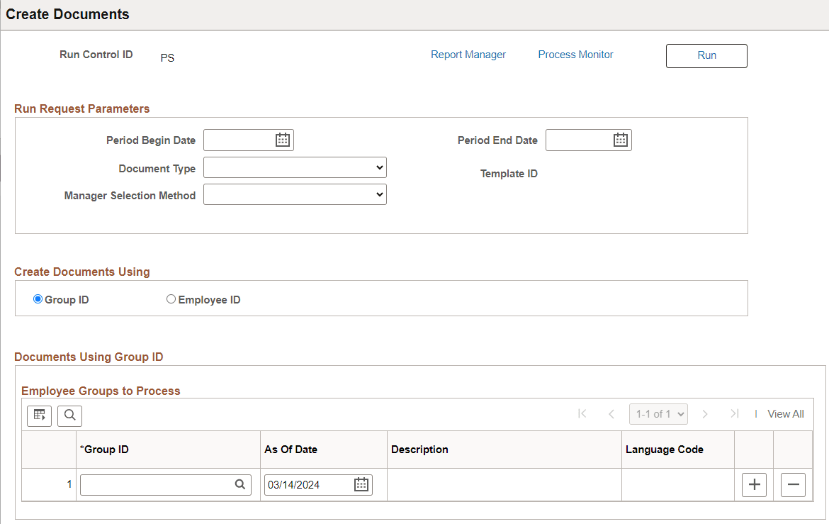

Administrators can create performance documents for employees by group ID or employee ID in a batch process on the Create Documents Page.
This example illustrates the Create Documents page for administrators.

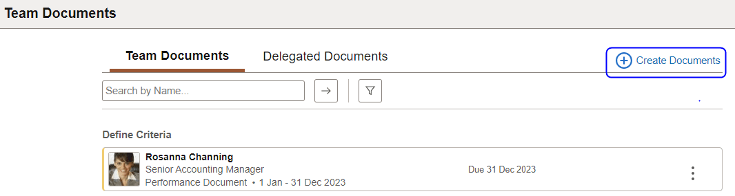

Managers can create performance documents for their direct/indirect reports in Fluid Manager Self-Service, if enabled by document type.
This example illustrates the Create Documents button on the Team Documents page for managers.

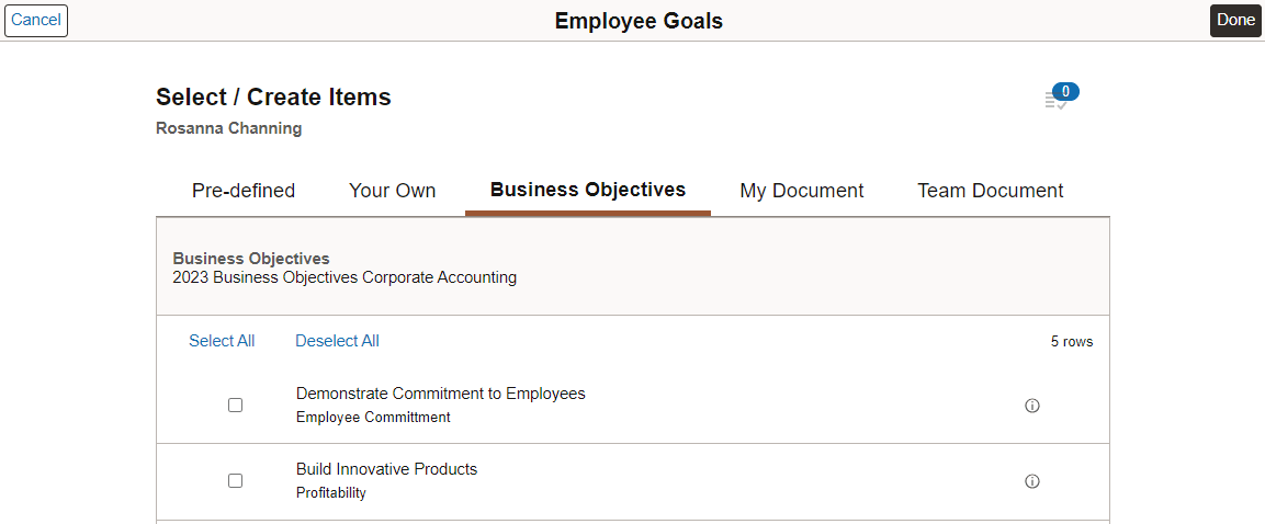

  1. If section special processing = Business Objectives, then the Business Objectives tab is available in the section which will allow you to view the closest business objective page when adding items.
    This example illustrates the Select/Create Items - Business Objectives page.
    The Select/Create Items - Business Objectives page will display business objectives from the listed published business objective document where the section and content type match between the ePerformance document and the business objective document.

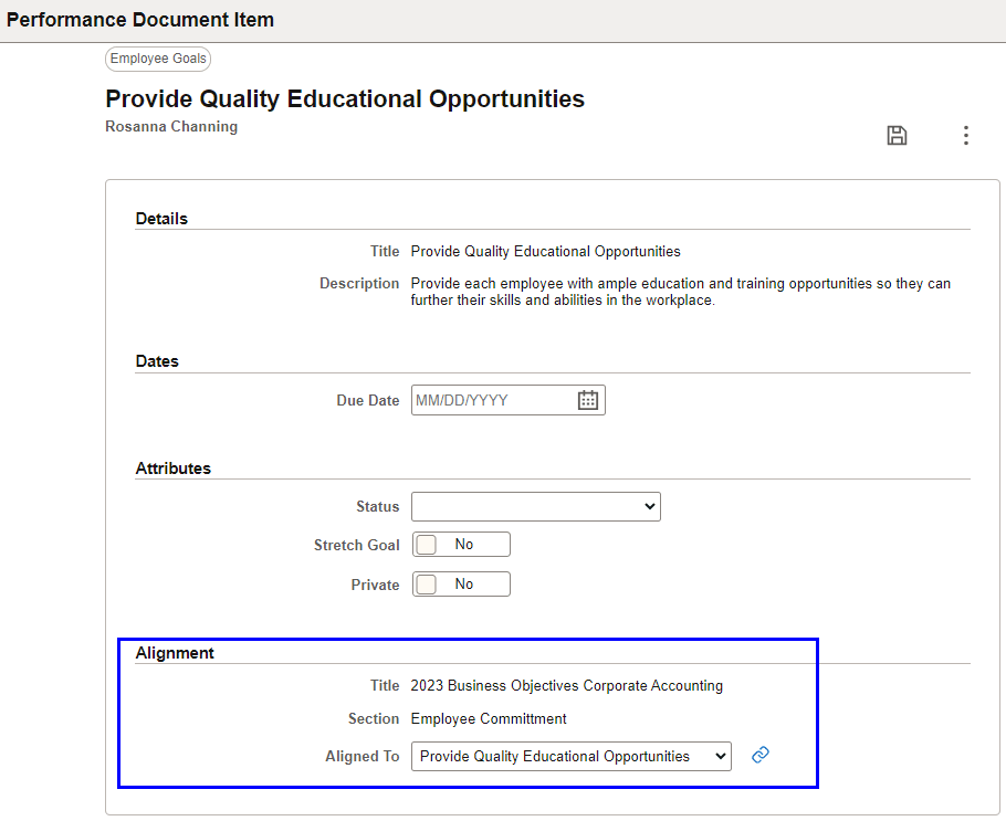

  2. On the Performance Document Item page where you can update the item, the Alignment section is displayed (when the section is set up to align items).
    The Aligned To drop-down lists all business objectives from the section used for alignment on the template. The objectives will come from the business objective document displayed in the Title field.
    Once an item is selected, the Section field value is updated to show the section of the selected business objective in the specified business objective document.
    The Chain icon is also available to show how the selected business objective aligns with other higher-level business objectives. When you copy the items, the alignment from the business objective document will also be copied. The alignment cannot be updated unless the alignment was blank at the time of the copy.
    This example illustrates the Performance Document Item page.

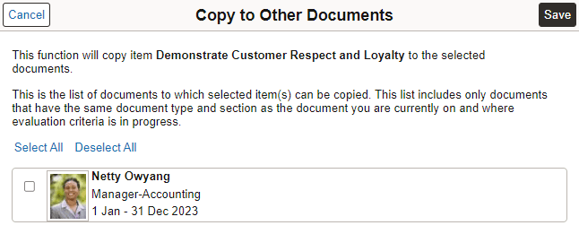

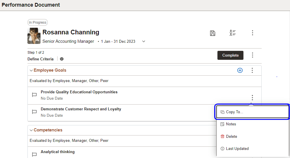

  3. In addition to editing items, the manager can use the Copy To action from the More Actions menu to copy items from the employee’s performance document to other documents that the manager owns. This functionality is only available to documents in the Define Criteria, Checkpoint or Finalize Criteria step, and not in the Evaluation step.
    This example illustrates the Copy To action on the Performance Document page to be used by managers to copy business objectives to other documents.
    Copy business objectives to other documents on the Performance Document page
    Select one or more documents to which the specified item is copied.
    This example illustrates the Copy to Other Documents page.

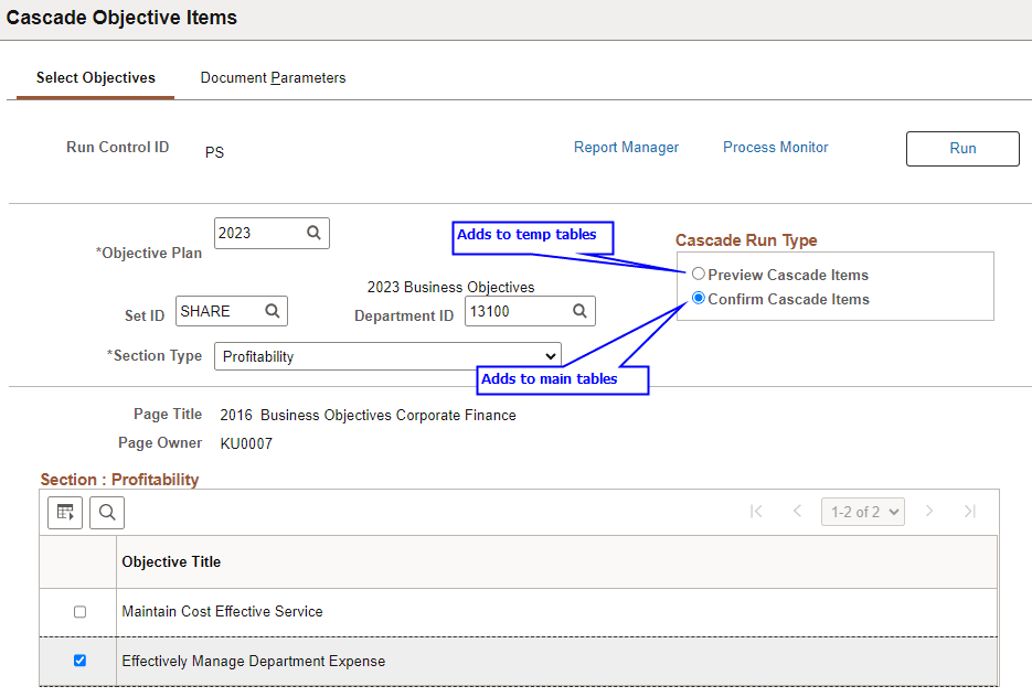

Cascade is a process (EP_CASCADE) that pushes items from a business objective document into one or more performance documents. The process is available to administrators as well as managers (if enabled on the ePerformance Installation - Objective Pages page).
At one time, items from a particular section of a business objective page can be cascaded. To cascade items from other sections or other business objective page, the administrator must run the process again with different values. This process is mass insertion of items into documents.
Business objectives can be cascaded to performance documents only if the content type of the selected sections (both business objective page and performance document) is the same. Since a document can have the same content type in more than 1 section, the administrator must specify the name of the section where items need to be cascaded/copied.
On the Select Objectives Page, the administrator will define the information pertaining to the business objective page. Once an objective plan and a department are selected, all sections of the business objective page matching the criteria will be displayed. Selection of section will further display its item in the grid. One or more items can be selected for cascade.
This example illustrates the Cascade Objective Items - Select Objectives page for administrators.

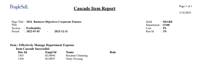

Since pushing of these items into the documents is an irreversible process, 2 run types are available: Preview Cascade Items and Confirm Cascade Items.
The Preview option gives an ability to see how the business objectives would look like in performance documents after cascade. In this mode, there will not be any database updates. A PDF report will be created, listing the business objectives to be cascaded and the documents where they WILL be cascaded. If for some reason a business objective cannot be cascaded to a document, the reason will be specified in the report as well. In this way, the administrator can visualize the result and can make changes to the selection criteria if needed. This option can be run any number of times. The data will be stored in temporary tables.
This example illustrates the Cascade Item Report listing documents to which business objectives to be cascaded.
In case of the Confirm option, items are added to the ePerformance item tables. The PDF report is again generated, and notifications are sent when Confirm Cascade Items is selected and completed. Second run of the Confirm option process for the same selection will not result any data if overwrite is not allowed, and will have the same result as previous if overwrite is allowed.

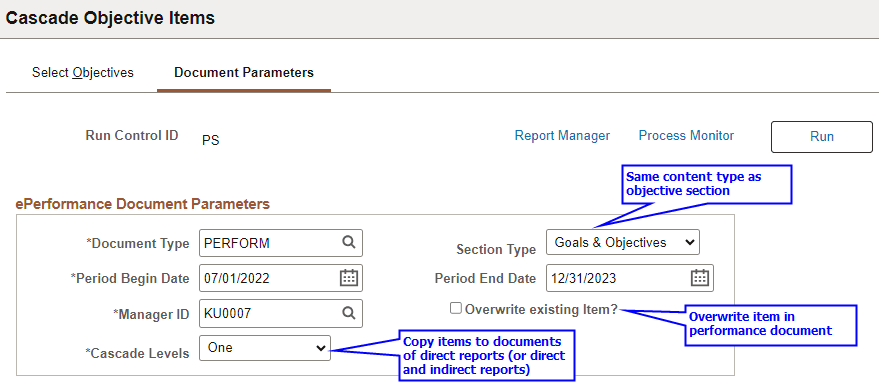

Once business objectives are selected, use the Document Parameters Page to enter selection criteria for performance documents. The Section Type drop-down field will list all sections that have the same content type as that of the business objective section. Documents owned by the specified manager created between entered period begin date and end date will be selected. If the period end date is blank, then documents created up until today will be included.
Selecting the Overwrite existing item check box will overwrite the common items in the documents (otherwise those items will be skipped on the document). This is another way of bringing in the changes made to business objectives after their insertion into performance document.
Review this example:
A business objective named Take professional training every Quarter has Update Skills aligned to it on the business objective document of the IT Dept. This item got copied over to performance document of employee K1 on 1/15/2023. On 6/23/2023, the alignment on the business objective got changed to another item Enroll in OU training. This change has not trickled into the performance document. When items from this business objective document is cascaded next time and the Overwrite option is enabled, then this change will also be copied. If the Overwrite option is not selected, then the process will skip this item as it is already present in the document.
In this example, it is recommended to select the Overwrite option for the cascade process.

The Cascade Levels field determines if the selected business objectives need to be cascaded to the manager’s direct reports only or indirect reports also. Select One for direct reports only. Select All to include both direct and indirect reports all the way down in the chain.
Cascade items are treated like mandatory items where item details cannot be edited on the performance document. Cascade item on a document, if copied to other documents will still be treated as a cascade item on other documents.

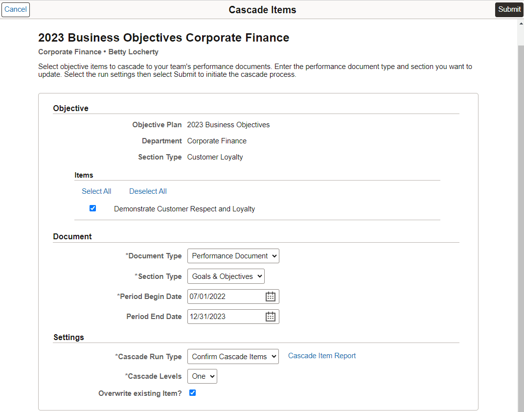

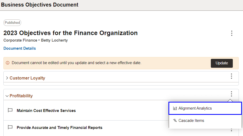

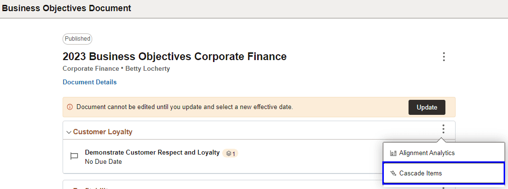

Managers can also cascade items to performance documents if the Allow Managers or Alternate Editors to cascade items check box is selected on the ePerformance Installation - Objective Pages Page. Instead of a run control page, they run the cascade process directly from their business objective documents in Fluid. From the section where they want to run the process, select Cascade Items.
This example illustrates the Cascade Items action on the Business Objectives Document page to be used by managers to cascade business objectives to performance documents.
Cascade items on the Business Objectives Document page by managers
On the Cascade Items Page, select the items to be cascaded, and specify the criteria of the team documents to where items will be cascaded.
Select to run the process using the Preview or Confirm option. If this is the first time to run the process, Preview is the only option. A status message appears next to the business objective document’s section title, showing when the process is submitted or completed. Upon completion, use the Cascade Item Report link to review the results in the PDF report.
Select the cascade level and specify if the process should overwrite items that already exist in target performance documents.
This example illustrates the Cascade Items page.
Specify parameters for cascading business objectives on the Cascade Items page by managers

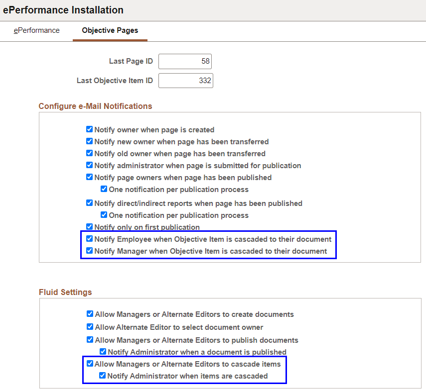

Cascade Notifications: If the notification options are enabled, then notifications will be sent out after the completion of the Confirm option process.
This example illustrates the ePerformance Installation - Objective Pages page.

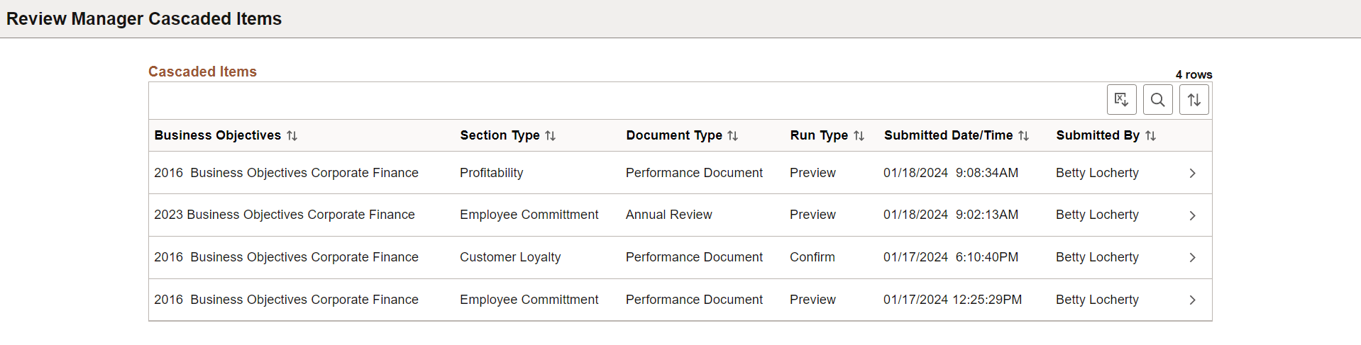

Administrators can review a list of item cascading processes that are run by managers on the Review Manager Cascaded Items Page.
This example illustrates the Review Manager Cascaded Items page.

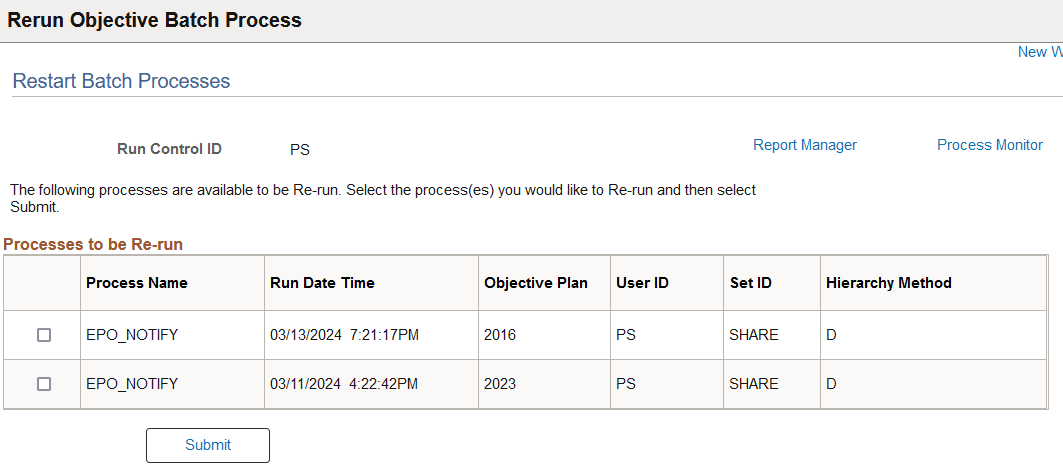

If for any reason the process fails, the administrator can use the Restart Batch Processes Page to restart the process.
8. Restart Batch Process
There are 2 batch jobs automatically submitted to the Process Scheduler when business objective documents are published. They are the Batch Notifications job with publication, and the Syndication job when republishing a business objective document. Use the Restart Batch Processes Page to restart those batch processes if they fail.
This example illustrates the Restart Batch Processes page.

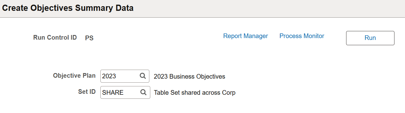

9. Create Business Objectives Summary Data
Note that:
  1. The EPO_OBJ_EXT (Create Objectives Summary Data) process gathers the data that is used to display the alignment chart report. This process should be run whenever business objective items are associated with ePerformance documents and the Item alignment changes.
    This example illustrates the Create Objectives Summary Data page.
    See Also Create Objectives Summary Data Page.
  2. Access the chart report from the icon on the business objective page at the Section level.
    The chart displays the number of items that are aligned to a business objective for a section.
    This example illustrates the Alignment Analytics action on the Business Objectives Document page to be used by managers to view business objective alignments for employees.
    Review alignment analytics on the Business Objectives Document page by manager
