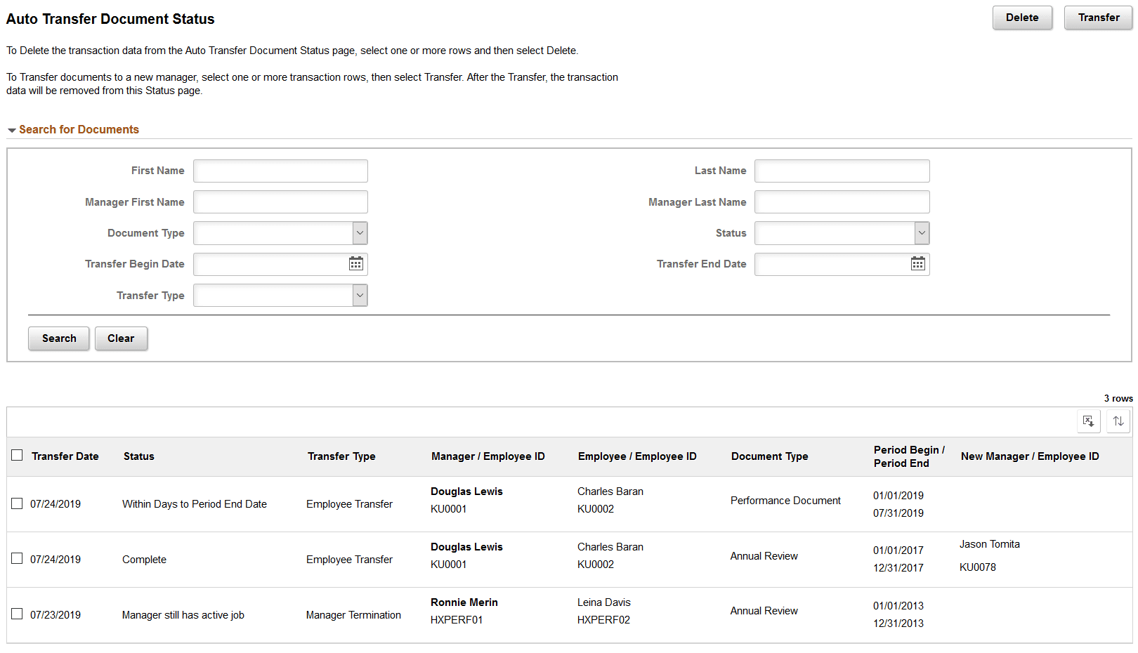

Auto Transfer Document Status Page
Use the Auto Transfer Document Status page (EP_XFER_LOG_FL) to view the status summary of in-progress documents that were eligible for automatic transfer.
Navigation:
Click the title of the default home page and select Talent Administrator from the list that appears.
Click the Performance Management Tile to open the Performance Management application start page, and click Auto Transfer Document Status from the navigation collection.
This example illustrates the fields and controls on the Auto Transfer Document Status page.
As an administrator, you can view the status summary of documents that were processed for the Automatic Document Transfer feature.
Field or Control Description
Delete
Click to delete selected rows (for example, for documents that were transferred automatically) from the search result.
Transfer
Click to transfer selected documents manually. Choose a manager to whom to transfer the selected documents on the Select a Manager page (HR_PSEL_FLU).
Search for Documents
Use this section to refine the search result by entering one or more of these search values: the employee’s first and last names, current manager’s first and last names, document type, transfer type, transfer status, and time period during which the document transfer took place.
Transfer Type
Select to refine the search result by document transfer type. Values are Employee Transfer and Manager Termination.
The selected transfer type determines the list of available transfer statuses in your search.
When you access this page initially, the system displays results for all transfer types.
Status
Select to refine the search result by document transfer status. Valid values are:
Complete: The document was transferred to the new manager successfully. This status is applicable to all access types.
Manager still has active Job: The document was not transferred because the terminated manager had multiple jobs. He or she was terminated from one job, and still had other active jobs in the system. This status is applicable to all access types and the Manager Termination transfer type.
No Manager found: The document was not transferred because no manager was found for the terminated manager or the employee with the job change. This status is applicable to By Department Manager ID and By Part Posn Mgmt Dept Mgr ID access types.
No Reports To found: The document was not transferred because either the Reports To field value was missing from the job data of the terminated manager, or the Reports To field of the employee's new position was blank on the Position Data - Description page. This status is applicable to the By Reports To Position access type.
No Supervisor found: The document was not transferred because no supervisor was found for the terminated manager or the employee with the job change. This status is applicable to By Supervisor ID and By Part Posn Mgmt Supervisor access types.
Dept has no previous manager: The document was not transferred because the employee's department, which didn't have a manager specified previously, had a new manager. The system could not identify from whom the document to transfer if the previous department manager was not available. This status is applicable to the Employee Transfer transfer type.
Reports To field is blank: The document was not transferred because the Reports To field was blank on the PeopleSoft Human Resources Manage Positions: Position Data - Description Page. This status is applicable to the By Reports To Position access type.
Within Days to Period End Date: The document was not transferred because the date when manager change occurred was less than the number of days before the document’s period end date. This status is applicable to the Employee Transfer transfer type.
Past Period End Date: The document was not transferred because the date when manager change occurred was after the document’s period end date, and the option to transfer documents with manager change past the period end date was disabled. This status is applicable to the Employee Transfer transfer type.
Download to Excel (Download to Excel)
Click to download the displayed search result to an .xls file.
Sort (Sort)
Click to sort the displayed search result by column header.

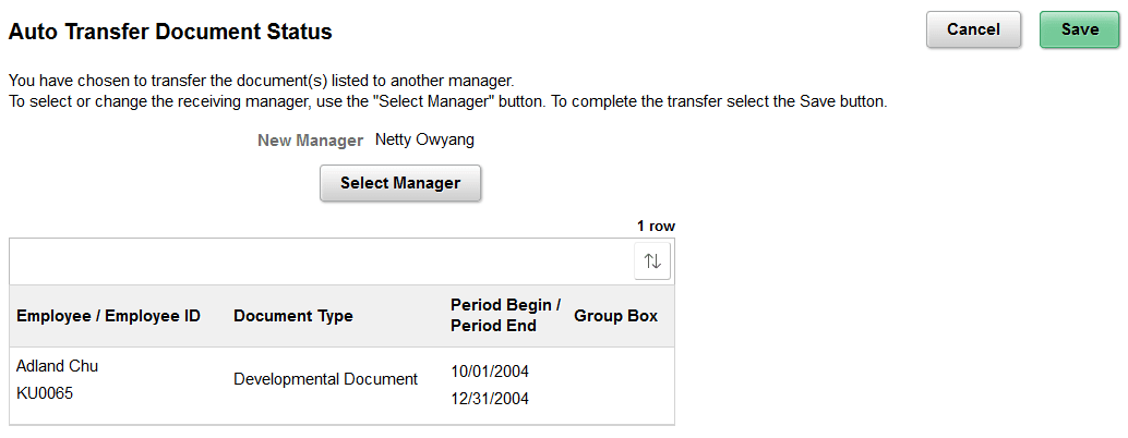

Auto Transfer Document Status Page (Confirm Transfer)
Use the Auto Transfer Document Status page (Confirm Transfer) (EP_AUTOXFER_CON_FL) to confirm and complete the document transfer.
Navigation:
Select one or more documents to be transferred and click the Transfer button.
This example illustrates the fields and controls on the Auto Transfer Document Status page (confirm transfer).
Auto Transfer Document Status - Select Manager page
The selected manager is listed for the document transfer. Reselect a different manager if needed.
Click Save to complete the transaction.
