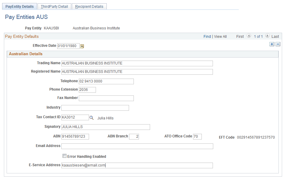

Pay Entities AUS Page
Use the Pay Entities AUS page (GPAU_PYENT_EXT) to define Employer related details to be used in Superannuation reporting with the Australian authorities
Navigation:
Setup HCM, and then Product Related, and then Global Payroll & Absence Mgmt, and then Framework, and then Organizational, and then Pay Entities AUS
Field or Control Description
Trading Name
Enter the trading name of the organization that makes the payment.
Note: If the Pay Entity itself is the Payer, then this value will be the Pay Entity Trading Name, else from the field Organization Name as defined in the “Third Party Detail” tab.
Registered Name
Enter the registered name of the organization that makes the payment.
Tax Contact ID
Contact details of pay entities authorized representative.
Signatory
Authorised Signatory
ABN
Australian Business Number (ABN) of the employer/ organisation that makes the payment.
ABN Branch
Pay entities Individual ABN branch details.
ATO Office Code
Enter Australian Taxation Office (ATO) code.
EFT Code
Enter the Electronic Fund Transfer (EFT) code
Error Handling Enabled
Select the check box if the organisation is capable of decoding the member registration/contribution error responses generated by the target system
E-Service Address
Enter the e-service url, if you have selected the Error Handling Enabled check box.

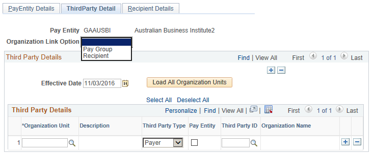

Third Party Detail Page
Use the Third Party Detail page (GPAU_PYENT_EXT1) to define entities that would be acting as a Payer for your organization.
Navigation:
Organisation Link Option
Select from the following options:
Pay Group
Recipient
Organisation Unit
Select the organisation unit. List of selection will be based on the value selected in Organisation Link Option field.
Note: You can define only one row for each Third Party Type for an Organization Unit selected
Third Party Type
Payer
Clr House
Pay Entity
Select this checkbox if the selected organization acts as the Pay Entity.
Third Party ID
Select the Third Party ID.
Note: On selecting Pay Entity check box, this field will be disabled.
Organisation Name
The name of the “Payer” that will be printed in the “SuperStream” report.
If a clearing house needs to be added as the third party (‘Recipient’ as Organization Link Option):
  • Under Pay Entities AUS component, load all the recipients and assign the clearing House as a third-party for the recipients which contribute to Clearing House.
  • Set the third Party type to ‘Clr House’ to select a clearing house.
  • If third-party type is ‘Clr House’, but the ‘Third-party ID’ selected does not have Clearing House flag selected on the third-party definition, then the configuration of clearing house is ignored.
  • The recipient can be either General or Individual.
  • ‘Load All Organization Units’ will load the recipients which are configured to be of ComSuper/SuperStream reporting format under ‘Deduction Recipients Aus’ component.
With this configuration, EFT process will club all the payments of the recipients (with Super Reporting Format set to SuperStream File Format or Com Super File Format in Deduction Recipients AUS component) in to one and make the payment to Clearing House.
If a clearing house needs to be added as a third party (‘Pay Group’ as Organization Link Option):
  • Under Pay Entities AUS component, load all the Pay Groups and assign the clearing House as a third-party for the Pay Groups which contribute to Clearing House.
With this configuration, EFT process will club all the payments of the recipients (with Super Reporting Format set to SuperStream File Format or Com Super File Format in Deduction Recipients AUS component) under the Pay Group with clearing House in to one and make the payment to Clearing House. Any payments to a recipient with other Super Reporting Formats will continue to be paid to the corresponding recipient.

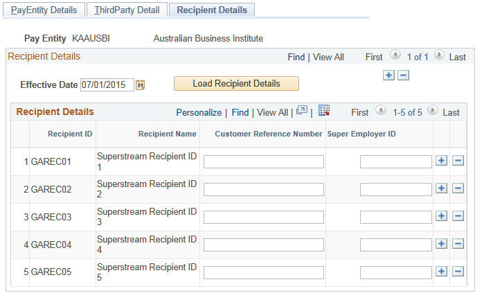

Recipient Details Page
Use the Recipient Details page (GPAU_PYENT_EXT2) to provide CRN/ Super Employer ID details of the recipient.
Navigation:
This example illustrates the fields and controls on the Recipient Details page. You can find definitions for the fields and controls later on this page.
Customer Reference Number
In the case of a BPAY payment, the payment reference number is the customer reference number as issued by, or on behalf of, the relevant superannuation entity.
Super Employer ID
Enter the Employer Identifier.

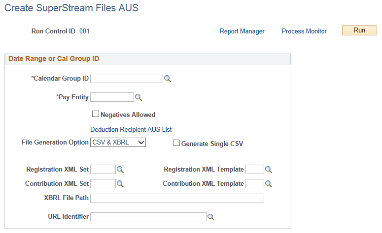

Create SuperStream Files AUS Page
Use the Create SuperStream Files AUS page (GPAU_RC_SS_REPORTS) to generate the CSV file containing the Superannuation registration/contribution details for the employees in your organization.
Navigation:
Global Payroll & Absence Mgmt, and then Authority Correspondence, and then Create SuperStreamt Files AUS
Calender Group ID
Choose the Calender Group. The calendar group should be finalized and the banking process completed.
Pay Entity
Choose the Pay Entity.
Negatives Allowed
This value is checked to denote that the entity receiving the CSV files is capable of handling any negative values present in the CSV file being generated to report the Superannuation contribution details for the employees in your organization. This value cannot be edited.
Deductions Recipients AUS List
Filter the output results can by selecting specific Deduction Recipients.
File Generation Option
One CSV file for every unique combination of Sender/Receiver/Payer/Payee as determined by the program is generated based on your organization’s data setup at the Deduction Recipient AUS page and the Pay Entity AUS page and the specified run control parameters. Two other file generation options are also provided to generate XBRL file or both XBRL and CSV files;.XBRL Only and CSV & XBRL.
Generate Single CSV
Generate Single CSV is displayed when the file generation option is either CSV Only or CSV & XBRL. Generate Single CSV is unchecked by default. Checking this box would create a single CSV file for all the deduction recipients. Unchecking creates one CSV file for each deduction recipient and lodgment reference umber combination.
When XBRL Only or CSV & XBRL options are chosen multiple fields are displayed to capture the XML framework details required to create XBRL file. XBRL File Path provided should be a path accessible to the process scheduler server. The XBRL file created is posted to the path provided in URL Identifier

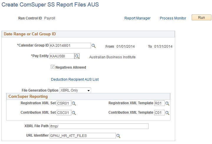

Create ComSuper SS Report Files AUS Page
Use the Create ComSuper SS Reports AUS page (GPAU_RC_COM_REPORT) to generate SAFFE (.CSV or .XBRL) file containing the Superannuation registration/contribution details for the employees in your organization.
Navigation:
Global Payroll & Absence Mgmt, and then Authority Correspondence, and then Create ComSuper SS Report Files AUS
Create ComSuper SS Report Files - CSV format
Create ComSuper SS Report Files - XBRL format
Calender Group ID
Pay Entity
Negatives Allowed
Generate Single CSV
ComSuper Reporting
This group box appears when XBRL Only or CSV & XBRL options are chosen. This captures the XML framework details required to create XBRL file. XBRL File Path provided should be a path accessible to the process scheduler server. The XBRL file created is posted to the path provided in URL Identifier.
