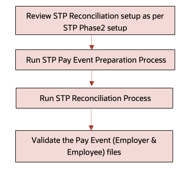

To run the reconciliation report, perform the following:
  1. Run the Payroll
  2. Run the STP Payroll Event Prep AUS
  3. Run the STP Reconciliation AUS
STPII Flow diagram
STP Flow diagram
This process flow is applicable only for Phase 2 STP solution.

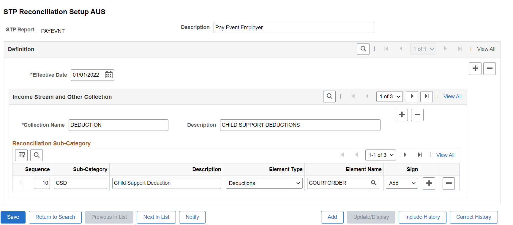

Use the STP Reconciliation Setup AUS (GPAU_STP_RCAT) to map any customized Earnings/Deductions that are used instead of the PeopleSoft delivered Earnings/Deductions that are being reported in STP. It is possible to change the mapping data based on the payroll elements if needed, as it will be prepopulated with data.
Navigation:
Set Up HCM , and then Product Related, and then Global Payroll & Absence Management, and then Reports, and then STP Reconciliation Setup AUS
This example illustrates the fields and controls of the STP Reconciliation Setup AUS page.
Field or Control Description
Effective Date
The date from which the setup is valid.
Note: The effective date should be the same as that of STP Phase 2 setup.
Collection Name
The name of the Tuple that are being used for reporting
Sequence
The Sequence Order of the Field on the Report.
Sub-Category
The name of the facts that are being used for reporting under the respective Tuple.
Description
The description of the sub-category.
Sign
Values can be:
  • Add: Specify whether the corresponding field adds to the collection Total.
  • Subtract: Specify whether the corresponding field deducts from the collection Total.
Element Type
Displays the Element Type. Values can be:
  • Earning
  • Deduction

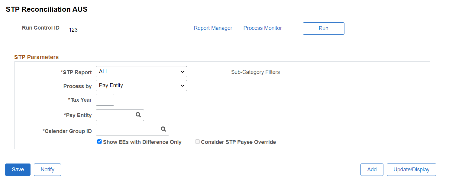

Use the STP Reconciliation AUS page (GPAU_STP_REC_RCTL) to generate the reconciliation reports that can be used to:
  • Compare values reported in the PAYEVNTEMP file to the actual payroll result values.
  • Ensure that the values reported in PAYEVNT and PAYEVNTEMP are the same.
Navigation:
Global Payroll & Absence Management, and then Authority Correspondence , and then STP Reconciliation AUS
This example illustrates the fields and controls of the STP Reconciliation AUS page.
STP Report
Select the required report type from the following options:
  • All
  • Pay Event Employer
  • Pay Event Employee
Tax Year
The year for which tax year this Payroll Event Reconciliation (Pay Event Employer & Pay Event Employee) needs to be processed.
Pay Entity
The Pay Entity for which data should extracted. Define the pay entity for which the employer would like to include the payroll data for Payroll Event Reconciliation (Pay Event Employer & Pay Event Employee).
Calendar Group ID
Enter the Calendar Group ID for which the employer would like to consider the payroll results for Payroll Event Reconciliation (Pay Event Employer & Pay Event Employee).
Employee ID & BAL GRP
If the user would like to run the process only for one employee, then "Processing Option" should be set to Employee ID and the Employee ID should be entered in the relevant field.
Group List
If the user would like to run the process for a group of employees, then "Processing Option" should set to Group List and the Group List ID should enter in the relevant field.
Streams
If the user would like to run the process for a given payroll, stream, then "Processing Option" should be set to Streams and the Stream Number should enter in the relevant field.
Period End Date
Select the option as Period End Date, if user wants to run the process for a list of CAL_RUN_IDs having the same Period End Date. On selecting this option, two fields, Period End Date and Period ID are displayed.
Show EEs with Difference Only
Select the check box if you want the report to contain only the employees with differences. Leave the check box blank if you want to include all the employees in the report. By default, this check box is selected.
Consider STP Payee Override
Select the check box if you want the report to include the Payee Override entered by the users. By default, this check box is not selected.
Sub-Category Filters
Sub-Category filters will enable if the STP Report is not “ALL”, If you want the report to contain only the selected sub-category against Pay Event Employer or Employee, you need to select the respective sub-category from the filters. By default, sub-category check box is selected for “STP Report” Pay Event Employer and Pay Event Employees.

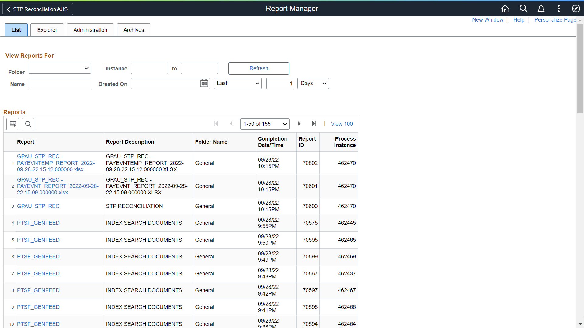

You can access the output reports from the Report Manager.
This example illustrates the fields and controls on the Report Manager page.
Report Manager
Click on the report hyperlink to view the report and verify the reconciliation output.

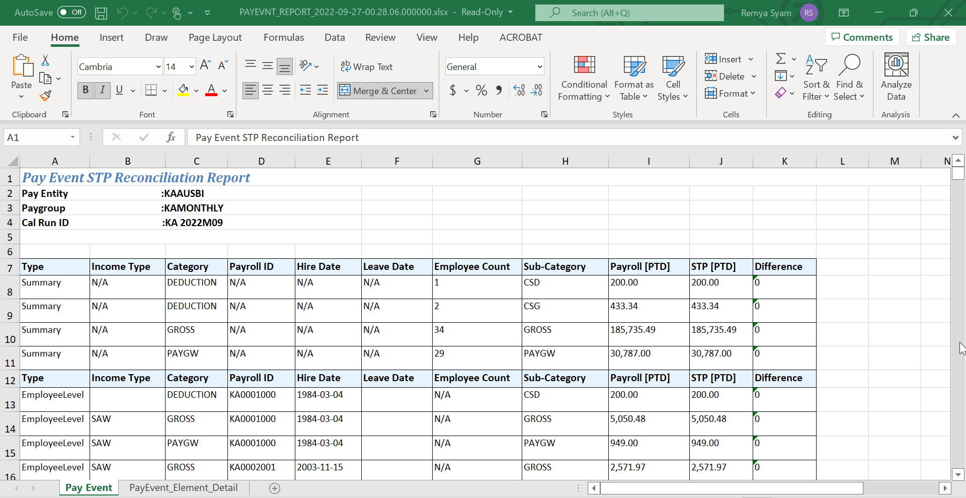

STP Reconciliation Report output are in the form of xls. The delivered BI publisher reports are:
  • Pay Event Employer Report
  • Pay Event Employee Report

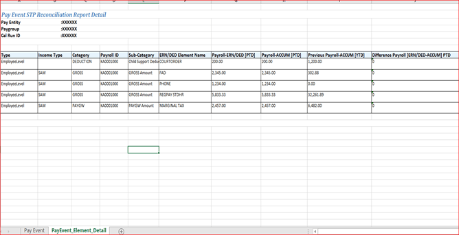

The Pay Event Employer Report will have two sheets Pay Event Sheet and Pay Event Element Detail sheet.
  • Pay Event Employer Sheet provides the comparison of the Payroll accumulator results against the STP results. There are in turn two sections in this sheet, the Summary and Employee Level grouped based on the category and sub-category defined in the reconciliation setup.
  • Pay Event Employer Element Detail provide the details of the employee that got processed in the payroll along with the Previous YTD values so that customer can easily verify the YTD values that is getting reported STP by adding up the current PTD and previous YTD for each element. The elements in this sheet are grouped based on the category and sub-category defined in the reconciliation setup.

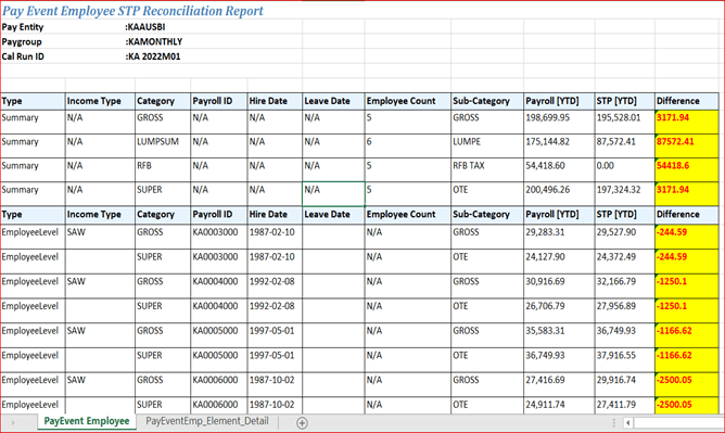

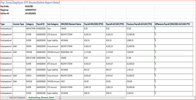

The Pay Event Employee Report will have two sheets Pay Event Sheet and Pay Event Element Detail sheet.
  • Pay Event Employee Sheet provides a comparison of the Payroll accumulator results against the STP results. There are in turn two sections in this sheet, the Summary and Employee Level grouped based on the category and sub-category defined in the reconciliation setup.
  • Pay Event Employee Element Detail provide the details of the employee that got processed in the payroll along with the Previous YTD values so that customer can easily verify the YTD values that is getting reported STP by adding up the current PTD and previous YTD for each element . The elements reported in this sheet are grouped based on the category and sub-category defined in the reconciliation setup.

Pay Event Employer Report - Sample Output
Pay Event Employer Element Details Report - Sample Output
Pay Event Element Details
Pay Event Employee Report - Sample Output
A red highlight indicates the difference between payroll and STP outputs.
Pay Event Employee Element Detail - Sample Output
Pay Event Employee Element Detail Report
