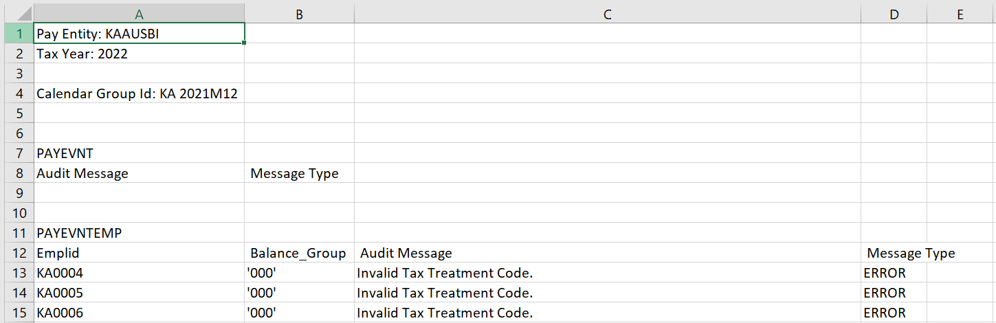

Two validation log files will be generated:
  • STP Validation Log: This validation log includes the conditional validation on two or more tags and for any missing mandatory information. A CSV file is generated with the list, and they are classified as ‘error’ or ‘warning’.
    STP Validation Log
    STP Validation Log
  • Data conversion log for employees: This log lists employees for whom the data has been converted.This validation log includes details like Employee ID, Balance Group and Calendar Group ID.

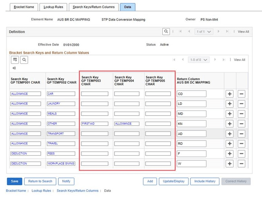

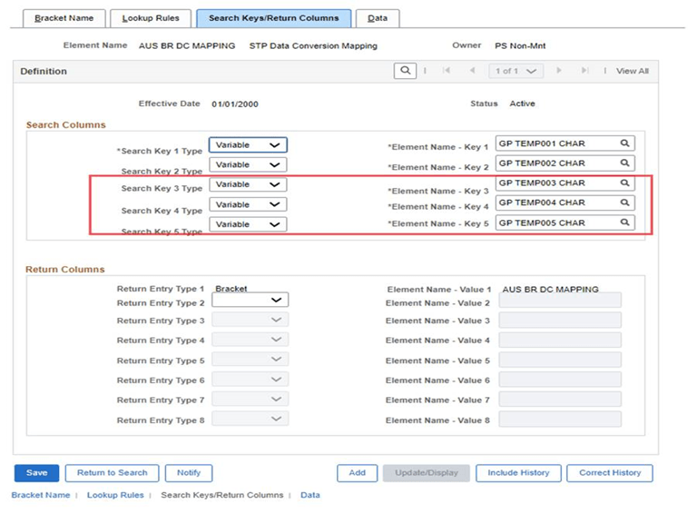

    The search keys GP TEMP001 CHAR and GP TEMP002 CHAR are used to search with Category and Sub-Category. If the allowance category in Phase 1 is 'Other', the three additional search keys GP TEMP003 CHAR, GP TEMP004 CHAR, and GP TEMP005 CHAR are used to search with the description of the sub-category.
    Search Keys
    Search Keys
    Since there is a limitation that the number of allowed characters is only 18 for a search key, three fields have been enabled to add the description.
    Data
    Data Mapping
    The search keys GP TEMP003 CHAR,GP TEMP004 CHAR, GP TEMP005 CHAR should be populated only when the allowance sub-category is selected as “Other” in STP Phase 1.

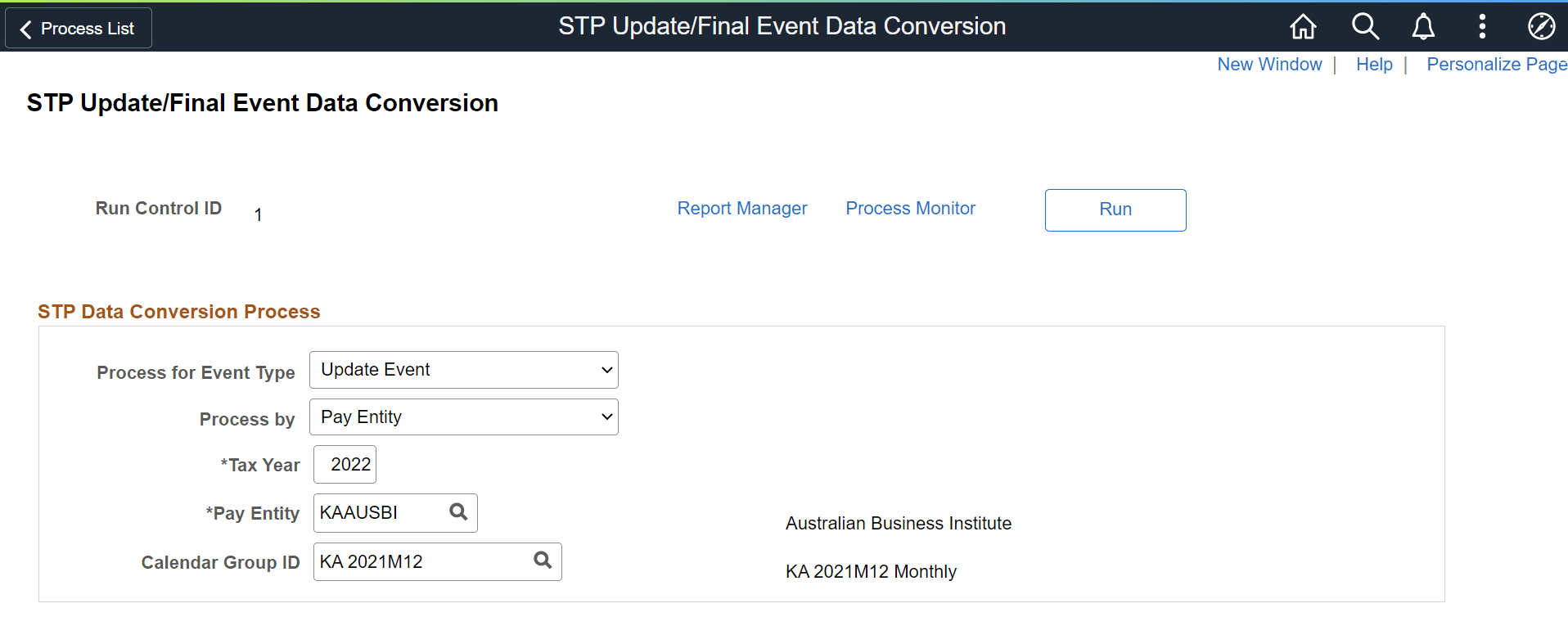

This example illustrates the Data Conversion Processing for Update Event.
STP Update Event page

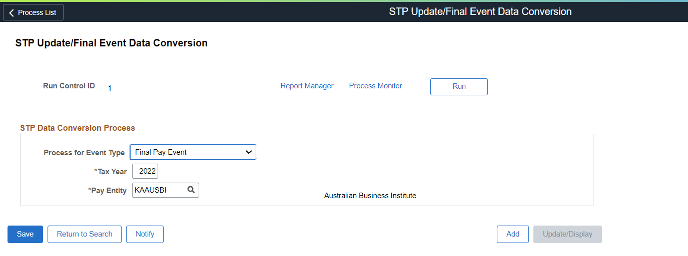

This example illustrates the Data Conversion Processing for Final Event.
STP Final Event page
Field or Control Description
Process for Event Type
Select whether to run the conversion process for an Update Event or a Final Pay Event.
Only the Tax Year and Pay Entity fields are considered if Final Pay Event is selected, as the data needs to be converted for the selected Pay Entity regardless of calendars, other parameters are not taken into account.
Note: In the case of final pay event, the conversion process should be run only for the terminated employees prior to transition.
Process by
Select the required value for which the STP data conversion process to be performed.
Available options are:
  • Pay Entity
  • Employee ID
  • Group List
  • Pay Group
  • Period End Date
  • Streams
These values are enabled based on the run control parameters, whereas Tax Year and Pay Entity are key fields.
