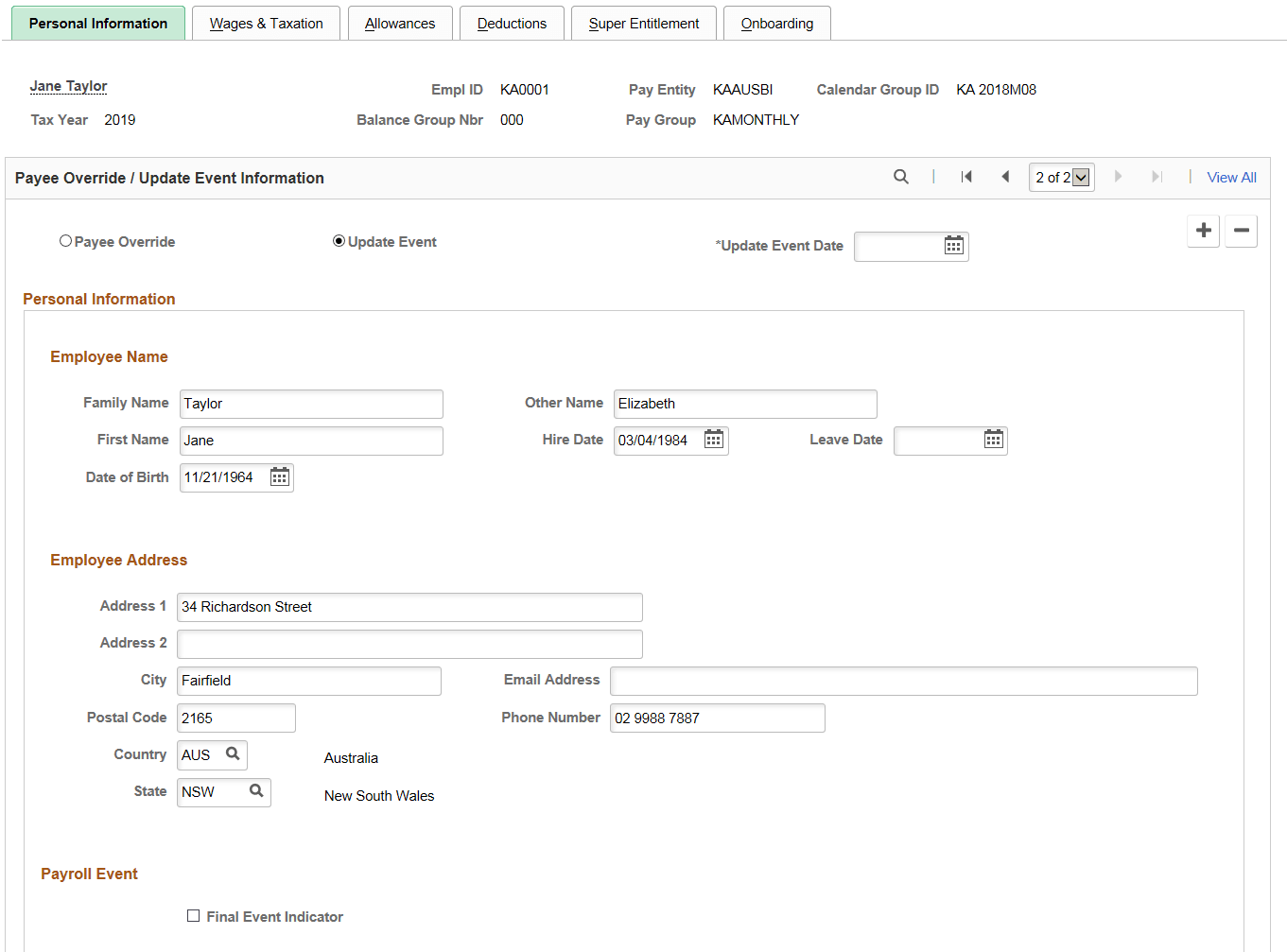

Personal Information Page
Use the Personal Information page (GPAU_STP_PERS_DTL) to update the personal information of the employee. Based on the selected calendar group id for which the amendments to be done, the system populates the values submitted in the original file.
Navigation:
Global Payroll & Absence Mgmt , and then Payee Data , and then Single Touch Payroll AUS , and then STP Update Event AUS , and then Personal Information
This example illustrates the Personal Information Page.
Field or Control Description
Employee details are fetched from PS_GPAU_STP_HR_STG table and if user updates any data, the same will consider while reporting Update Event.
Final Event Indicator
This is reported per employee, per payroll ID as part of the employee record. User may submit via pay event or through update event. Users need to select the check box to report this indicator in output file.

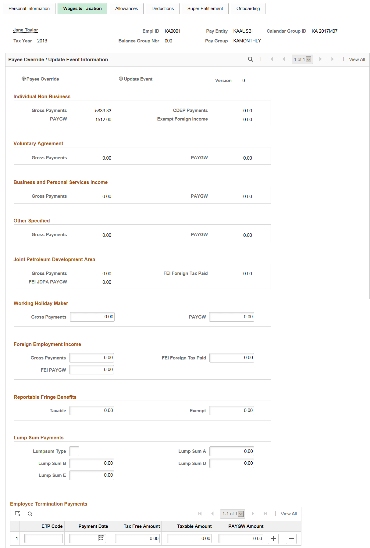

Wages & Taxation Page
Use the Wages & Taxation page (GPAU_STP_WAGES_TAX) to update the earnings information of the employee. Based on the selected calendar group id for which the amendments to be done, the system populates the values submitted in the original file.
Navigation:
Global Payroll & Absence Mgmt , and then Payee Data , and then Single Touch Payroll AUS , and then STP Update Event AUS , and then Wages & Taxation
This example illustrates the Wages & Taxation Page.
Wages and Taxation page
Employee Termination Payments
Employee Termination Payments Codes and Values can iterate up to a maximum of 25 times. Thus, once the user made use of 25 field values, add button will disable from the grid.

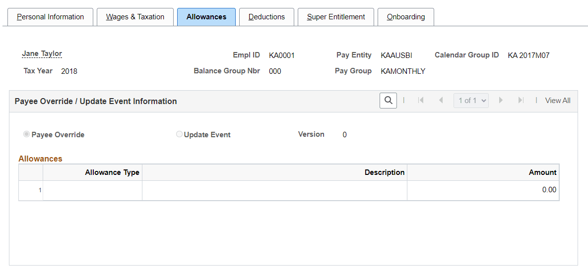

Allowances Page
Use the Allowances page (GPAU_STP_ALLOW) to update the allowance related information of the employee. Based on the selected calendar group id for which the amendments to be done, the system populates the values submitted in the original file.
Navigation:
Global Payroll & Absence Mgmt , and then Payee Data , and then Single Touch Payroll AUS , and then STP Update Event AUS , and then Allowances
This example illustrates the Allowances Page.
Allowances page
Employee Allowance Codes and values can be iterated to maximum of 30 times. Thus, once the user enters 30 field values, disables the add button from the grid. The Allowances information are derived from PS_GPAU_STP_ALLOW record.

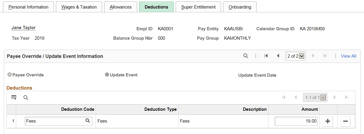

Deductions Page
Use the Deductions page (GPAU_STP_DED) to update deductions such as Union Fees & Workplace Giving of the employee. Based on the selected calendar group id for which the amendments to be done, the system populates the values submitted in the original file.
Navigation:
Global Payroll & Absence Mgmt , and then Payee Data , and then Single Touch Payroll AUS , and then STP Update Event AUS , and then Deductions
This example illustrates the Deductions Page.
Deductions page
The page can hold maximum of 4-deduction categories. The Employee deduction codes and Values and can be iterated up to a maximum of four times. Thus, once the user enters four values, the add button will be disabled from the grid. The Deduction information is derived from PS_GPAU_STP_DED record.

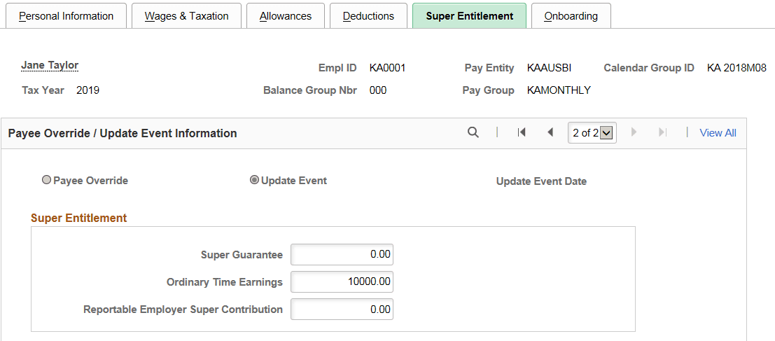

Super Entitlement Page
Use the Super Entitlement page (GPAU_STP_SUPER_ENT) to update Superannuation Contribution Tuple data. Based on the selected calendar group id for which the amendments to be done, the system populates the values submitted in the original file.
Navigation:
Global Payroll & Absence Mgmt , and then Payee Data , and then Single Touch Payroll AUS , and then STP Update Event AUS , and then Super Entitlement
This example illustrates the Super Entitlement Page.

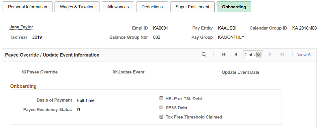

Onboarding Page
Use Onboarding Page page (GPAU_STP_ONBRD) to view the Employee TFN onboarding information. This is a read only page and cannot be updated as part of Update Event process.
Onboarding page is editable for Payee Override process.
Navigation:
Global Payroll & Absence Mgmt , and then Payee Data , and then Single Touch Payroll AUS , and then STP Update Event AUS , and then Onboarding
This example illustrates the Onboarding Page.
Onboarding page

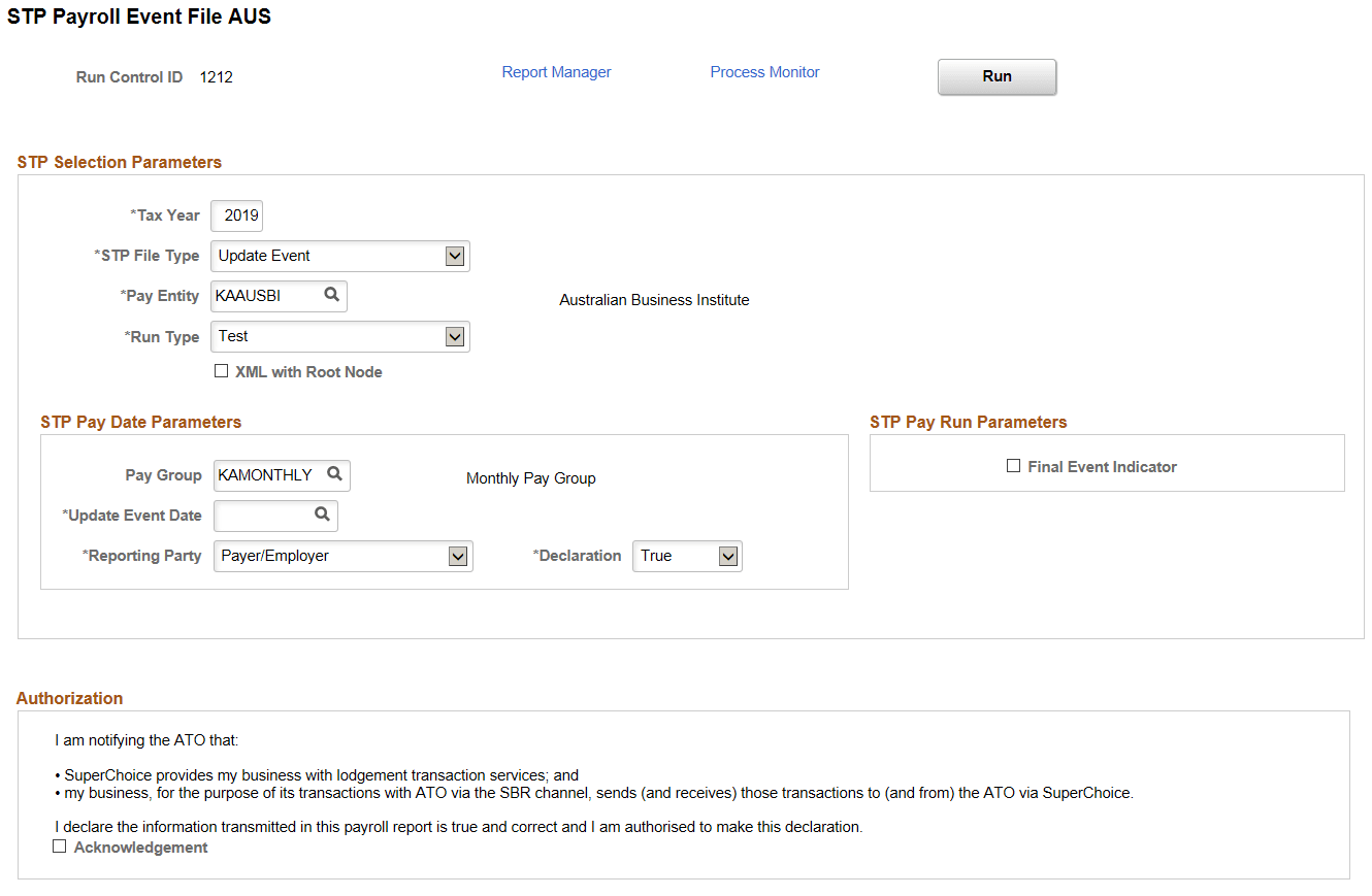

STP Payroll Event File AUS Page
Use the STP Payroll Event File AUS page (GPAU_STP_RUNCTL) to generate or update Pay Event files. For more information on how to generate pay event file, see Generating Pay Event File
Navigation:
Global Payroll & Absence Mgmt , and then Payee Data, and then Single Touch Payroll AUS, and then STP Update Event AUS
This example illustrates the fields and controls on the STP Payroll Event File AUS Page. You can find definitions for the fields and controls later on this page.
Tax Year
Enter the Fiscal Year for which the update event is processed. For example, enter, "2017" for 2016-17 Tax Year.
STP File Type
Select the STP file type. Available options are:
  • Pay Event
  • Update Event
Pay Entity
Select the pay entity, for which the employer would like to generate Payroll Event (PAYEVNT & PAYEVNTEMP).
Run Type
Select the Run Type. Available options are:
  • Test: Use the Test option for testing files to ensure they are complied with the reporting norms before running the final submission.
  • Production: Use the Production option when you are submitting the final file for payroll processing.
XML with Root Node
Select the checkbox if you want to generate a temporary XML file with Root Node, which can be viewed in a browser, with the ability to export to excel.
Note: This option is for easier validation. The Final XML file to be submitted to the authorities should be generated without a Root node, which is a non-standard XML structure and thereby does not open properly in a normal browser; instead, the file can be opened and reviewed in text editors, such as Notepad, Notepad++ or Text Pad.
Pay Group
Select the paygroup if you want to generate the file for a particular pay group.
For example, if there are pay groups for Weekly and Monthly, employers would be able to generate the separate file for each pay group.
Update Event Date
Select the date on which the update event is carried out for the employees.
Reporting Party
Select the Reporting Party. Available options are:
  • Payer/Employer
  • Intermediary
Declaration
Select the option as True or False to indicate whether the terms stated in the Declaration Text have been accepted or declined.
An employer is required to make a declaration to the ATO, that they have provided all the information for each employee for a financial year, by providing the finalization indicator as a part of an employee’s Single Touch Payroll report. Select this check box if you want to include this indicator in the final output.
