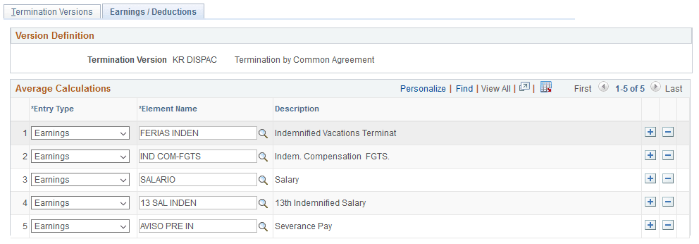

Earnings/Deductions Page
Use the Earnings/Deductions page (GPBR_TERM_VERSION) to associate earnings and deductions with a corresponding termination version.
Navigation:
Set Up HCM, and then Product Related, and then Global Payroll & Absence Mgmt, and then Terminations, and then Termination Version Setup BRA, and then Earnings/Deductions
This example illustrates the fields and controls on the Earnings/Deductions page.
Field or Control Description
Entry Type
Select whether you are entering an Earnings or a Deduction element.
Element Name
Select the element to associate with this termination version.
