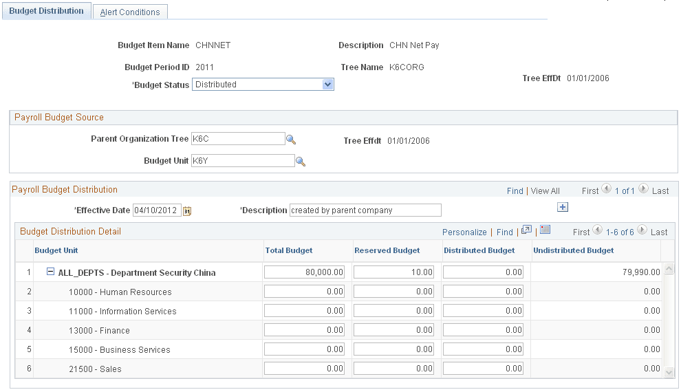

Use the Budget Distribution page (GPCN_BDGT_DT) to distribute the payroll budget to the organization tree, either from parent company to child companies or from child companies to departments.
Navigation:
Set Up HCM, and then Product Related, and then Global Payroll & Absence Mgmt, and then Reports, and then Budget Distribution CHN, and then Budget Distribution
This example illustrates the fields and controls on the Budget Distribution page.
Payroll Budget Administrators must choose aBudget Item Name, Budget Period ID, and Tree Name to identify the budget to distribute.

Payroll Budget Distribution
Add effective-dated records to make changes to a Distributed status budget or to add distribution detail records to a Planned budget.
Budget Distribution Detail
Field or Control Description
Budget Unit
The system displays the primary node from the parent organization tree for the specified budget unit (in this example, ALL_DEPTS). If subunits exist for that tree node, the system also displays them (in this example, 10000, 11000, 13000, and so on).
Total Budget
Enter the total payroll amount that you want to budget for the unit. If subunits appear, you can also enter how much of the total to allocate to each subunit. The system verifies that the sum of the subunits does not exceed the total budget.
Reserved Budget
Enter the amount to reserve or set aside for contingencies in the payroll budget.
Distributed Budget
Enter the amount that you want to distribute to each sub-company or sub-department.
Undistributed Budget
The system calculates and displays the undistributed budget, or budget balance, as follows:Total Budget - Reserved Budget - Distributed Budget
