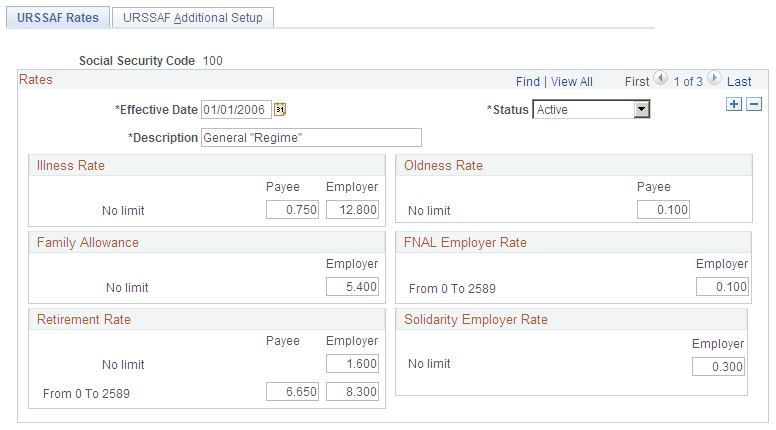

URSSAF Rates Page
Use the URSSAF Rates page (GPFR_URS_RATES) to review the URSSAF rates for illness, old age, family benefits, FNAL Employer, and Retirement rates.
Navigation:
Set Up HCM, and then Product Related, and then Global Payroll & Absence Mgmt, and then Social Security / Insurance, and then URSSAF Rates FRA, and then URSSAF Rates
This example illustrates the fields and controls on the URSSAF Rates page. You can find definitions for the fields and controls later on this page.
URSSAF Rates page
Field or Control Description
Illness Rate
Displays the illness contribution rates for Payee and Employer.
Family Allowance
Displays the rate for family allowance.
Retirement Rate
Displays the two contributions towards the retirement rate.
The employer pays a rate based on the entire funding base. This is displayed opposite No Limit.
The second contribution, paid by both payee and employer, is applied to a funding base limited to Ceiling A.
Oldness Rate
Displays the contribution rate for old age benefits.
FNAL Employer Rate
Displays the rate that applies to a funding base limited to Ceiling A.
Note: FNAL contributions not limited to Ceiling A are maintained on the Variables By Category page. Only FNAL contributions limited to Ceiling A are maintained on the URSSAF Rates page.
Solidarity Employer Rate
Displays the solidarity contribution rate.
Several of the contribution sections on this page display the comment No limit. This means that the contributions for each section are not based on an earning ceiling. They are calculated from the entire funding base, with no limit.
