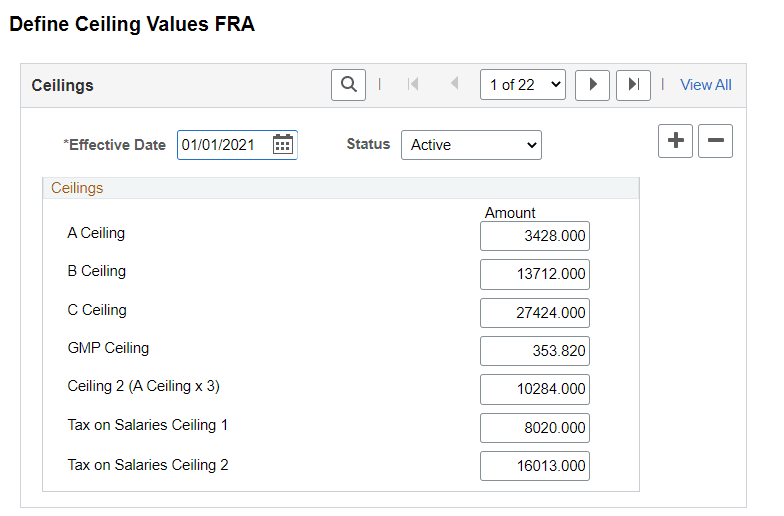

Define Ceiling Values FRA Page
Use the Define Ceiling Values FRA page (GPFR_CEILINGS) to view the different ceiling values used to calculate the funding bases for the URSSAF, ASSEDIC, AGIRC/ARRCO, and contingency funds contributions.
You can change the values of the ceilings here to comply with changing laws.
Navigation:
Set Up HCM, and then Product Related, and then Global Payroll & Absence Mgmt, and then Addl Rates, and then Ceilings, and then Values, and then Define Ceiling Values FRA
This example illustrates the fields and controls on the Define Ceiling Values FRA page. You can find definitions for the fields and controls later on this page.
The ceiling name appears in the column on the left. The current monetary values of each ceiling appear in the Amount column. The amounts for the ceilings are monthly amounts in euros.
Defining Ceilings for Amounts That Are Not Monthly
If a payee works only one week during the month, the payee has a segment period equal to one week in the month. You can prorate the ceiling using the number of days of the segment compared to the number of days in the monthly period.
