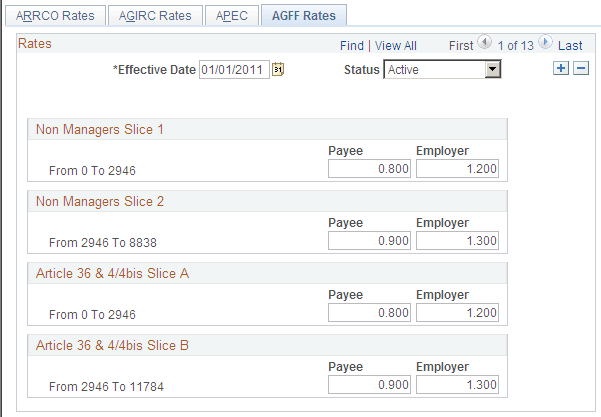

AGFF Rates Page
GPFR_AGFF_RATES
View the AGFF rates for employees (based on slices 1 and 2), and for Article 36 and managers (based on slices A and B).

AGFF Rates Page
Use the AGFF Rates page (GPFR_AGFF_RATES) to view the AGFF rates for employees (based on slices 1 and 2), and for Article 36 and managers (based on slices A and B).
Navigation:
Set Up HCM, and then Product Related, and then Global Payroll & Absence Mgmt, and then Addl Rates, and then Ceilings, and then Values, and then ARRCO/AGIRC Rates FRA, and then AGFF Rates
This example illustrates the fields and controls on the AGFF Rates page. You can find definitions for the fields and controls later on this page.
AGFF Rates page
Field or Control Description
Non Managers Slice 1
Displays the contribution rates that are paid on slice 1 for the AGFF contribution for both employer and payee. The non-managers slice 1 rate is applied to funding bases below the A ceiling.
Non Managers Slice 2
Displays the second rate of the AGFF contribution that is applied to non-management payees when the gross funding base is between the A ceiling and the A ceiling multiplied by 3, known as slice 2.
Article 36 & 4/4bis Slice A
Displays the AGFF contribution rates for slice A that is paid by payees categorized as Article 36 and Article 4/4 bis.
Displays the AGFF contributions rates for slice B that is paid by payees categorized as Article 36 and Article 4/4bis.
New AGFF contributions are not included in the reintegration fiscale (fiscal reintegration) calculation.

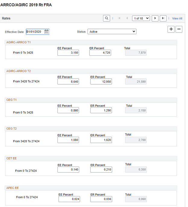

Pages Used to View and Maintain ARRCO and AGIRC Rates (from 2019)
The pages used to view and maintain ARRCO and AGIRC rates from 2019 onwards are listed in the below table.
ARRCO/AGIRC 2019 Rt FRA page
GPFR_AGIARR_RATES
To view the contribution rates for AGIRC-ARRCO. The PeopleSoft system is delivered with these rates, but you must maintain them when the government makes changes.
ARRCO/AGIRC 2019 Rt FRA Page
Use the ARRCO/AGIRC 2019 Rt FRA page (GPFR_AGIARR_RATES) to view the contribution rates for AGIRC/ARRCO. The PeopleSoft system is delivered with these rates, but you must maintain them when the government makes changes.
Navigation:
This example illustrates the fields and controls on the ARRCO/AGIRC 2019 Rt page. You can find definitions for the fields and controls later on this page.
ARRCO or AGIRC 2019 Rt FRA page
AGIRC-ARRCO T1
Displays the contribution rates for the pension fund for both employer and payee. The rates are expressed as a percentage of the payee's funding base.
The rate is applied to funding bases below the A ceiling. The A ceiling is populated from the Ceiling page.
Note: The field names From <lower limit> to <upper limit> dynamically appear based on the values entered on the Ceilings page
AGIRC-ARRCO T2
Displays the second rate of the pension fund contribution that is applied when the gross salary is between the A ceiling and the A ceiling multiplied by 8 (Base C), known as slice 2.
CEG T1
Displays the contribution rates for Contribution d’équilibre Générale for both employer and payee. The rates are expressed as a percentage of the payee's funding base.
It replaces the AGFF (Association for the management of the financing fund) and the GMP, and affects all employees.
CEG T2
Displays the second rate of Contribution d’équilibre Générale that is applied when the gross salary is between the A ceiling and the A ceiling multiplied by 8 (Base C), known as slice 2.
CET EE
Displays the CET (Contribution d'équilibre technique) contribution for payees on a gross funding base up to the C ceiling.
This contribution applies only to those employees with Salary above the Social Security Ceiling.
CET ER
Displays the CET (Contribution d'équilibre technique) contribution for employers on a gross funding base up to the C ceiling. This contribution applies only to those employees with Salary above the Social Security Ceiling
APEC EE
Displays the payee and employer contributions for managers with a funding base between the A and C ceilings. These contributions are paid monthly.
These rates apply to payees classified by Article 4/4 bis.
APEC ER
Displays the employer contributions for managers with a funding base between the A and C ceilings. These contributions are paid monthly.
