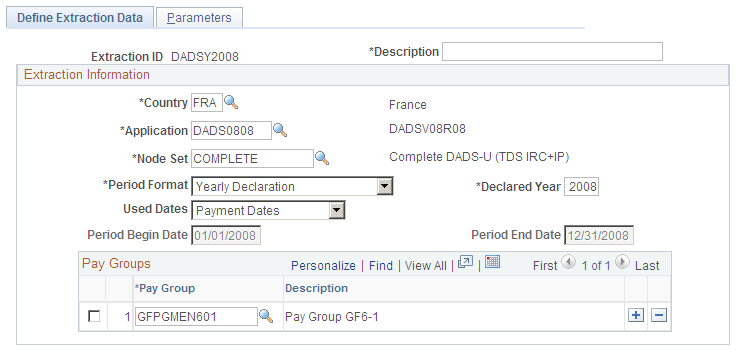

Define Extraction Data Page
Use the Define Extraction Data page (GPFR_AF_EXTR_DEFN) to define an Extraction ID.
Navigation:
Global Payroll & Absence Mgmt, and then Absence & Payroll Processing, and then Define Calendars, and then Define Extraction Data FRA
This example illustrates the fields and controls on the Define Extraction Data page. You can find definitions for the fields and controls later on this page.
Field or Control Description
Period Format
Values are Month, Other, Quarter, Year.
Declared Year
Specify a value in this field only when the Period Format is Year.
Used Dates
These are the processed payroll results whose Payment Dates or Payroll Segment End Dates are within the Declaration Period.
Period Begin Date and Period End Date
Specify the dates of the declaration period.
Pay Groups
You must enter at least one paygroup in this region of the page. If you have a single extraction ID for all of your paygroups, you should list them all in this region.

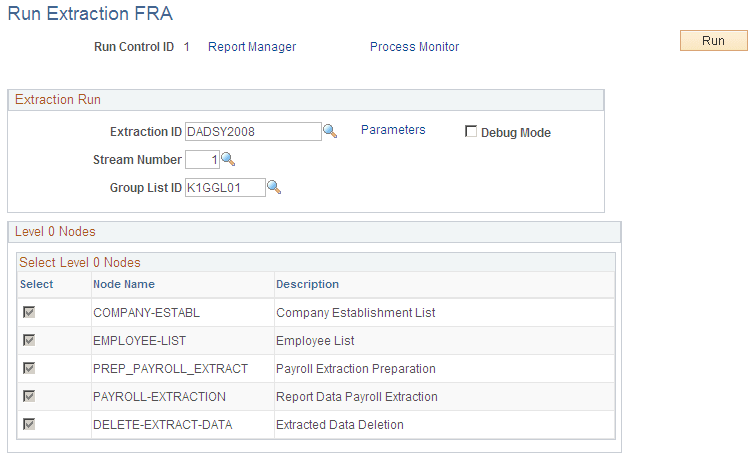

Run Extraction FRA Page
Use the Run Extraction FRA page (GPFR_AF_EXTR_RUN) to run the DADS extraction process.
Navigation:
Global Payroll & Absence Mgmt, and then Social Security / Insurance, and then Run Extraction FRA
This example illustrates the fields and controls on the Run Extraction FRA page (1 of 2). You can find definitions for the fields and controls later on this page.
This example illustrates the fields and controls on the Run Extraction FRA page (2 of 2). You can find definitions for the fields and controls later on this page.
When the process has successfully completed, the GPFR_AF_EXTRACT table is populated based on the Extraction ID definition and the Run Control parameters.
Extraction ID
Select an Extraction ID to determine which nodes are displayed.
Debug Mode
Select to generate a log file with the extraction run.
Group List ID
Use this option when you generate test files, or corrective files.
