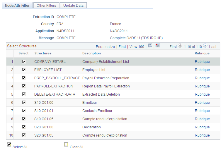

Node/Attr Filter Page
GPFR_DA_RUNCNTL
Select the structures and records you want to view.

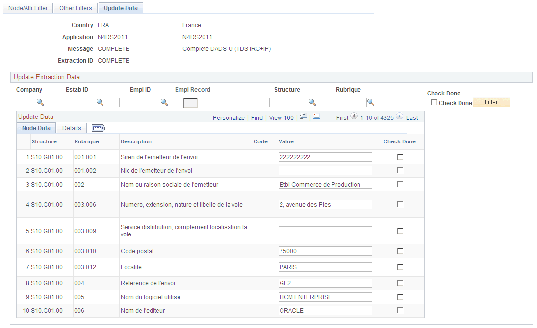

Update Data Page
GPFR_AF_UPDT_FINAL
Display the results related to the filters selected on the Node/Attr Filter and the Other Filters pages.
Use the Node/Attr Filter page (GPFR_DA_RUNCNTL) to select the structures and records you want to view.
Navigation:
Global Payroll & Absence Mgmt, and then Social Security / Insurance, and then Update Extraction Data FRA, and then Node/Attr Filter
This example illustrates the fields and controls on the Node/Attr Filter page. You can find definitions for the fields and controls later on this page.

Update Data Page
Use the Update Data page (GPFR_AF_UPDT_FINAL) to display the results related to the filters selected on the Node/Attr Filter and the Other Filters pages.
Navigation:
Global Payroll & Absence Mgmt, and then Social Security / Insurance, and then Update Extraction Data FRA, and then Update Data
This example illustrates the fields and controls on the Update Data page. You can find definitions for the fields and controls later on this page.
Update Data page
The Update Data page displays the results related to the filters you selected on the two first pages. You can then refine the data display by entering data in the Company, Estab ID (establishment ID), Empl ID, Empl Record, Structure, and Rubrique fields, then clicking the Filter button.
An export to Excel process is available, which shows the data displayed on the Update Data page.

Field or Control Description
Check Done
Select to indicate that the data has been checked. The Check Done field is automatically deselected if you re-run the process on the same data.
Node Data
The Node Data tab enables you to view the structure and record names and values used to produce the final file. However, the values displayed here come from the HCM application in a raw format. These values are formatted according to the DADS-U norm at the file generation step.
Details
The Details tab displays data that helps you check the extracted data, even though all of the displayed data is not required in each row of the final file. The Details tab displays the following information:
  • Company
  • Establishment ID
  • Employee ID
  • Employee Record Number
  • S41 Situation Begin Date
  • S41 Situation End Date
