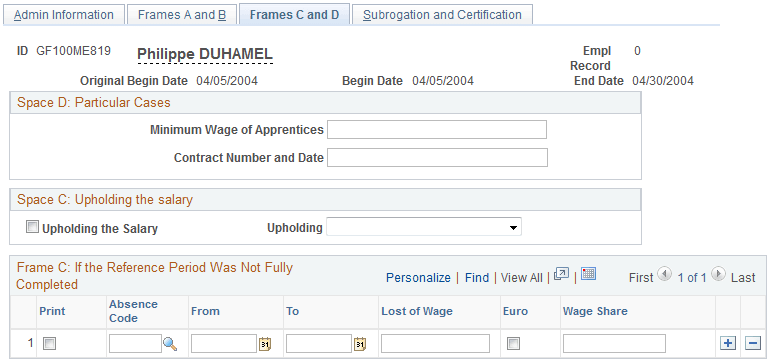

This example illustrates the fields and controls on the Accident/Illness Cert FRA - Frames C and D page. You can find definitions for the fields and controls later on this page.
Space D: Particular Cases
Field or Control Description
Minimum Wage of Apprentices
If the payee is an apprentice or trainee, enter the minimum wage for the category, level, or qualified employment in which the apprentice or the trainee would normally have been classified at the end of the training period or apprenticeship.
Contract Number and Date
If the payee is an apprentice, enter the number and date of the employment contract.
Space C: Upholding the Salary
Select this check box if you upheld the payee's salary.
Upholding
If you selected the Upholding the Salary check box, indicate the type of salary upholding: Integral Upholding or Partial Upholding.
Frame C: If the Reference Period Was Not Fully Completed
Frame C displays information only if the reference period was not completed because of the absence.
Print
Select to print the row.
Absence code
Displays the reason for the absence.
The following are valid values:
MAL: Illness.
MLD: Long-term illness.
AT: Industrial accident.
MAT: Maternity.
CHOM: Total unemployment.
FERM: Closing of establishment.
COP: Vacation pay.
ABS AUT: Authorized unpaid vacation.
SN: National service.
ABA: Authorized absence.
Other absence codes you have defined.
From
Displays the begin date of the leave.
To
Displays the end date of the leave.
Lost Wages
Displays the wages lost during the absence period, if the salary was not upheld for this absence.
Euro
This check box is selected automatically if the salary is paid in euros.
Wage Share
Displays the portion of the employee's contributions that were lost because of the leave.
