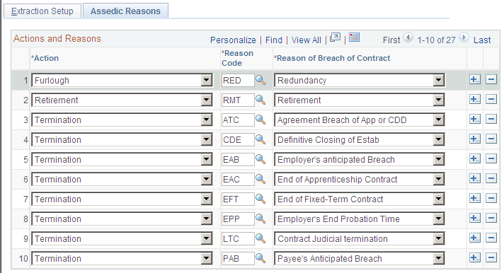

Assedic Reasons Page
Use the Assedic Reasons page (GPFR_TERM) to map actions/reasons that you set up to trigger termination processing to the termination reasons that will appear in a payee's ASSEDIC certificate.
Navigation:
Set Up HCM, and then Product Related, and then Global Payroll & Absence Mgmt, and then Terminations, and then Terminations FRA, and then Assedic Reasons
This example illustrates the fields and controls on the Assedic Reasons page. You can find definitions for the fields and controls later on this page.
Actions and Reasons
Use the fields in this group box to map the action-reason combinations that you have set up to trigger termination processing to the termination reasons that will appear in a payee's ASSEDIC certificate. List the actions and reasons that trigger termination processing in the columns under Action and Reason Code. List the corresponding ASSEDIC reasons in the fields under Reason of Breach of Contract.
Field or Control Description
Select an action and a reason code as defined in the Action Reason Table.
Compare the list of actions and reason codes on this page to those that you have set up to generate termination triggers in the Trigger Definitions (GP_TRGR_SETUP) component to make sure that they are the same. All actions and reasons that generate termination triggers should be listed here.
Note: It is important that you review all actions/reason codes you define for the termination process and map them to the corresponding ASSEDIC certificate termination reasons.
Reason for Breach of Contract
Select the reason for breach of contract that will appear in the ASSEDIC certificate when a payee is terminated using the action and reason shown in the corresponding Action and Reason Code fields.
