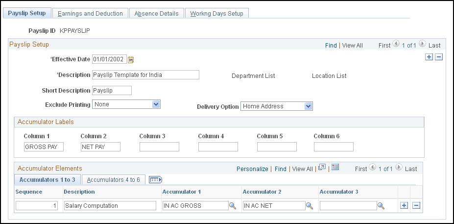

Payslip Setup Page
Use the Payslip Setup page (GPIN_PSLP) to set up delivery and print exclusion options, column headings (labels), and column contents (rows of accumulators).
Navigation:
Set Up HCM, and then Product Related, and then Global Payroll & Absence Mgmt, and then Payslips, and then Templates IND, and then Payslip Setup
This example illustrates the fields and controls on the Payslip Setup page. You can find definitions for the fields and controls later on this page.
Payslip Setup page
Field or Control Description
Payslip ID
You can attach a single template, by its ID, to multiple pay groups. You can attach multiple templates to a pay group. Each template is used in conjunction with a particular run type.
Exclude Printing
Select either Department orLocation to exclude departments or locations from the payslip print run. The corresponding link becomes active, so you can select from the department or location lists.
You can override the exclusion on the Process Payslip page before you run the print program.
Note: If you choose to enter a particular pay entity as the print option on the Process Payslip page and you have excluded a location that falls under that pay entity, it is not printed.
Delivery Option
Select an address type to receive printed payslips. You can select Department orLocation to mail the payslip to an internal address, or you can select Home Address or Mail Address to send it to an external address as recorded on the payee's personal data record.
You can override the selection made here on the Payslip Payee Override page, which is effective-dated; therefore, you can override the delivery option for a period of time if necessary.
See Overriding Payslip Delivery Options.
Column 1 toColumn 6
Enter the labels that you want to appear across the page on the printed payslip as the column headings for the accumulators. These column labels appear in the payslip region under the region heading Pay Summary.
Accumulators 1 to 3
Sequence
Enter a sequence number to set the order in which the accumulators appear. They appear in ascending order with the lowest number first.
Description
Enter a description of each accumulator row.
Accumulator 1, Accumulator 2, andAccumulator 3
Select the accumulators that you want displayed for the corresponding column.
For example, suppose you enter a description for sequences 1 and 2 as Current and YTD. If you also want to display quarter-to-date accumulated amounts, create a new row, give the new row the description QTD, and then select the accumulators that correlate to the column headings.
Accumulators 4 to 6
Accumulator 4, Accumulator 5, andAccumulator 6
Select the accumulators that you want displayed for the corresponding column. No Sequence orDescription fields exist because the same sequence number and description applies to all six accumulators in the row.

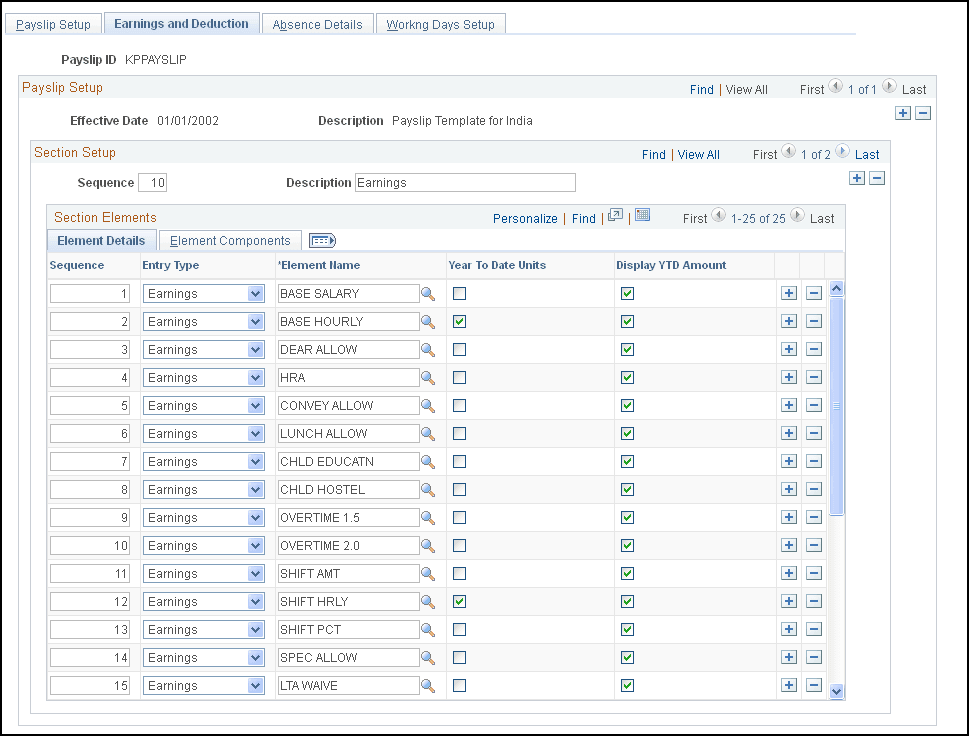

Earnings and Deductions Page
Use the Earnings and Deduction page (GPIN_PSLP1) to create sections of earnings and deductions, select from three description options, and set the element components that the payslip is to display.
Navigation:
Set Up HCM, and then Product Related, and then Global Payroll & Absence Mgmt, and then Payslips, and then Templates IND, and then Earnings and Deduction
This example illustrates the fields and controls on the Earnings and Deduction page. You can find definitions for the fields and controls later on this page.
Section Setup
Description
Descriptions appear as section headings in the payslip region under the heading Payment Details.
Element Details
Year To Date Units andDisplay YTD Amount (Display Year to Date Amount)
Select these check boxes if you want the year-to-date units and amounts for each element to appear in the Payment Details region under the heading Year to Date Values.
Element Components
Description Type
Select one of three descriptions to appear for each earning or deduction row in the Payment Details region of the payslip. Values are:
Custom: A text box appears for you to enter a description.
Description: The element's description as entered on the element's name page in its component.
Element Name: The element's name from its name page in its component. It also appears on the Elements Details tab.
Print Unit, Print Rate, Print Base, andPrint Percentage
Select the components of the element's calculation rule that you want to show for each earning or deduction in the sections.
You can select only the components in the element's calculation rule. For example, for an earning with a calculation rule of Unit Rate, only the Print Unit andPrint Rate check boxes are available for selection.
Note: Amount always appears; therefore, it is not an option here.
