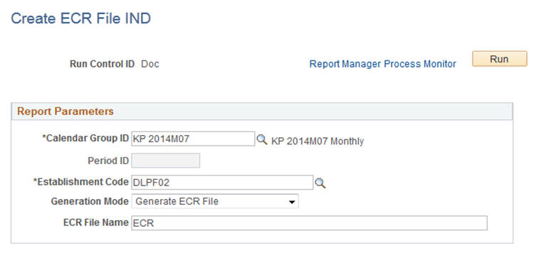

Create ECR File IND Page
Use the Create ECR File IND Page (GPIN_YE_F3A) to create Electronic Chellan Cum Return (ECR) text file.
Navigation:
Global Payroll & Absence Mgmt, and then Authority Correspondence, and then Create ECR File IND
This example illustrates the controls and definitions of Create ECR File IND page.
Field or Control Description
Calender Group
Select the calendar group ID that is associated with the pay run for which the ECR file needs to be created.
Establishment Code
Select the Establishment code for which you need to create the ECR file.
Generation Mode
Required flag for running the process in lead ECR data mode in generate ECR file mode.
ECR File Name
Mandatory field to generate ECR file mode.
The employees, who are covered under The Employee’s Provident Funds and Miscellaneous Provisions Act, 1952, are required to register their establishment on EPFO (Employee Provident Fund Organization) website for filing Electronic Chellan Cum Return (ECR). This return is a consolidated return for all the monthly and yearly returns (Form 5/10/12A, 3A and 6A) which the employees used to file earlier separately.

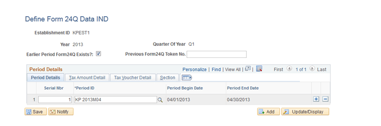

Define Form 24Q Data IND Page
Use the Acknowledgement Details page (GPIN_QT_F24Q_DTL) to define tax receipt data for Form 24Q quarterly return and statement.
Navigation:
Global Payroll & Absence Mgmt, and then Authority Correspondence, and then Define Form 24Q Data IND, and then Define Form 24Q Data IND.
This example illustrates the fields and controls on the Define Form 24Q Data IND page. You can find definitions for the fields and controls later on this page.
Serial Nbr (sequence number)
Enter a sequence number for each line item in the report.
Period ID
Select the period ID. The begin date and end date appear as soon as you select the period ID. A period ID is created for each reporting period, such as monthly or annual. If the reporting is monthly, create a period ID for every month for reporting purposes.

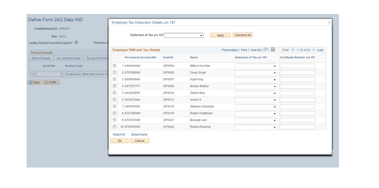

Select Tax Deduction u/s 197 Details in the Section tab.
The screenshot illustrates the Define Form 24Q Data IND Page that shows the employee tax deduction details under section 197.
Employee Tax Deduction Details US197
The Employee Tax Deduction Details u/s 197 lists all the employees’ PAN details for the selected establishment. For employees not having PAN and the field for the PAN is not updated, the PAN field is pre-populated with value PANAPPLIED and tax deduction at higher Rate. The Admin user has to enter the tax deduction details of employees for each and every period defined in Define Form24Q Data IND page. The tax deduction details and Define Form24Q Data IND pages need to be saved for the changes to take effect in Form24Q - Annexure I file.
