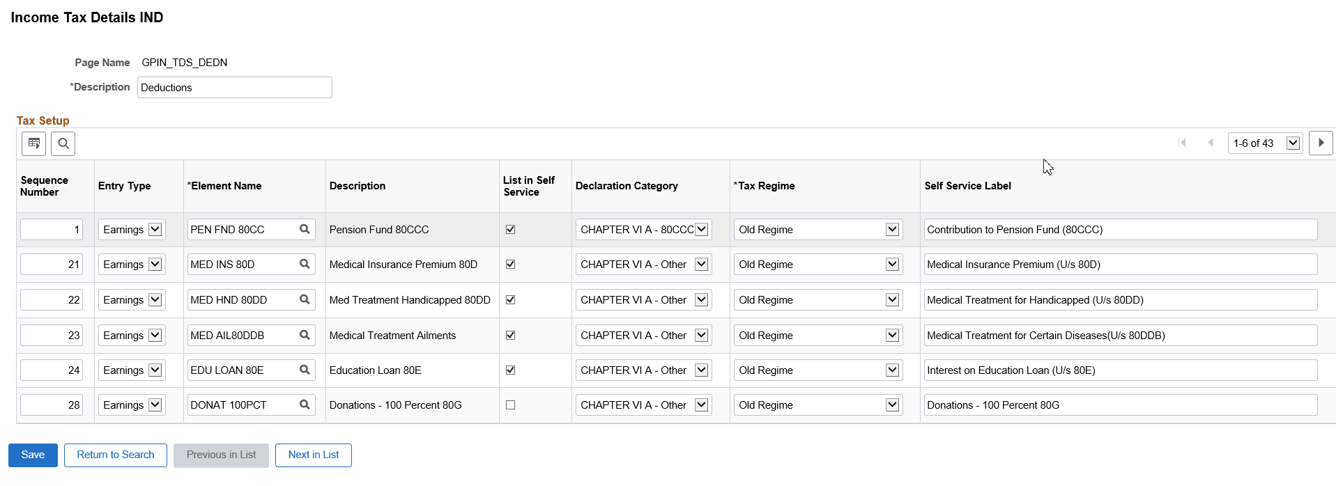

Tax Setup – Deductions Page
Use the Tax Setup – Deductions page (GPIN_TDS_DEDN) to set up information for deductions Under Chapter VI A.
Navigation:
Setup HCM, and then Product Related, and then Global Payroll & Absence Mgmt, and then Taxes, and then Income Tax Details IND, and then Deductions
This example illustrates the fields and controls on the Tax Setup – Deductions page. You can find definitions for the fields and controls later on this page.
Tax Setup - Deductions page
See field descriptions under the Common Elements heading at the beginning of this section.

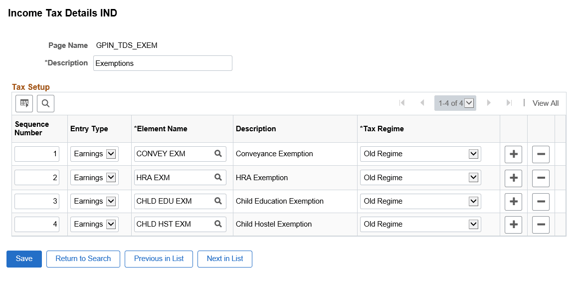

Tax Setup – Exemptions Page
Use the Tax Setup – Exemptions page (GPIN_TDS_EXEM) to set up tax exemptions.
Navigation:
Setup HCM, and then Product Related, and then Global Payroll & Absence Mgmt, and then Taxes, and then Income Tax Details IND, and then Exemptions
This example illustrates the fields and controls on the Tax Setup – Exemptions page. You can find definitions for the fields and controls later on this page.
Tax setup exemption page

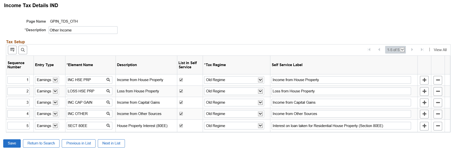

Tax Setup – Other Income Page
Use the Tax Setup – Other Income page (GPIN_TDS_OTH) to set up other income information.
In addition you can enable self service functionality using this page.
Navigation:
Setup HCM, and then Product Related, and then Global Payroll & Absence Mgmt, and then Taxes, and then Income Tax Details IND, and then Other Income
This example illustrates the fields and controls on the Tax Setup – Other Income page. You can find definitions for the fields and controls later on this page.
Tax setup other income page

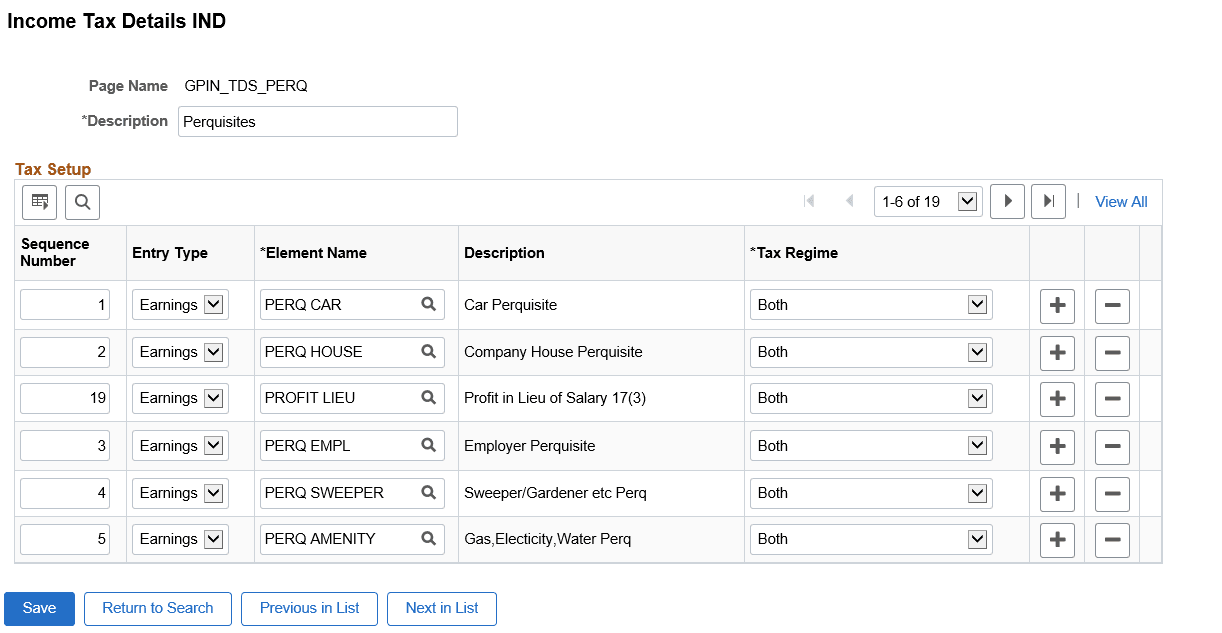

Tax Setup – Perquisites Page
Use the Tax Setup – Perquisites page (GPIN_TDS_PERQ) to set up information for perquisites.
Navigation:
Setup HCM, and then Product Related, and then Global Payroll & Absence Mgmt, and then Taxes, and then Income Tax Details IND, and then Perquisites
This example illustrates the fields and controls on the Tax Setup – Perquisites page. You can find definitions for the fields and controls later on this page.
Tax setup Perquisites page

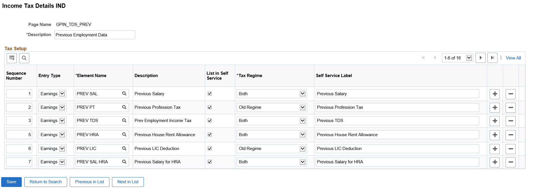

Tax Setup – Previous Employment Page
Use the Tax Setup – Previous Employment page (GPIN_TDS_PREV) to set up previous employment data.
The Payroll administrator is responsible for entries made and approvals in this page. It is important to note that Approval amount by the payroll administrator is permitted to be different from what is declared by the employee in his Self Service page. If the amount is different from what is submitted for approval (by the payroll administrator), a warning message has been enabled indicating the user about a variance. The Administrator may use his discretion in updating or saving this page. The approval by Payroll administrator has direct impact on the payroll calculations.
Navigation:
Setup HCM, and then Product Related, and then Global Payroll & Absence Mgmt, and then Taxes, and then Income Tax Details IND, and then Previous Employment
This example illustrates the fields and controls on the Tax Setup – Previous Employment Data page. You can find definitions for the fields and controls later on this page.
Tax setup previous employment page
