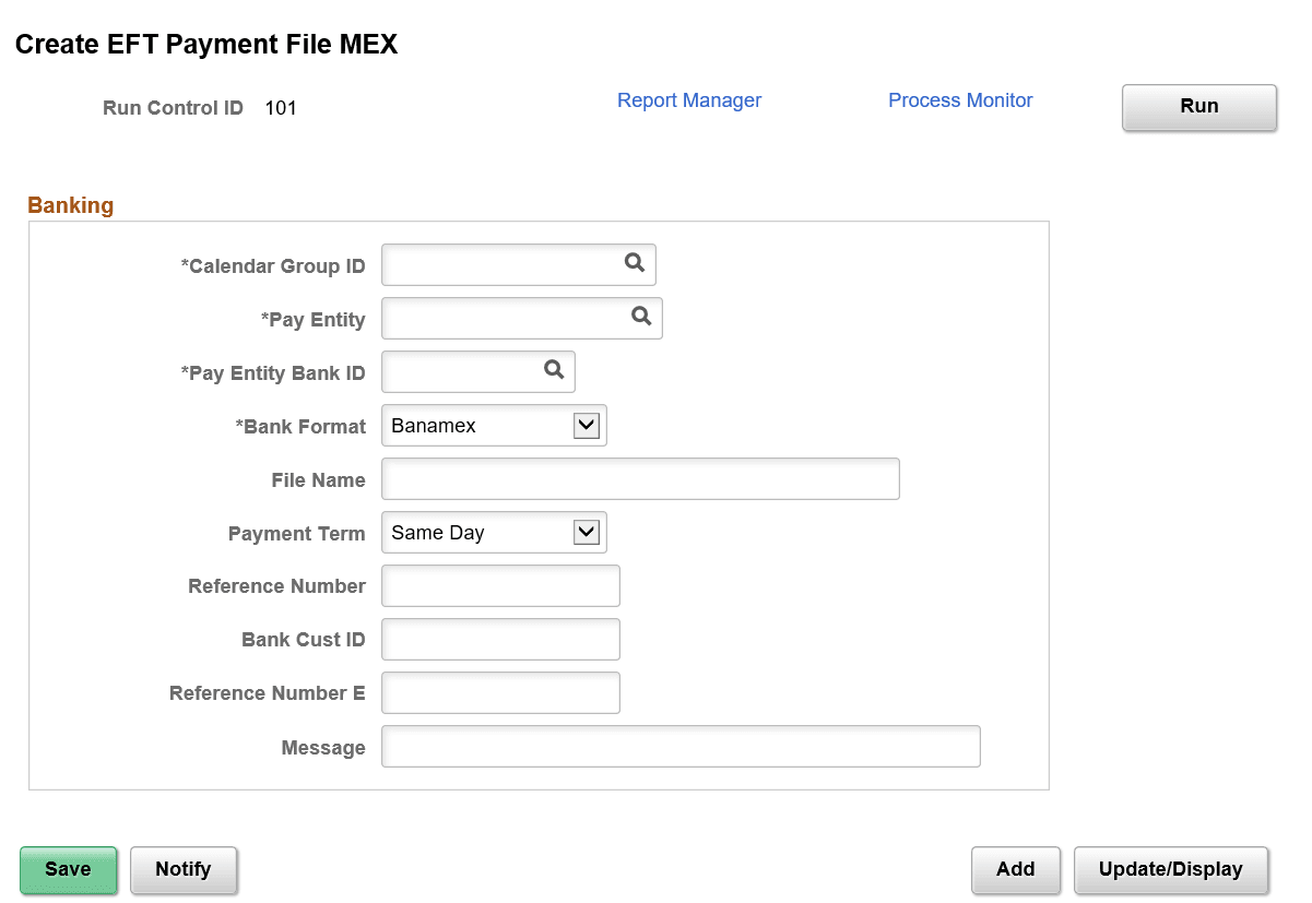

Use the Create EFT Payment File MEX page (GPMX_BANK_EFT) to create an electronic flat file to be transferred (EFT) to the bank and generate a printed report.
Navigation:
Global Payroll & Absence Mgmt, and then Payment Processing, and then EFT Payment File MEX, and then Create EFT Payment File MEX
This example illustrates the fields and controls on the Create EFT Payment File MEX page. You can find definitions for the fields and controls later on this page.
Create EFT Payment File Mex
Field or Control Description
Calendar Group ID
Select the Calendar Group ID for which you want to generate a payment file.
Pay Entity
Select the pay entity for which you want to generate a payment file.
Pay Entity Bank Id
Select the bank by Pay Entity. Option list displays the available banks populated after running the Payment Prep Process MEX.
Bank Format
Select the bank. Values are Banamex, BBVA Bancomer, Banorte, HSBC, Scotiabank, and Santander. Depending on which bank you select, additional fields may appear on this page. Each bank may require different information about the bank file transfer. The following table lists the additional fields that appear depending on the bank format you select.
Bank Format Additional Fields that Appear
Banamex
File Name, Payment Term, Reference Number, Bank Cust ID, Reference Number E, Message
Bancomer
File Name, Secondary Reference, Bank Cust ID, Reference Number, Operation Date
Banorte
File Name, Bank Cust ID
HSBC
File Name, Transfer Type, Batch Reference, Beneficiary Account Reference, Reference Number
Note: The Reference Number field is displayed only when Interbankis selected in the Transfer Type field.
Scotiabank
File Name, Bank Cust ID, Reference Number C, Reference Number D, Message
Santander
File Name, Transfer Type, Reference Number
Note: The Reference Numberfield is displayed only when Interbankis selected in the Transfer Type field.
Once the GP_PAYMENT table and the GPMX_PAYMENT table are populated, you can launch an SQR that generates the flat file for banking along with a printed report of payment details.
