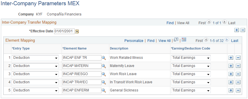

Inter-Company Parameters MEX Page
Use the Inter-Company Parameters MEX page (GPMX_INTERCOM_PARM) to define which accumulators, earnings, and deduction elements from the prior company to carry over to the new company for employees with inter-company transfers.
The Inter-Company Transfer process uses these mappings to move the employee's finalized payroll values for these elements between internal companies.
Navigation:
Set Up HCM, and then Product Related, and then Global Payroll & Absence Mgmt, and then Taxes, and then Inter-company Parameters MEX
This example illustrates the fields and controls on the Inter-Company Parameters MEX page. You can find definitions for the fields and controls later on this page.
Field or Control Description
Effective Date
Enter the effective date on which the element mapping for inter-company transfers becomes valid.
Entry Type
Select the type of element that you are mapping from one company to another for inter-company transfers. This element mapping definition is used to insert specified earnings, deduction, and accumulator elements into the Define Prior Employer Data MEX page as former employer data. Your choices are Earnings, Deduction, orAccumulator.
Element Name andDescription
Select the element that you are mapping from one company to another for inter-company transfers. The system prompts you to select from elements based on the specified entry type.
Earning/Deduction Code
Select the earning or deduction code to which you are mapping the specified element to prior employer data. The Inter-Company Transfer process uses this mapping of accumulators to earning/deduction codes to populate the Define Prior Employer Data MEX page with the employee's accumulator values from the former company.
