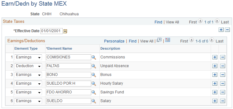

Earn/Dedn by State MEX Page
Use the Earn/Dedn by State MEX page (GPMX_STATE_TAXES) to define which earnings and deductions will be part of a state's tax base.
Navigation:
Set Up HCM, and then Product Related, and then Global Payroll & Absence Mgmt, and then Taxes, and then Earn/Dedn by State MEX
This example illustrates the fields and controls on the Earn/Dedn by State MEX page. You can find definitions for the fields and controls later on this page.
Field or Control Description
Element Type
Select the element type. Values are Deduction and Earnings.
Element Name
Select the earning or deduction element to be added to the state tax base.
Note: This data is loaded into the payroll process with the IE AR ST TAX CNCPT array.
