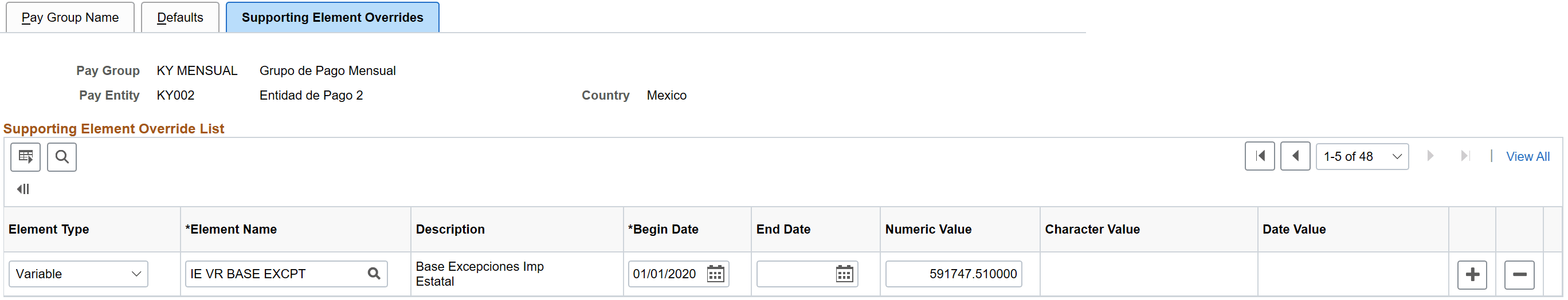

    There are two options to get the Total Base State Tax:
    1. Enter value for variable IE VR BASE EXCPT at Supporting Element Overrides by Pay Groups or any other level, the payroll will take this value as Total Base State Tax.
      Supporting element overrides
