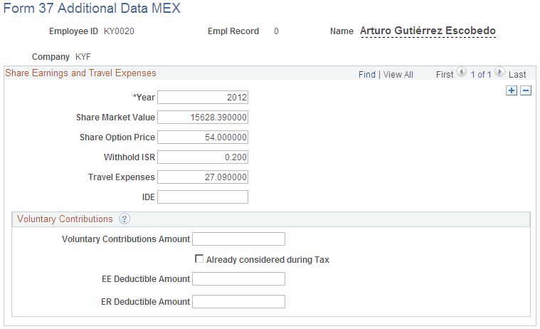

Form 37 Additional Data MEX Page
Use the Form 37 Additional Data MEX page (GPMX_FORM37_ADD) to add information about share earnings and travel expenses for individual employees that will appear on Form 37.
Navigation:
Global Payroll & Absence Mgmt, and then Payee Data, and then Taxes, and then Form 37 Additional Data MEX
This example illustrates the fields and controls on the Form 37 Additional Data MEX page. You can find definitions for the fields and controls later on this page.
Field or Control Description
Employee ID, Name, Empl Rec Nbr, andCompany
This information is display only. The system transfers this information from the previous page when you click Add.
Share Earnings and Travel Expenses
Year
Enter the year in which the employee incurred share earnings and travel expenses.
Share Market Value
Enter the market value of the shares that the employee owns.
Share Option Price
Enter the option price of the shares that the employee owns.
Retained ISR
Enter the tax rate that the state will retain when the options are exercised.
Travel Expenses
Enter the expenses the employee incurred when traveling.
IDE
Enter IDE information.
Voluntary Contributions
Voluntary Contributions Amount
Enter the total voluntary contributions for the retirement of the payee
Already considered during Tax
Select to indicate that the employer already applied the voluntary contribution amount to the payee's tax calculation.
EE Deductible Amount (employee deductible amount)
Enter the payee's portion of the deductible amount of voluntary contributions.
ER Deductible Amount (employer deductible amount)
Enter the employer's portion of the deductible amount of voluntary contributions.
