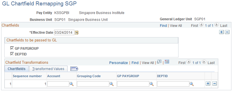

This example illustrates the fields and controls on the GL Chartfield Remapping SGP page.

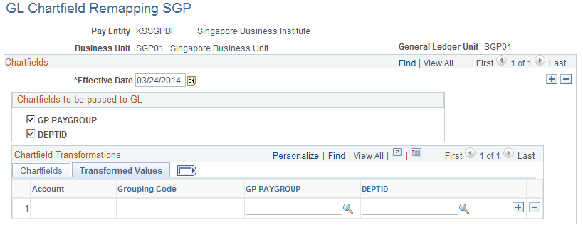

This example illustrates the fields and controls on the GL Chartfield Remapping SGP: Transformed Values tab.
GL Chartfield Remapping SGP: Transformed Values page

Chartfields to be passed to GL
A field appears for each chartfield you have set up on the ChartFields page in Global Payroll. Use the specific chartfields check boxes to choose not to send your specific chartfields to the General Ledger. During mapping, chartfields can be used to cost to different account codes. You can then choose not to send the chartfields to the General Ledger and only send the values to the accounts. When integrating Global Payroll with General Ledger, you can remap ChartField values to a business unit's general ledger (GL) account numbers. To enter the new, remapped chartfield value, use the Transformed Values tab.
Transformed Values Tab
The default chartfields values display in the fields on the Chartfields tab. To remap the default settings, select the new values on the Transformed Values tab.

Account
This is the General Ledger Account number to which your chartfields and grouping codes will map.
Grouping Code
Select the code to map to the General Ledger account. This is the Grouping Code for the elements that are included in the General Ledger transfer. A grouping comprises entry types of earnings, deductions, or segment accumulators. Elements must be in groups before they can be processed by General Ledger. Instead of entering earnings individually, you bundle them into one accumulator and create a grouping code for that accumulator.
