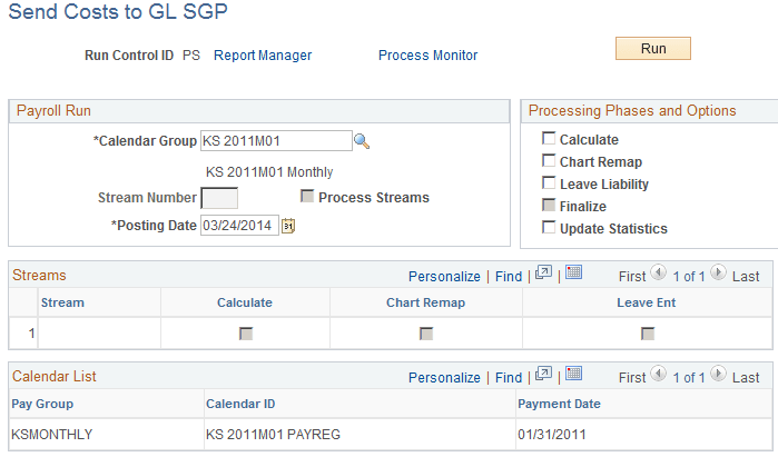

Send Costs to GL SGP Page
Use the Send Costs to GL SGP page (GPSG_GL_PREPARE) to initiate the processes for calculation of GL data, leave liability, chartfield remapping and finalization the GLI and statistical data updating.
Navigation:
Global Payroll & Absence Mgmt, and then Time and Labor / GL Costs, and then Send Costs to GL SGP, and then Send Costs to GL SGP
This example illustrates the fields and controls on the Send Costs to GL SGP page.
Processing Phases and Options
Field or Control Description
Chart Field Remap
Select this check box to enable the chartfield remap application program when running the General Ledger process. This run control page enables you to run an Application Engine process (GPSG_GL_MAP) that updates chartfields in GP_GL_DATA. The program selects and updates the necessary GP_GL_DATA records with specified chartfield overrides. When you run the GL interface finalize process, the data is summarized using your chosen (remapped) chartfields for correct account mapping.
The differences between this page and the page you access through Compensate Employees, and then Manage Payroll Process, and then Process (GP_GL_PREPARE) is the additional processing phase option of Leave Liability and ChartField Remap.
