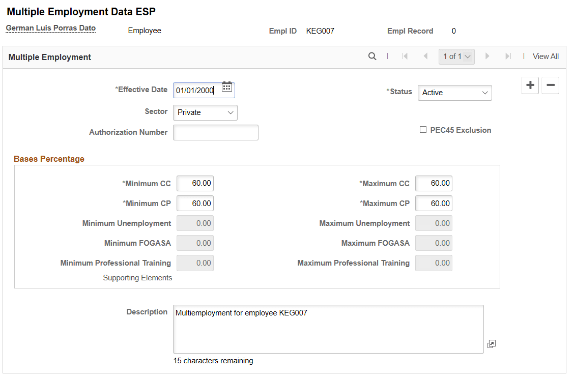

Use the Multiple Employment Data page (GPES_MULT_EMP) to calculate the funding base of social security contributions for employees with multiple jobs.
Navigation:
Global Payroll & Absence Mgmt, and then Payee Data, and then Social Security/Insurance, and then Multiple Employment Data ESP, and then Multiple Employment Data
This example illustrates the fields and controls on the Multiple Employment Data page. You can find definitions for the fields and controls later on this page.
Field or Control Description
Sector
Select Public or Private.
Authorization Number
Enter the employee's social security authorization number used for multiple employment. This information will be included in the TC2 report that is sent to Social Security.
PEC45 Exclusion
Select the check box if the employee is working for multiple companies, with excluded contingencies in the other company. Employee with contributing peculiarity 45.
Selecting this field will make the following fields and Supporting Elements link editable.
  • Minimum Unemployment
  • Maximum Unemployment
  • Minimum FOGASA
  • Maximum FOGASA
  • Minimum Professional Training
  • Maximum Professional Training
By default, the value entered for CP general base will be displayed in these fields.
Minimum CC (minimum common contingencies base percent)
Enter the percentage to be applied to the minimum base used to calculate the funding base for common contingencies.
Maximum CC (minimum common contingencies base percent)
Enter the percentage to be applied to the maximum base used to calculate the funding base for common contingencies.
Minimum CP (minimum professional contingencies base percent)
Enter the percentage to be applied to the lower ceiling used in the calculation of the professional contingencies base.
Maximum CP (minimum professional contingencies base percent)
Enter the percentage to be applied to the upper ceiling used in the calculation of the professional contingencies base.
Enter the percentage to be applied to the lower ceiling used in the calculation of the Unemployment Social Security base.
Enter the percentage to be applied to upper ceiling used in the calculation of the Unemployment Social Security base.
Minimum FOGASA
Enter the percentage to be applied to lower ceiling used in the calculation of the FOGASA Social Security base.
Maximum FOGASA
Enter the percentage to be applied to upper ceiling used in the calculation of the FOGASA Social Security base.
Enter the percentage to be applied to upper ceiling used in the calculation of the Professional Training Social Security base.
Enter the percentage to be applied to lower ceiling used in the calculation of the Professional Training Social Security base.

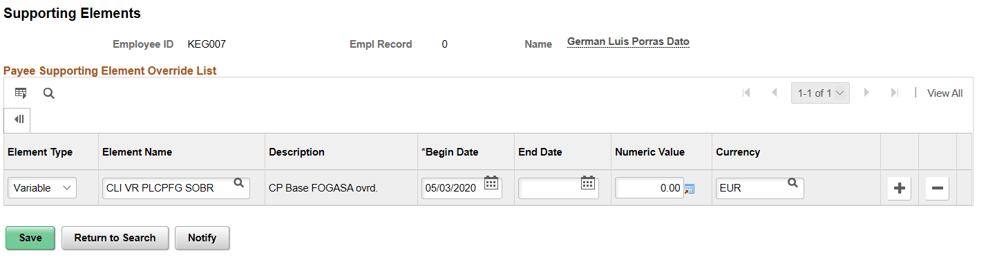

Click the Supporting Elements link to inform the daily Social Security bases in those scenarios not covered automatically by the standard processing.
This example illustrates the fields and controls on the Supporting Elements page.
Supporting Elements Page
