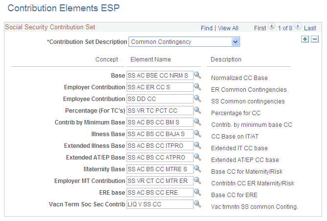

Contribution Elements ESP Page
Use the Contribution Elements ESP page (GPES_SS_CNTB_BSE) to obtain information about key elements used in the social security process.
Navigation:
Set Up HCM, and then Product Related, and then Global Payroll & Absence Mgmt, and then Social Security / Insurance, and then Contribution Elements ESP
This example illustrates the fields and controls on the Contribution Elements ESP page. You can find definitions for the fields and controls later on this page.
Field or Control Description
Base
Displays the accumulator that stores the funding base used in the social security calculation.
Employer Contribution
The accumulator that stores the employer's contribution to social security.
Employee Contribution
The accumulator that stores the employee's contribution to social security.
Percentage (For TC's)
The variable that stores the total contribution percentages (employee plus employer percent) that must be recorded in the TC reports.
Contrib by Minimum Base (contribution by minimum base)
The accumulator that stores the contribution base corresponding to the period that contributes by minimum base.
Illness Base
The accumulator that stores the contribution base corresponding to sick days.
Extended Illness Base
The accumulator that stores the contribution base corresponding to the period affected by extended illness absence.
Extended AT/EP Base
The accumulator that stores the contribution base corresponding to the period affected by extended AT/EP absence.
Maternity Base
The accumulator that stores the employee's maternity base.
Employer MT Contribution (employer maternity contribution)
The variable that stores the employer's contribution for maternity or pregnancy risk benefits.
ERE Base
The accumulator that stores the contribution base corresponding to the period affected by ERE.
Vac. Trmntn. Soc. Sec. Contrib (vacation termination social security contribution)
The deduction that stores the contributions related to paid vacations for terminated employees.

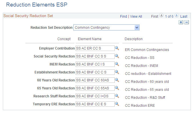

Reduction Elements Page
Use the Reduction Elements page (GPES_SS_BNF_DEF) to obtain information about key accumulators used in the social security reduction process.
Navigation:
Set Up HCM, and then Product Related, and then Global Payroll & Absence Mgmt, and then Social Security / Insurance, and then Reduction Elements ESP
This example illustrates the fields and controls on the Reduction Elements ESP page. You can find definitions for the fields and controls later on this page.
The accumulator that stores the amount of the employer's contribution to social security for each contribution type, common contingency, permanent disability D & S, professional training, and FOGASA.
To calculate the employer reductions, PeopleSoft Global Payroll for Spain applies the reduction percentages defined on the Reduction Data page to the amount in this accumulator.
Social Security Reduction
The accumulator that stores the employer reductions that are managed by social security for each contribution type (common contingency, permanent disability D & S, professional training, and FOGASA).
INEM Reduction
The accumulator that stores the employer reductions managed by INEM for each contribution type (common contingency, permanent disability D & S, professional training, and FOGASA).
Establishment Reduction
The accumulator that stores the employer reductions managed by INEM in case a catastrophe occurs to a company establishment.
60 Years Old Reduction
The accumulator that stores the employer reductions for employees older than 60.
65 Years Old Reduction
The accumulator that stores the employer reductions for employees older than 65.
Research Stuff Reduction
The accumulator that stores the employer reductions for employees that are categorized as research staff (personal investigador).
Temporary ERE Reduction
The accumulator that stores the employer reductions for employees affected by temporary ERE.
