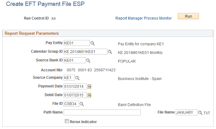

Create EFT Payment File ESP Page
Use the Create EFT Payment File ESP (create electronic file transfer payment file) page (GPES_RC_BNK5) to create a flat output file to send to the bank.
This EFT payment file contains the payment details for each employee. It is sent to the bank so that funds can be transferred to employees' accounts. The file includes the employee name, beneficiary name, date, and amount of payment. At the end of this process, the system updates the GP_PAYMENT table by setting field PMT_STATUS from F (finalized) to T (transferred).
Navigation:
Global Payroll & Absence Mgmt, and then Payment Processing, and then Create Payment File ESP, and then Create EFT Payment File ESP
This example illustrates the fields and controls on the Create EFT Payment File ESP page. You can find definitions for the fields and controls later on this page.
Field or Control Description
Pay Entity
Enter the pay entity.
Calendar Group ID
Select the calendar group for the payroll run.
Source Bank ID
Displays the ID of the source bank from which the payments are withdrawn.
Account Nbr
Displays the bank account number for the source bank.
Source Company
A Calendar Group could have employees who belong to different companies. You can use this field to select the company that should be printed as the applicant / source of transfer.
Note: System does not validate to check if the Source Bank Account belongs to the Source Company.
Payment Date
Enter the date of the bank file generation.
Debit Date
Enter the date on which the bank debits the transfers.
File ID
Select the ID of the banking file you want to use for the EFT file. You define banking files on the Define Bank File ESP page.
Path Name
Enter the directory to which you want the EFT file saved.
File Name
Enter a name for the EFT file. The system adds the company code and source bank ID to the name you specify and saves the file in text (.txt) format.
Rerun Indicator
Select to re-create the EFT file for payments that were already transferred.
