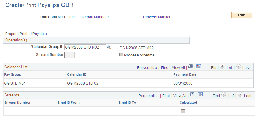

Create/Print Payslips GBR Page
Use the Create/Print Payslips GBR page (GPGB_PSLIP) to run the Printed Payslip Job PSJob process (GPGBPYSP).
This job runs the Payslip Preparation process (GPGB_PSLIP_X), followed by the Printed Payslip SQR report (GPGBPSLP), and the Create Self Service Payslip process (GP_EPAY). You must set up payslips on the payslip definition pages before running the payslip processes.

This example illustrates the fields and controls on the Create/Print Payslips GBR page.
Operations
Field or Control Description
Calendar Group ID
Select the calendar group for which you want to load payslip result data.
Stream Number and Process Streams
Select the stream for which you want to load payslip result data. Stream and Process Stream fields are as defined on the Streams and Payroll/Absence Run Control pages. If you have defined them for processing, then you can use them to select results.
Calendar List
Pay Group
Displays the pay group for which you are loading payslip result data.
Calendar ID
Displays the calendar ID for which you are loading payslip result data.
Payment Date
Displays the payment date for which you are loading payslip result data.
Off Cycle Groups
Pay Group
Period ID
Displays the period ID for which you are loading payslip result data
Off Cycle Group
Displays the off cycle group for which you are loading payslip result data
Streams
Stream Number
Select the streams you are using to load data into the payslip printing tables.
Calculated
Indicates which streams have been calculated.
