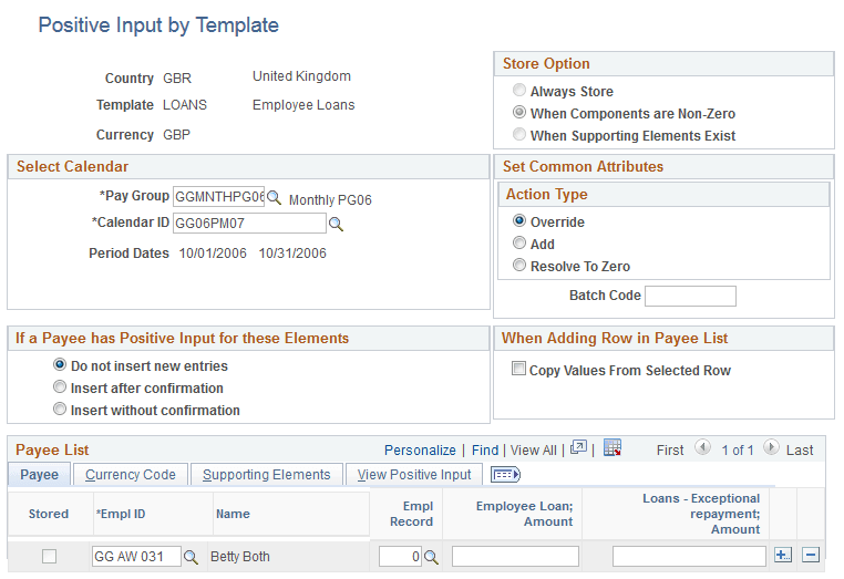

Positive Input by Template Page
Use the Positive Input by Template page (GP_PI_BULK_SSN) to use the template delivered for the UK to enter positive input for loans.
Navigation:
Global Payroll & Absence Mgmt, and then Absence and Payroll Processing, and then Prepare Payroll, and then Positive Input by Template, and then Positive Input by Template
This example illustrates the fields and controls on the Positive Input by Template page.
Field or Control Description
Action Type
Select one of these options:
Override: To override the repayment amount for the pay period.
Add: To enter an additional repayment amount or an exceptional amount.
Employee Loan: Amount
Enter the override or additional amount. Leave this field blank if the positive input is for an exceptional amount.
Loan – Exceptional repayment: Amount
Enter the exceptional amount. Leave this field blank if the positive input is for an override or additional amount.

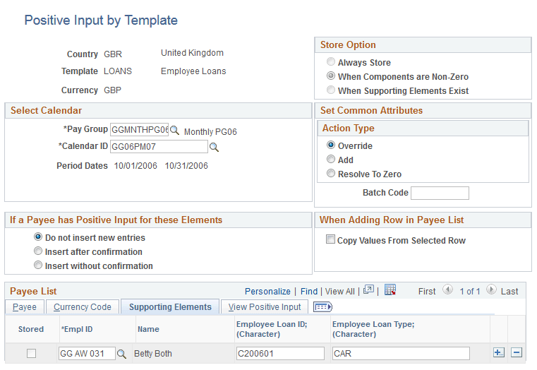

Supporting Elements
Access the Supporting Elements tab.
This example illustrates the fields and controls on the Supporting Elements tab of the Positive Input by Template page.
Positive Input by Template page: Supporting Elements tab
Employee Loan ID (Character)
Enter the loan ID defined for this loan on the Employee Loans page.
Employee Loan Type (Character)
Enter the loan type.
