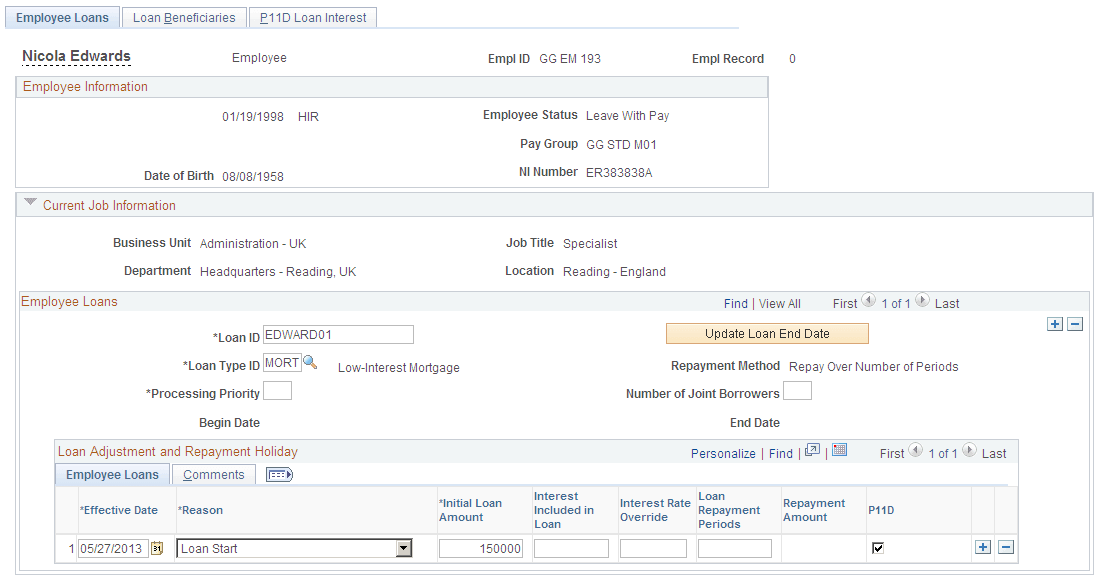

Employee Loans Page
Use the Employee Loans page (GPGB_EE_LOAN_DT) to set up and adjust loan data for payees.
Use this page to specify the loan type, loan amount, the interest rate and amount.
Navigation:
Global Payroll & Absence Mgmt, and then Payee Data, and then Loans, and then Maintain Loans GBR, and then Employee Loans
This example illustrates the fields and controls on the Employee Loans page.
Employee Loans page
Field or Control Description
Loan ID
Enter a unique identifier for each employee loan. This can be any identifier you require. The loan ID is used as user key1 for the loan accumulators.
Loan Type ID
Select the loan type. You define loan types on the Loan Type Definition GBR page. The Loan Type ID is used as user key2 for the loan accumulators and is used as an identifier to set up deduction recipients.
See Setting Up Deduction Recipients.
Repayment Method
Displays the repayment method:
Repay Fixed Amount Per Period: Payee pays a fixed amount each pay period.
Repay Over Number of Periods: Payee pays the loan over a fixed number of pay periods.
The repayment method is defined when you set up loan types on the Loan Type Definition GBR page.
See Setting Up Employee Loan Types.
Processing Priority
If an employee has multiple employee loans, assign each loan a priority. Priority determines the order in which the loans are processed. The lower the number, the higher the priority.
Number of Joint Borrowers
Enter the number of borrowers for joint loans. This information is required for P11D reporting.
Begin Date
Displays the start date for the loan. This is the date you entered for the Loan Start row in the Loan Adjustment and Repayment Holiday group box.
This date is used in P11D reporting.
End Date
Displays the date on which the loan was repaid or loan processing was terminated. The system populates this field when:
  • The loan is repaid in full.
  • An employee is terminated.
  • You enter a Reason of Stop Loan on this page.
The Update Loan End Date button updates the End Date field if loan processing results exist.
See Understanding Loan Processing.
Click this button to update the End Date field. The system checks loan processing results and populates the End Date field if the payroll has been finalized and the loan has been repaid, or the employee was terminated. A warning message appears if the system does not find a value to populate the end date (because the loan balance is greater than zero or the payroll results are not finalized).
Loan Adjustment and Repayment Holiday - Employee Loans
Use this group box to:
  • Define the loan start date and loan repayment information when you add a loan initially.
  • Make adjustments to existing loans.
Access the Employee Loans tab.
Effective Date
Enter the loan start date, loan end date, or date of the changes to the loan data, according to the reason you select.
For the loan start date, enter the date when the first repayment is made. The first loan repayment is taken out of the employee's earnings in the pay period within which the start date falls.
Reason
Select a reason for the change to the loan information. Options are:
Loan Start: Use this to define the loan data initially. You cannot save this page without a row for the loan start information.
Stop Loan: Indicates when the loan was repaid or loan processing was terminated. The system inserts a Stop Loan row when the loan is repaid or when a payee is terminated. You can also add a row manually to force the system to stop processing a loan.
Holiday Suspend Recovery: Stop loan processing temporarily. You can only suspend loan deductions if the loan type allows repayment holidays.
Holiday Resume Recovery: Restart loan processing after a repayment holiday. This reason must follow a Holiday Suspend Recovery row.
Interest/Amount Change: Select to make an adjustment to the loan amount or the interest included in the loan.
P11D Reporting: Select if there is a change in P11D reporting.
Revised Repayment Plan: Select to change the repayment amount or the number of repayment periods. Depending on the repayment method for the loan, the system makes the Loan Repayment Periods or the Repayment Amount field available when you select this reason.
Initial Loan Amount
Enter the initial amount of the loan that was taken out by the employee. The value you enter must include interest. This field is available when you select Loan Start or Interest/Amount Change only in the Reason field.
Interest Included in Loan
Enter the total interest paid on the loan.
Interest Rate Override
Enter the interest rate for the payee's loan, if the default interest rate for the loan type does not apply. The default interest rate is defined on the Loan Type Definition GBR page.
Enter the number of periods over which the loan is to be repaid. Periods are determined by the frequency of the pay period that you defined. This field is not available if the repayment method is Repay Fixed Amount Per Period.
You can adjust the repayment period for existing loans if you select Revised Repayment Plan or Interest/Amount Change in the Reason field.
Repayment Amount
Enter the amount that is deducted from the payee's net pay each pay period. You can change the repayment amount if you select Holiday Resume Recovery, Revised Repayment Plan, or Interest/Amount Change in the Reason field.
If the repayment method is Repay Over Number of Periods this field is not editable. Instead, the system calculates and displays the repayment amount (initial loan amount divided by the number of loan repayment periods).
P11D
Select this check box if the loan should be included in the payee's P11D report. The system displays the default for the loan type but you can override the default if required. This field is available if you select Loan Start or P11D Reporting in the Reason field.
Loan Adjustment and Repayment Holiday - Comments
Access the Comments tab.
Comments
Click this link to access the Comments page where you can enter comments if required.

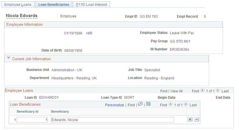

Loan Beneficiaries Page
Use the Loan Beneficiaries page (GPGB_EE_LOAN_BN) to enter the names of the beneficiaries of a loan.
Navigation:
Global Payroll & Absence Mgmt, and then Payee Data, and then Loans, and then Maintain Loans GBR, and then Loan Beneficiaries
This example illustrates the fields and controls on the Loan Beneficiaries page.
The beneficiary information is not used in loan processing or P11D reporting. The data is for information only.
Beneficiary Id
Enter a number for each beneficiary. The system automatically increments this value, but you can override this value.
Beneficiary
Enter the name of the person or persons to whom the loan was paid.

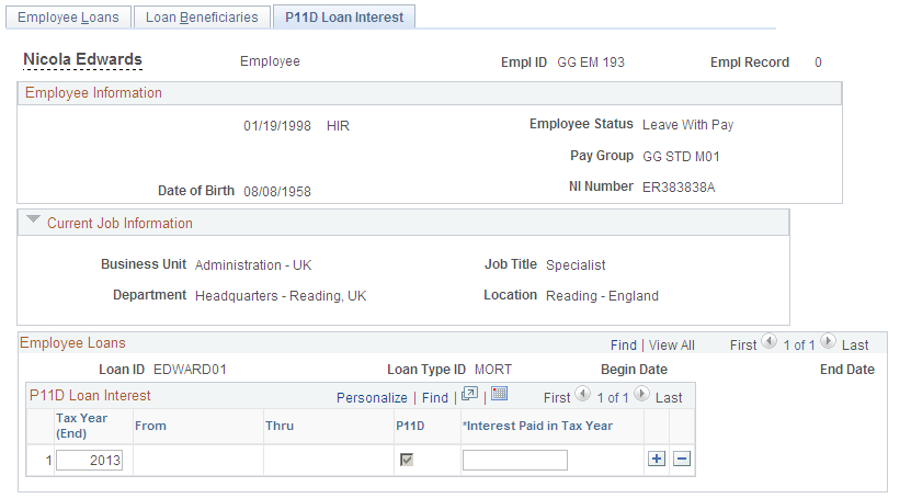

P11D Loan Interest Page
Use the P11D Loan Interest page (GPGB_EE_LOAN_IN) to record the interest paid by the payee for each tax year during the repayment period.
The information entered on this page is used for P11D reporting.
Navigation:
Global Payroll & Absence Mgmt, and then Payee Data, and then Loans, and then Maintain Loans GBR, and then P11D Loan Interest
This example illustrates the fields and controls on the P11D Loan Interest page.
Tax Year (End), From, and Thru
Enter the year in which the loan is reported to HM Revenue and Customs (HMRC). The system displays the start and end dates for the tax year in the From and Thru fields.
P11D
Indicates if the report is included on the payee's P11D report for the reportable tax year. This is determined by the setting of the P11D check box on the Employee Loans page as at the end of the tax year you specified.
Interest Paid in Tax Year
Enter the interest paid during the tax year. This information is included in the P11D report.
