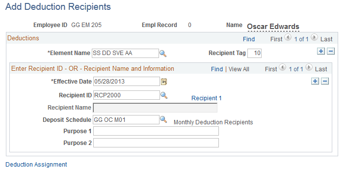

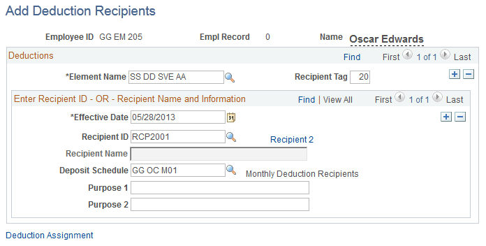

If an employee is enrolled in both the SS00 and SS01 scheme, you add the following rows on the Add Deduction Recipients page:
Deduction Recipient Tag Recipient ID
SS DD SVE AA
10
RCP2000
SS DD SVE AA
20
RCP2001

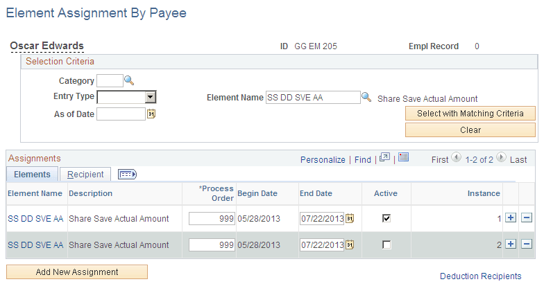

On the Element Assignment by Payee page, you add the recipient tag as follows:
Deduction Instance Recipient Tag
SS DD SVE AA
1
10
SS DD SVE AA
2
20
When you enrol an employee in a share scheme, the system automatically creates the element assignments and instance values.
When you run the banking processes, instance 1 of deduction SS DD SVE AA is associated with the recipient tag 10, which means that the deduction is paid to recipient RCP2000. Similarly, instance 2 is associated with recipient tag 20 and hence recipient RCP2001.
Here is an example showing a payee with two recipients for the deduction SS DD SVE AA:
This example illustrates the fields and controls on the Add Deduction Recipients page (1 of 2).
This example illustrates the fields and controls on the Add Deduction Recipients page (2 of 2).
Here is an example showing how the recipient tag is assigned to each instance of the deduction SS DD SVE AA:
This example illustrates the fields and controls on the Element Assignment by Payee page.
