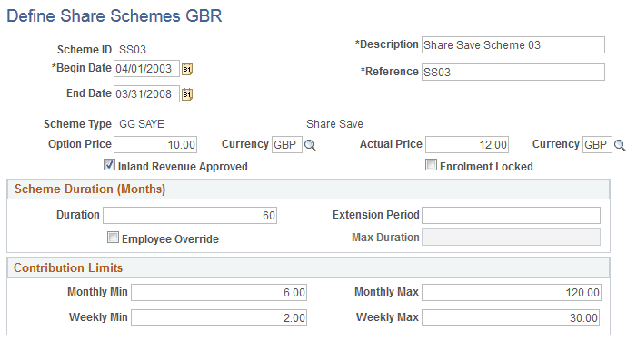

Define Share Schemes GBR Page
Use the Define Share Schemes GBR page (GPGB_SS_DEFN) to set up the rules of share schemes, including the scheme duration, contribution limits, deductions elements, and rules for processing leavers and contribution holidays.
Navigation:
Set Up HCM, and then Product Related, and then Global Payroll & Absence Mgmt, and then Allowances/Other Benefits, and then Define Share Schemes GBR, and then Define Share Schemes GBR
This example illustrates the fields and controls on the Define Share Schemes GBR page (1 of 2).
This example illustrates the fields and controls on the Define Share Schemes GBR page (2 of 2).
Field or Control Description
Reference
Enter an identifier for the share scheme.
Scheme Type
Select the scheme type from the share scheme types you defined on the Share Scheme Type page. The scheme type you select affects the fields that are displayed on this page.
Option Price
Enter the price at which payees have the option to purchase shares and select the currency code for the shares. This field is only displayed if the share scheme type is defined as a share save scheme (SAYE). The price is for information only. It is not used in processing.
Actual Price
Enter the actual share price that applies at the scheme Start Date and select the currency code. This field is only displayed if the share scheme type is defined as a share save scheme (SAYE). The price is for information only. It is not used in processing.
Inland Revenue Approved
Select this check box if the share scheme is approved by HMRC.
Enrolment Locked
Select this check box when the enrolment period is closed and payees can no longer join this scheme.
Scheme Duration (Months)
This group box is only displayed if the share scheme type is defined as a share save scheme (SAYE).

Contribution Limits
Monthly Min (monthly minimum) and Monthly Max (monthly maximum)
Enter the minimum and maximum monthly contribution.
Weekly Min (weekly minimum) and Weekly Max (weekly maximum)
Enter the minimum and maximum weekly contribution.
