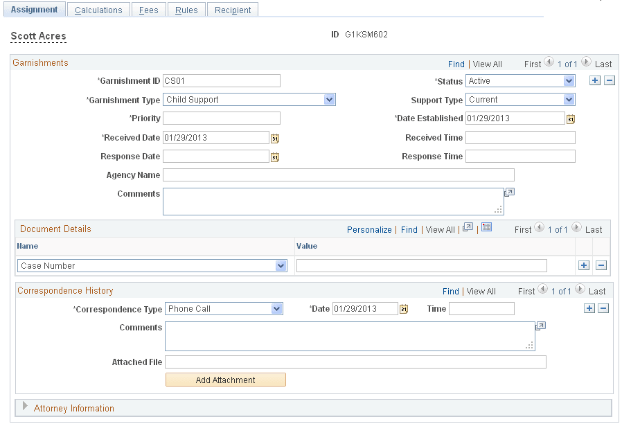

Assignment Page
Use the Assignment page (GPUS_GRN_INFO) to enter basic information about the garnishment order, including received date and time, document details, and attorney information.
Navigation:
Global Payroll & Absence Mgmt, and then Payee Data, and then Garnishments/Court Orders, and then Assign Garnishments USA, and then Assignment
This example illustrates the fields and controls on the Assignment page.
Assignment page
Define one garnishment assignment for each garnishment order that you receive for a payee. Each garnishment assignment must have a unique garnishment ID.
Field or Control Description
Garnishment ID
Enter a value that uniquely identifies the garnishment order or notice.
Garnishment Status
Update this field when the status changes throughout the life of the garnishment. The status affects the processing of the garnishment deduction. Valid values are:
  • Active: Select this value when the garnishment is active for the payee.
  • Completed: Select this value when the garnishment amount is paid in full or the court notifies the employer to stop deductions from the payee.
  • Rejected: Select this value if you cannot comply with the garnishment.
  • Suspended: Select this value to stop processing the garnishment deduction in payroll while preserving the garnishment assignment data.
Note: The system processes only garnishments with a status of Active. The system ignores garnishments with a status of Completed, Rejected, or Suspended.
Garnishment Type
Select the type of garnishment received by the employer. Valid values are Writ of Garnishment, Tax Levies, topic 13 Bankruptcy, Wage Assignment, Child Support, Spousal Support, Dependent Support, and Student Loan.
Support Type
Support types apply only to child support, spousal support, and dependent support. Valid values are Current and Arrears.
Priority
Enter the garnishment processing priority.
The priority number that you enter here determines the order in which garnishments of different types are processed. The lower the number, the higher the priority.
Note: The system determines the order in which to process garnishments of the same type by using proration formulas.
See Garnishment Processing.
Date Established
This is the date that the court approved the garnishment.
Note: The priority of a tax levy in relation to a child support order is based on the day that the orders were established. Similarly, the priority of a tax levy in relation to a bankruptcy order is based on the establishment date.
Received Date and Received Time
Enter the date and time that the garnishment is received from the court, authorized agency, or government agency.
Response Date and Response Time
Enter the date and time by which you must let the court, authorized agency, or government agency know whether you can comply with the garnishment order.
Agency Name
Enter the name of the court, authorized agency, or government agency that has legal jurisdiction over the garnishment.
Comments
Enter any notes related to the garnishment.
Document Details
Enter information about garnishment documents by selecting a garnishment detail name and entering the corresponding information in the Value field. For example, select Case Number in the Name field, and enter the number in the Value field.
You define document detail fields on the Document Details Table page, and specify the values of these fields when you assign garnishments to payees on the Assignment page of the Assign Garnishments USA component (GPUS_GRN).
See Creating Document Details.
Correspondence History
Use the Correspondence History group box to document who, when, and how your organization has communicated to payees or the issuing agency regarding a garnishment.
You define fields to record your communication about a garnishment order on the Correspondence Type Table page; you specify the values of these fields on the Assignment page of the Assign Garnishments USA component (GPUS_GRN) when you assign a garnishment to a payee.
See Creating Correspondence Types.
Correspondence Type
Select the type of correspondence.
Date and Time
Enter the date and time of the correspondence.
Comments
Enter comments related to the correspondence.
View attached documents related to the garnishment order.
Add Attachment
Select to attach correspondence regarding the garnishment.
Attorney Information
Enter the name, country, and address of the attorney representing the payee.

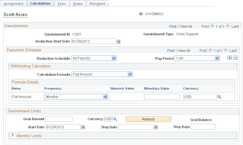

Calculations Page
Use the Calculations page (GPUS_GRN_CALC) to define the deduction schedule and deduction limits.
Navigation:
Global Payroll & Absence Mgmt, and then Payee Data, and then Garnishments/Court Orders, and then Assign Garnishments USA, and then Calculations
This example illustrates the fields and controls on the Calculations page.
Calculations page
Deduction Start Date
Enter a start date for the deduction.
Deduction Schedule
Deduction Schedule
Select a deduction schedule applicable to the garnishment.
Pay Period
Specify the pay periods in which you want the garnishment deducted. Valid values are All and the pay period number as determined by the deduction schedule. For example, if the deduction schedule is Biweekly, the pay period values are First, Second, and Third (a maximum of three biweekly periods can be in a month). And if the deduction schedule is Weekly, the pay period values are First, Second, Third, Fourth, and Fifth (a maximum of five weeks can be in a month).
Note: You must specify a value for the variable GRN VR PAY PERIOD on the Calendars - Overrides page for the calendar in which you are processing the garnishment. Enter a value of 1, 2, 3, 4, or 5, or a value of 0 for monthly calendars. For example, if the deduction schedule is BiWeekly, and you select Second as the pay period value, you must define the value of GRN VR PAY PERIOD as 2 when you process the second pay period each month.
See PeopleSoft Global Payroll: Calendars - Supporting Element Overrides Page.
Withholding Calculation
In the Withholding Calculation group box, specify the formula to use to calculate the amount for the garnishment based on the court order.
Calculation Formula
Enter the formula to use to calculate the garnishment. Valid values are:
  • DE Percentage + Amount: Percent of disposable earnings plus an additional amount.
  • Disposable Earnings Percentage: Percent of disposable earnings.
  • Flat Amount:
  • Flat Amount Percentage: Percent of a flat amount.
  • Greater of % DE or Amount: Greater of a percent of disposable earnings or an amount.
  • Greater of % Gross or Amount: Greater of a percent of gross or an amount.
  • Gross Percentage: Percent of gross pay.
  • Gross Percentage + Amount: Percent of gross pay plus an additional amount.
Name
Displays the names of the variables that must be defined based on the calculation formula. For example, if you select a calculation formula of DE Percentage + Amount, you must specify the percentage and the amount.
Frequency
Enter the frequency of the garnishment deduction. Valid values are All, Weekly, Biweekly, Semi-monthly, and Monthly.
Numeric Value, Monetary Value, and Currency
Enter a numeric value or a monetary value with its corresponding currency code for each variable populated based on the Calculation Formula.
Garnishment Limits
Goal Amount, Currency, and Goal Balance
Enter a goal amount and its corresponding currency code to establish the maximum total amount for the garnishment. After the payroll is finalized, the system updates the goal balance, displaying the amount of the garnishment that has been paid to date. When the goal balance equals the goal amount, the system automatically stops taking the deduction. If you do not want to set a goal, leave the fields blank. The goal balance appears only after you select Refresh.
Start Date
Enter a start date.
Stop Date
Enter a stop date, or have the system generate a stop date by entering the number of days that the garnishment should remain active in the Stop Days field.
Stop Days
Enter the number of days the garnishment should remain active. If you enter a value in this field, the system automatically calculates the stop date based on the start date. However, if the start date is before the calendar period start date (as the result of a proration rule, for example, or the stacking of garnishments), the system uses the period start date to calculate the stop date.
Monthly Limits
If limits apply to the amount that can be deducted each month, enter the limit calculation formula and the corresponding values for each variable displayed.

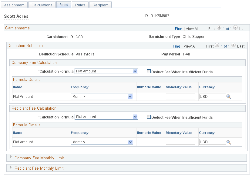

Fees Page
Use the Fees page (GPUS_GRN_FEES) to define garnishment fees and limits.
Navigation:
Global Payroll & Absence Mgmt, and then Payee Data, and then Garnishments/Court Orders, and then Assign Garnishments USA, and then Fees
This example illustrates the fields and controls on the Fees page.
Fees page
Company Fee Calculation
In the Company Fee Calculation group box, enter the calculation formula, frequency, and name, and the numeric or monetary value of the company fee. Also, specify what to do when insufficient funds are available to cover the company fee.
Deduct Fee When Insufficient Funds
If this check box is selected and not enough funds are available to cover both the garnishment and the fee, the garnishment amount is reduced by the amount of the fee.
Recipient Fee Calculation
In the Recipient Fee Calculation group box, enter the calculation formula, frequency, and name, and the numeric or monetary value of the recipient fee. Also, specify what to do when insufficient funds are available to cover the recipient fee.
Company Fee Monthly Limit
In the Company Fee Monthly Limit group box, enter the calculation formula and the numeric or monetary value of the monthly company fee limit.
Recipient Fee Monthly Limit
In the Recipient Fee Monthly Limit group box, enter the calculation formula and the numeric or monetary value of the monthly recipient fee limit.
