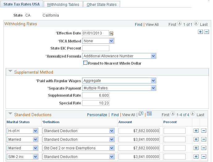

State Tax Rates USA Page
Use the State Tax Rates USA page (GPUS_TAX_ST_TBL2) to define state tax rates.
Navigation:
Set Up HCM, and then Product Related, and then Global Payroll & Absence Mgmt, and then Taxes, and then State Tax Rates USA, and then State Tax Rates USA
This example illustrates the fields and controls on the State Tax Rates USA page (1 of 2).
This example illustrates the fields and controls on the State Tax Rates USA page (2 of 2).
Many of the fields and field values on this page apply only to specific states.
Field or Control Description
Annualized Formula
Indicates the formula that the system uses to calculate annualized state income tax.
FICA Method (Federal Insurance Contributions Act method)
Indicates the method that the system uses to calculate FICA credits.
Round to Nearest Whole Dollar
Selected to specify that the system round calculated state income tax to the nearest whole dollar.
Standard Deductions
This group box contains the state-specific standard deductions that the system references when calculating state income tax.
Allowances and Exemptions
This group box contains the state-specific allowances, exemptions, and maximum SWT base and limits that the system references when calculating state income tax.
Credits
This group box contains the state-specific credits that the system references when calculating state income tax.
Supplemental Method
Paid with Regular Wages and Separate Payment
Indicates the method by which the system determines the tax for supplemental income. Many states have a supplemental method for the Paid with Regular Wages payment method that differs from the supplemental method specified for the Separate Payment payment method. If either of these fields has a value of Multiple Rates, the Special Rate field becomes available.
Supplemental Rate
Indicates the percentage by which the system multiplies the taxable gross when calculating tax for supplemental income. This field applies only to the payment methods with a supplemental method of Aggregate-No Tax else Percent or Percent of Taxable Gross. For example, for the state of Colorado, the supplemental method specified in the Separate Payment field is Percent of Taxable Gross and the supplemental rate is 4.63. That means that for supplemental payments, such as bonuses, that are paid separately from regular wages, the system multiplies the taxable gross of the supplemental payment by 4.63 percent to determine the state tax.
Special Rate
Indicates the percentage by which the system multiplies special supplementary income, such as stock. This field applies only to the payment method with a supplemental method of Multiple Rates.

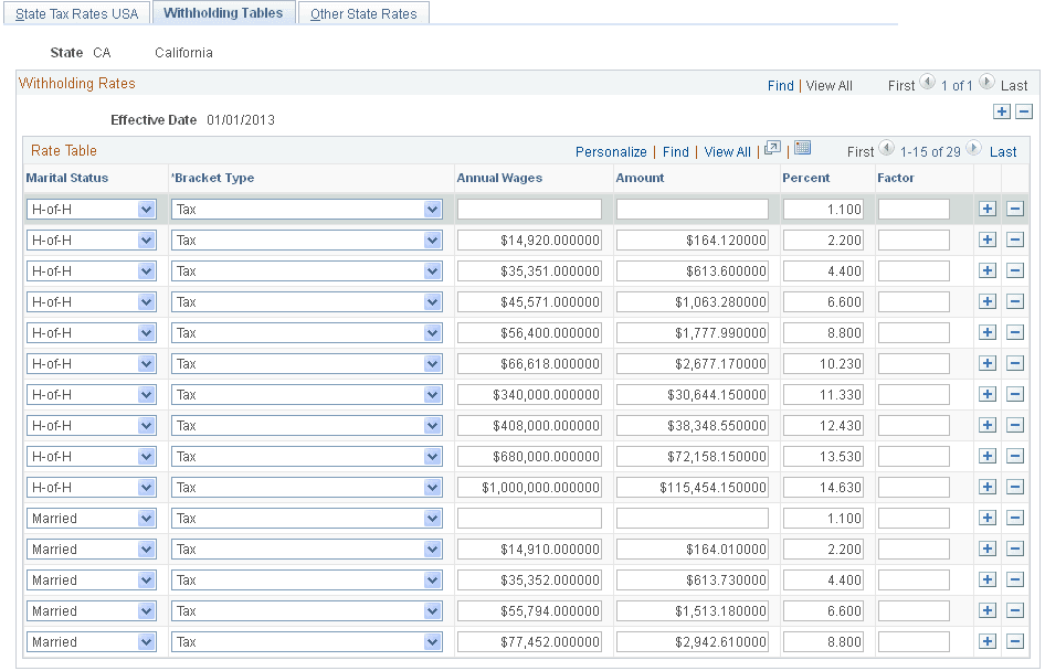

Withholding Tables Page
Use the Withholding Tables page (GPUS_TAX_ST_TBL) to define withholding rates.
Navigation:
Set Up HCM, and then Product Related, and then Global Payroll & Absence Mgmt, and then Taxes, and then State Tax Rates USA, and then Withholding Tables
This example illustrates the fields and controls on the Withholding Tables page.
This page lists all of the state-specific wage brackets and withholding rates referenced by the SWT calculation process.
