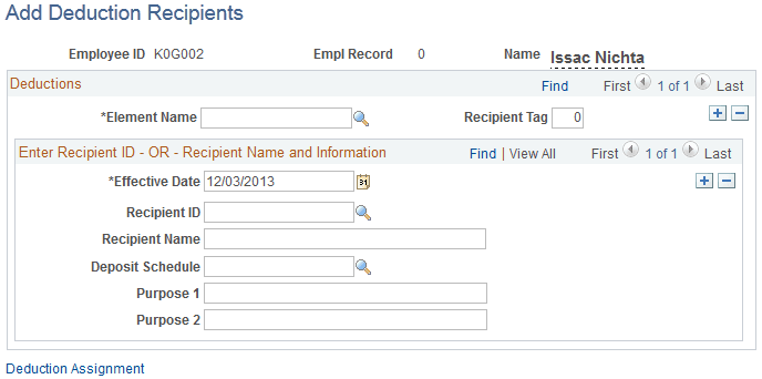

This example illustrates the fields and controls on the Add Deduction Recipients page.
Field or Control Description
Element Name
Select the deduction for which to define recipient information.
Recipient Tag
Enter the recipient tag. Tags are used for multiple resolution of deductions and single resolutions of deductions for Individual Recipients. A given payee could have one or more recipient tags and the tags are associated either with a recipient ID or with a recipient name. Tags are numeric. A Recipient Tag that is associated with an 'Individual' Deduction Recipient must have a value greater than zero. This will ensure the zero Recipient Tag is available if the General Deduction Recipient needs to be assigned to this employee along with individual recipients. The system will add the amount that resolves when there is no earning or deduction assignment.
Recipient ID
Select the recipient ID for a predefined recipient (recipients are set up using the Deduction Recipients component). To define a new recipient, leave this field blank and complete the Recipient Name field. When you select an existing recipient, the system displays the recipient name next to the Recipient ID field. Click the recipient name link to access the Define Deduction Recipients component (RECIPIENT) where you can view and update the recipient's details.
Recipient Name and Bank Account Information
If you want define a new recipient, enter the name of the recipient. When you complete this field, the system displays the Bank Account Information link. Click this link to access the Information for Recipient page where you enter the payment method and the recipient's bank account information.
Deposit Schedule
Select a deposit schedule for the recipient.
Purpose 1 and Purpose 2
Enter information that's included on the bank transfer file, such as bank routing numbers or names.
Deduction Assignment
Click the Deduction Assignment link to access the Earning/Deduction Assignment page.
