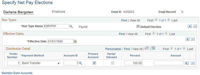

Specify Net Pay Elections Page
Use the Specify Net Pay Elections page (GP_NET_DIST) to define how a payee's net pay is distributed between the payee's bank accounts.
Navigation:
Global Payroll & Absence Mgmt, and then Payee Data, and then Net Pay/Recipient Elections, and then Specify Net Pay Elections
This example illustrates the fields and controls on the Specify Net Pay Elections page.
Field or Control Description
Run Type Name
Select for the net pay elections. You can define distributions by run type, such as one distribution for a regular run and another for expenses.
Default Election
Select to indicate the default run type. When the banking process runs, the system checks the run type defined on the pay calendar and seeks a match on the net distribution for the payee. If it finds none, it uses the distribution of the row marked Default Election.
Order Number
Enter an order number. This refers to distribution order priorities. Prioritize if a payee has distribution amounts indicated for an account type. Let's say that a payee wants 100 distributed to a savings account every month and everything else distributed to a checking account. The distribution to the savings account gets higher priority.
Payment Method
Select the payment method for the payee. Options are Bank Transfer, Cash, Check, Postal Order, and Wire Transfer.
Note: You can create only one row with payment method Check or Cash. The system does not allow multiple checks or cash amounts per payee for a pay period.
Account ID
Select the bank account ID for the payee if you selected Bank Transfer or Wire Transfer as the Payment Method field. Your choices come from definitions for the Account ID field on the Maintain Bank Accounts page.
Note: No Account ID is needed if the Payment Method is Cash, Check, or Postal Order.
Primary Account
Select if this is a payee's primary account. If a payee has set up distribution amounts for allocation to several accounts and a net pay amount remains after allocation, the extra amount goes to the primary account.
Note: If the net pay becomes a negative amount, it will go into the primary account.
Partial Allowed
Select to have partial amounts distributed from a net pay distribution.
Let's say a payee distributes 1200 monthly as follows:
  • 500: checking account.
  • 400: savings account.
  • 300: retirement account.
One month, the payee's net pay is only 1050. The system still distributes 500 to the checking account and 400 to the savings account, but it cannot distribute the full 300 to the retirement account. If Partial Allowed is selected, the system distributes the partial amount, which is 150 in this case. If Partial Allowed isn't selected, the system allocates 150 to the payee's primary account. Nothing is deposited in the retirement account.
Percent
If the distribution to an account is calculated by a percentage of the net payment, enter that percentage.
Amount
If the distribution to an account is to be calculated by an amount, specify that amount.
Note: You can define a net distribution in percentages, amounts, or both. The total cannot exceed 100 percent. Any amount remaining after percentage allocation is allocated to the primary account, unless otherwise specified.
