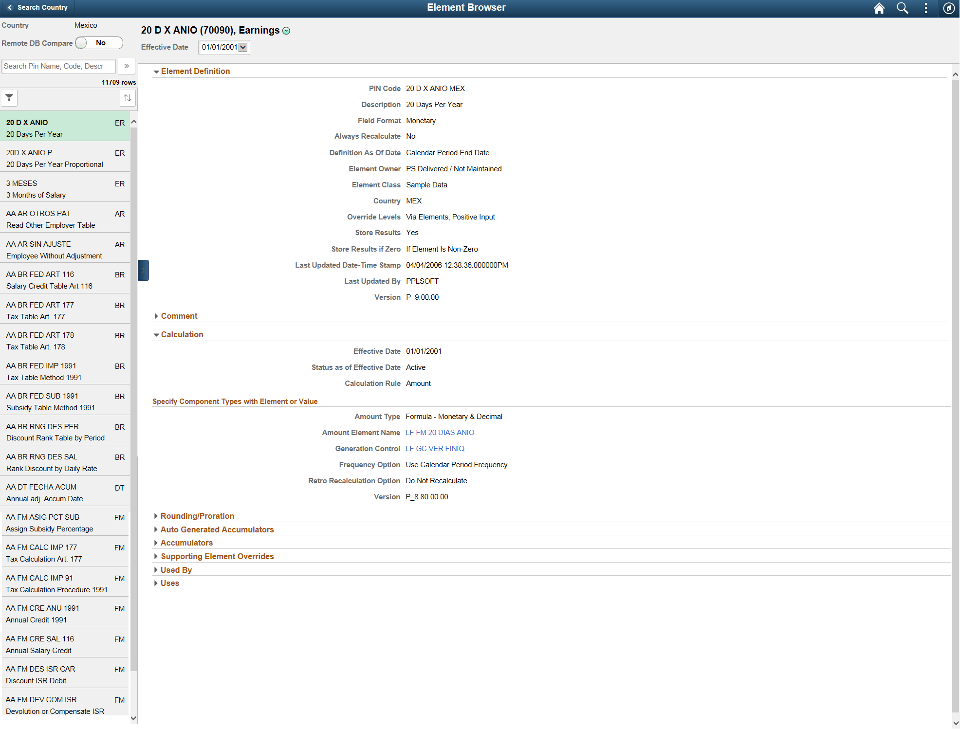

Element Browser Page
Use the Element Browser page (GPSC_ELM_BRW_LFL) to browse element information for a selected country.
Navigation:
  • Click the Search button after entering a country code on the Search Country page.
  • Click a country in the search results listed on the Search Country page.
This example illustrates the fields and controls on the Element Browser page.
The collapsible left panel of this page displays a list of all the elements associated with the selected country. For each element, the panel displays the element name, element description, and the two letter code indicating the element type. You can scroll through this list to browse elements, but because there are typically thousands of elements associated with each country, it is faster to use the search, filter, and sorting options available in this panel to find the elements you are looking for.

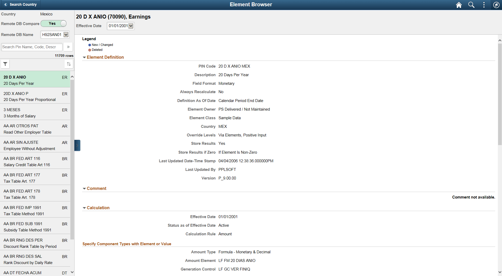

Remote DB Compare
Use this field to compare the selected element with the same element in a remote database. Select ‘Yes’ if you want to compare. By default , ‘No’ is selected.
On selecting the option as Yes, you will be prompted to enter the Remote DB Name.
This example illustrates the Remote Database Compare window.
Remote DB Compare
This example illustrates the Element Browser Page when you have selected a Remote DB Name.
Element Browser page_DB Compare
Select the Remote DB Compare option as ‘No’ to navigate back to Element Browser landing page.

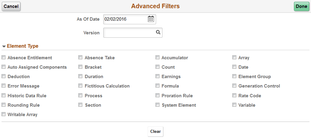

Filter button
Click to access the Advanced Filter page where you can filter the elements displayed in the left panel by:
  • As Of Date: This filter does not affect the list of elements in the left panel. Instead, the right panel displays element information associated with the effective date that is equal to or less than the date that you enter in this field.
  • Version: Enter a version to view only the elements with that version. This filter option is useful when looking for elements associated with a specific package or bundle.
  • Element Type: Select the element types you want to display in the left panel.
This is an example of the Advanced Filters page for the Element Browser.

The right panel of the page displays consolidated information for the element selected in the left panel. The header of the right panel displays the element name, PIN, and type in the format <Element Name> (<PIN>), <Element Type>
Field or Control Description
Effective Date
Select the effective date for which you want to view information for the element.

The Element Definition and Comment sections of this page appear in this panel for every element. The other sections that appear in this panel are determined by the type of element being displayed. This documentation highlights the features of some of these sections.

Element Definition
This section appears for all elements. It displays the basic information for an element in a collapsible group box. For more detailed information about the fields displayed in this section, see the documentation for the <Element> Name Page.

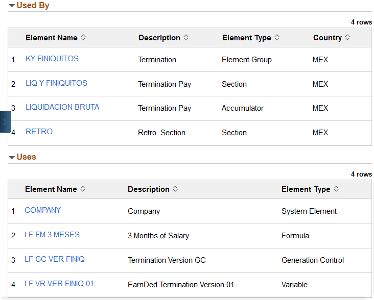

Used By and Uses
For many elements, the right panel includes the Used By and Uses sections, which enable you to quickly see the relationship that the element has with other elements.
The Used By section displays a list of all the elements that use the element you are currently viewing. The list includes elements from all countries. It enables you to quickly identify which elements will be impacted by any modifications to the element you are viewing.
The Uses section displays a list of all the elements that the element you are currently viewing uses.
This example illustrates the Used By and Uses sections of the right panel of the Element Browser page.
Example of the Used By and Used sections

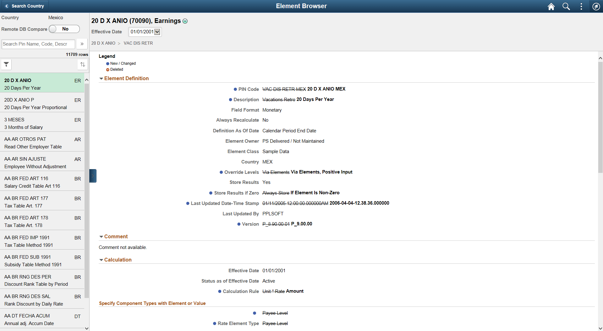

Element Compare Page
Use the Element Compare page (GPSC_ELM_CMP_SCF) to select the method you want to use to compare elements.
Navigation:
Select the Compare with Another Element related action on the Element Browser page.
This example illustrates the fields and controls on the Element Compare page.
Compare Options page
This page enables you to use the Element Browser to see a detailed comparison between two elements. When you select a compare option and click Done, the comparison view of the Element Browser page uses a combination of icons, strikethrough text, and bold text to indicate new, changed, and deleted values for the elements you are comparing.

New/Changed icon
This icon appears next to new or changed values for the elements you are comparing.
Deleted icon
This icon appears next to deleted values for the elements you are comparing.
This example illustrates the Element Browser page using the Element Compare option.
Example of the Element Browser page using the Element Compare option
