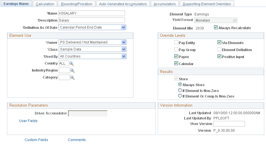

<Element> Name Page
Use the <Element> Name page (GP_PIN) to name an element and define its basic parameters.
Navigation:
Set Up HCM, and then Product Related, and then Global Payroll & Absence Mgmt, and then Elements, and then Payroll Elements, and then Earnings, and then Earnings Name
This example illustrates the fields and controls on the <Element> Name page.
<Element> Name page
The preceding example is a generic representation of the page that you use to create all element types. After you create an element on the Earnings - <Element> Name page, you continue the process of defining each element in its appropriate component, as described elsewhere in this product documentation.
Field or Control Description
Field Format
Defines the format for the resolved value. Available values are based on the element type and can include Date, Decimal, Character, Monetary, or Pointer (for calculating generic formulas for a variable).
For some element types, such as earnings and deductions, you cannot change the displayed field format.
Note: The difference between Decimal and Monetary is that Monetary is currency-controlled and requires the entry of a currency code.
Definition As Of Date
Select the date on which the system is to retrieve the element definition during a process run. Options are:
Calendar Period Begin Date: The begin date of the calendar period to which the element is linked.
Calendar Period End Date: End date of the calendar period to which the element is linked.
Payment Date: Payment date of the calendar period to which the element is linked.
Process Begin Date: Begin date of the calendar period in which the element is processed.
Process End Date: End date of the calendar period in which the element is processed.
Selections are limited for some elements. For example, Calendar Period End Date is the only valid option for section and process list elements.
Retroactivity is also a consideration for this field. During recalculation, the system always respects this day and uses the appropriate date based on individual recalculation period calendars.
Element Nbr (element number)
The PIN number.
Always Recalculate
Applies only to the period of time that is being resolved and is selected by default. If selected, the system recalculates the element every time that it encounters it in the calculation process. If this check box is deselected, the system uses the previous resolved value of the element.
deselect the check box when:
  • You update an element through an element-like formula.
    Otherwise, each time that the system encounters the element, it initializes it according to the element's definition.
  • You think that the old value will be different from the value that you'll get if the system resolves this element again—for example, when a variable has been set up with a Via Element override on the Element Name page.
Select this check box if you think that the previous value is incorrect and needs to be updated—for example, in formulas that need to be applied within a loop, an array, or a count.
Note: If this check box is deselected, and the Recalculate check box on the Section - Definition page is selected, the system resolves the element each time that it encounters it when that section is processed. If the same element is encountered in a different section where the check box is deselected, the element is resolved only once.
When the PIN Manager encounters an element, it runs an eligibility check. If it determines that the element must be resolved, it looks at the recalculation logic. You can indicate an element's recalculation at the process list level, the section level, and the element level. If you indicate recalculation at any of these levels, the element is recalculated.
For example, if the Always Recalculate check box is selected, the system recalculates the element. If the Always Recalculate check box is deselected, the system looks at the table of resolved elements for a match between the same element and the same calculation dates. If there is a match, the system uses that value; otherwise, the system resolves the element.
See Understanding the Process of Selecting Definition As Of Dates.
Element Use
In this group box, you define several security-related options.
Owner
Identifies who controls and maintains the definition of the element. Values are:
Customer Maintained: Identifies the elements that you created. All fields are available for entry.
PS Delivered/Maintained: The element is delivered and maintained by PeopleSoft. To edit any fields, you can take control of the element by selecting the Customer Control Indicator check box. This changes the owner to PS Delivered/Customer Modified. If PeopleSoft later releases an updated version of the element, you can accept the updated definition or retain your changes. Either way, element ownership does not change.
If you change the name, description, override levels, class, industry, or category for an earning, deduction, or absence element, the system makes the same changes to all related components and auto generated accumulators and changes the owner for those items.
Note: Taking control of an element is irreversible.
PS Delivered/Not Maintained: The element is delivered, but not maintained by PeopleSoft (for example, sample data or statutory data). You can update any editable fields.
PS Delivered/Customer Modified: Indicates that you have taken control of a PeopleSoft-delivered or maintained element.
PS Delivered/Maintained/Secure: The element is delivered and maintained by PeopleSoft. You can edit the name, description, override levels, results, custom fields, and comments (and for system elements, Use as Chartfield and prompt view). Any changes that you make can be overwritten by future PeopleSoft updates.
Class
Indicates the type of rule for the element. Values are:
Customary: Sample rules that are created by PeopleSoft. They are not statutory requirements, but are commonly followed rules. An example of when a customary rule is used is with tariffs. Customary rules are often used in a production environment.
Not Classified.
Sample Data: Rules that are created by PeopleSoft for sample data purposes. They are not used in a production environment.
Statutory: Rules that are created by PeopleSoft for calculating rules that are required by law.
System Data: Rules that are created by PeopleSoft. They are either system elements or system data that are delivered with the application—for example, common constants and dates.
The Class field works with the Owner field to determine the level of support and security.
Note: Not all statutory rules are set to PS Delivered/Maintained. For some statutory rules, the owner is set to PS Delivered/Not Maintained. Typically these rules are statutory, but might need to be modified for each organization—for example, an accumulator for taxable gross. All organizations need to comply with reporting taxable gross; however, you need to add the specific earning in your organization that contribute to taxable gross.
Used By
Select whether the element is used by All Countries or a Specific Country. This field is also used in User Rules Profile security to determine which elements a user can access.
Country
If you selected Specific Country in the Used By field, the Country field appears. Select the country for which the security-related options apply.
Note: Element usage security is a way to limit the number of elements that you see on a prompt so that you see only the element information that's useful to you.
Industry/Region
To classify your element further, select an industry code or region code. You define industry codes on the Industry/Region Types page. If an element is created for a specific industry, select an industry code here. Typical industry codes include Banking, Insurance, and Metallurgy.
Category
To classify your element further, select a category code. Category codes are defined on the Categories page (GP_PIN_CATEGORY).
Appears only if you have authority to take control of the element according to the user profile rules. See the Owner field.
See Restricting User Access.
Override Levels
In this group box, you enable security-related override levels for the selected element. That is, you define when users can override the element's value, or, in some cases, exclude the element from processing. For example, if you select Pay Calendar, you can use the Calendar - Excluded Elements page to tell the system not to process this element for any payee associated with a particular calendar. If you select Pay Calendar for a bracket, date, duration, formula, or variable element, you can use the Calendar - Overrides page to have the system use an override value for the element when the system processes a particular calendar.
Pay Entity, Pay Group, Payee, Calendar, Via Elements, Element Definition and Positive Input
Select each type of override that you want to enable. Options vary by element type.
See Understanding Overrides.

Navigation:
Click the Comments link on the Earnings Name page.
This example illustrates the fields and controls on the Comments for <Element Name> page.
For each system-computed system element that is delivered by PeopleSoft, you can view detailed comments including a general description, when the system element is available, and where it is used. This is useful information when you want to learn about what a specific system element does.
For elements that you define, you can use the Comments page to view or enter your own notes or details about an element.
