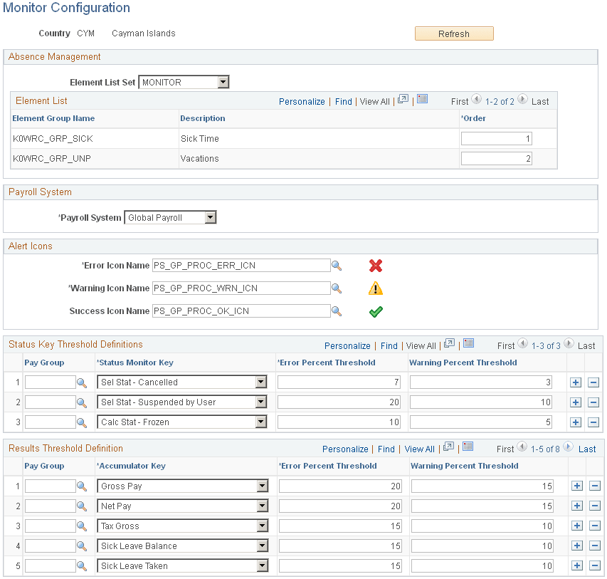

Monitor Configuration Page
Use the Monitor Configuration page (GP_CS_INSTALL) to configure the Processing Monitor.
Navigation:
Set Up HCM, and then Product Related, and then Global Payroll & Absence Mgmt, and then System Settings, and then Monitor Configuration
This example illustrates the fields and controls on the Monitor Configuration page.
Field or Control Description
Refresh
Whenever you make a change to the list set selected in the Element List Set field or to any of the element groups it includes, you must click the Refresh button on this page to update the Monitor Configuration page. When you click this button, the system removes any obsolete values from both the Element List and Results Threshold Definition grids and refreshes the page. In addition, it resets the sort order of the Element List grid.
If you install a new language for your system after setting up the processing monitor configuration, you must access the Monitor Configuration page and click Save to make the configuration apply to the new language.
Absence Management
Element List Set
Select the element list set that determines which absence accumulators are displayed in the Summary portion of the Processing Monitor for absence calculations. The system displays the element groups associated with the element list set in the Element List grid.
This field is not required. If you leave it blank, the Summary portion of Processing Monitor doesn’t display any absence information.
Note: The element list set that you select must contain no more than four element groups. If you select an element list that contains more than four element groups, you will receive an error.
Element Group Name
Lists the name of each element group associated with the selected element list set.
Description
Lists the description of each element group associated with the selected element list set. These descriptions appear on the tabs in the Summary portion of the Processing Monitor for absence calculations.
Order
Enter a number for each element group. This determines the order in which the tabs appear in the Summary portion of the Processing Monitor for absence calculations.
Payroll System and Retro Definitions
Payroll System
Select which type of payroll system you are using. Values are:
  • Global Payroll: Select if PeopleSoft Global Payroll is your payroll system.
  • Other: Select if you use a payroll system other than PeopleSoft Global Payroll.
    Note: If you select Other, you will not be able to view gross and net pay calculation results using the Processing Monitor.
Alert Icons
Error Icon Name
Enter the name of the icon that the system displays in the Alerts Icon columns of the Processing Monitor when an error is generated. By default this field is populated with the delivered error icon, PS_GP_PROC_ERR_ICN.
Warning Icon Name
Enter the name of the icon that the system displays in the Alerts Icon columns of the Processing Monitor when a warning is generated. By default this field is populated with the delivered warning icon, PS_GP_PROC_WRN_ICN.
Success Icon Name
Enter the name of the icon that the system displays in the Alerts Icon columns of the Processing Monitor for successful payroll or absence calculations. By default this field is populated with the delivered success icon, PS_GP_PROC_OK_ICN.
Status Key Threshold Definitions
Use this grid to define the thresholds that trigger the system to display errors and warnings in the Counts sections of the Processing Monitor.
Pay Group
Define the pay group to which the status key threshold definition applies. If you leave this field blank, the status key threshold definition applies to all pay groups.
Status Monitor Key
Select the type of status to which the threshold definition applies.
Error Percent Threshold
Enter a percentage. When the percentage of calculations with the status defined in the Status Monitor Key field is equal to or greater than the number you enter in this field, the system displays the Error icon in the Alert column for that status in the Counts portion of the Processing Monitor.
Warning Percent Threshold
Enter a percentage. When the percentage of calculations with the status defined in the Status Monitor Key field is equal to or greater than the number you enter in this field, the system displays the Warning icon in the Alert column for that status in the Counts portion of the Processing Monitor.
Results Threshold Definitions
Use this grid to define the thresholds that trigger the system to display errors and warnings in the Summary section of the Processing Monitor.
Pay Group
Define the pay group to which the results threshold definition applies. If you leave this field blank, the results threshold definition applies to all pay groups.
Accumulator Key
Select the accumulator to which the threshold definition applies. The valid values are Gross Pay, Net Pay, and the accumulators associated with the value you selected in the Element List Set field.
Enter a percentage. For the accumulator defined in the Accumulator Key field, when the value of the Percent Difference column in the Summary portion of the Processing Monitor is equal to or greater than the number you enter in this field, the system displays the Error icon in the Alerts Icon column.
Enter a percentage. For the accumulator defined in the Accumulator Key field, when the value of the Percent Difference column in the Summary portion of the Processing Monitor is equal to or greater than the number you enter in this field, but less than the number in the Error Percent Threshold field, the system displays the Warning icon in the Alerts Icon column.
