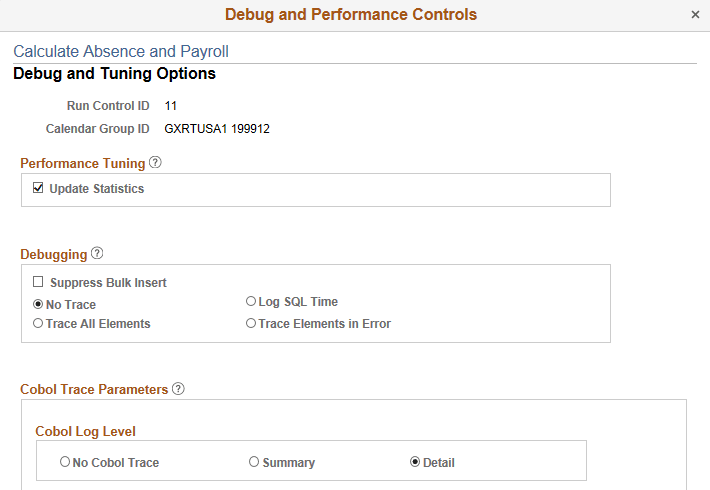

Updating Processing Monitor Data
The system updates the data presented in the Processing Monitor during absence and payroll calculation batch processing. You can disable the portion of the batch process that updates the Processing Monitor by deselecting the Update Processing Monitor check box on the Debug and Tuning Options page.
This is an example of the Debug and Tuning Options page.
You can also update Processing Monitor data for a specific calendar group using the Update Processing Monitor Data page.

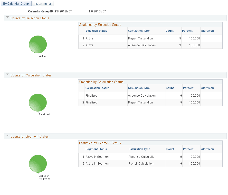

Counts by Selection Status
This section of the page includes a Statistics by Selection Status grid that presents processing statistics organized by Selection Status and Calculation Type. For each combination of selection status and calculation type that exists, the grid displays a row that includes a Count, a Percent, and an Alert if applicable.
To the left of the Statistics by Selection Status grid, the Counts by Selection Status section includes a pie chart that provides a graphical representation of the processing statistics presented in the grid.
Counts by Calculation Status
This section of the page includes a Statistics by Calculation Status grid that presents processing statistics organized by Calculation Status and Calculation Type. For each combination of calculation status and calculation type that exists, the grid displays a row that includes a Count, a Percent, and an Alert if applicable.
To the left of the Statistics by Calculation Status grid, the Counts by Calculation Status section includes a pie chart that provides a graphical representation of the processing statistics presented in the grid.
Counts by Segment Status
This section of the page includes a Statistics by Segment Status grid that presents processing statistics organized by Segment Status and Calculation Type. For each combination of segment status and calculation type that exists, the grid displays a row that includes a Count, a Percent, and an Alert if applicable.

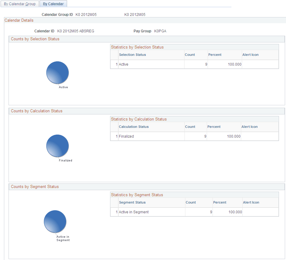

Processing Monitor - By Calendar Page
Use the Processing Monitor - By Calendar page (GP_CS_STAT2) to view detailed processing statistics for calendars.
Navigation:
Global Payroll & Absence Mgmt, and then Absence and Payroll Processing, and then Review Absence/Payroll Info, and then Processing Monitor, and then By Calendar
This example illustrates the fields and controls on the Processing Monitor - By Calendar (1 of 2).
This example illustrates the fields and controls on the Processing Monitor - By Calendar (2 of 2).
The fields on this page are identical to those on the Processing Monitor - By Calendar Group Page.
