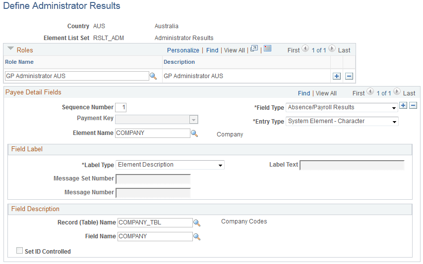

Define Administrator Results Page
Use the Define Administrator Results page (GP_RSLT_ADM_SETUP) to set up country options and link a list set to a PeopleSoft role for the Payee Detail group box on the Summary page.
Navigation:
Set Up HCM, and then Product Related, and then Global Payroll & Absence Mgmt, and then System Settings, and then Define Administrator Results
This example illustrates the fields and controls on the Define Administrator Results page.
Roles
Enter the roles that you want associated with the list set.
See “Setting Up Roles” in PeopleTools: Security Administration product documentation.
Payee Detail Fields
Field or Control Description
Field Type
Enter the field type for the value you want displayed in the Payee Details topic of the Summary page. Valid values are Payment Key and Absence/Payroll Results.
Payment Key
If Payment Key is selected for the Field Type enter payment key number you want displayed.
Entry Type
If Absence/Payroll Results is selected for the Field Type enter the entry type. Valid values are System Element – Character and Variable – Character.
Element Name
If Absence/Payroll Results is selected for the Field Type enter the element name for the entry type selected.
Field Label
Label Type
Select a label for the Field Type selected. Different fields will be able to be edited based on the Label Type selected.
If the Field Type is Payment Key, the valid values are Message Catalog or Text.
If the Field Type is Absence/Payroll Results, the valid values are Element Description, Element Name, Message Catalog, or Text.
Label Text
If the Label Type selected is Text enter the text you want to use for the label. This will display on the Summary page – Payee Details group box.
Message Set Number
If the Label Type selected is Message Catalog select the message set number to be displayed on the Summary page – Payee Details group box.
Message Number
If the Label Type selected is Message Catalog select the message number to be displayed on the Summary page – Payee Details group box.
Field Description
The fields in this section are used to retrieve the description of a field from the record indicated.
Record (Table) Name
Enter the name of the record to retrieve a field description from if you want the field description on the Summary page – Payee Details group box.
Only tables with at least one character key are available for selection.
Field Name
Enter the field name which has the description that you want displayed on the Summary page – Payee Details group box.
For the system to resolve an element description successfully, the selected record may contain only EMPLID, EFFDT, or SETID as keys plus one additional key. If the record contains an additional key other than EMPLID, EFFDT, or SETID, this field must be specified in the Field Name field.
Set ID Controlled
If the record selected is controlled by a SetID, this field will automatically be selected.
